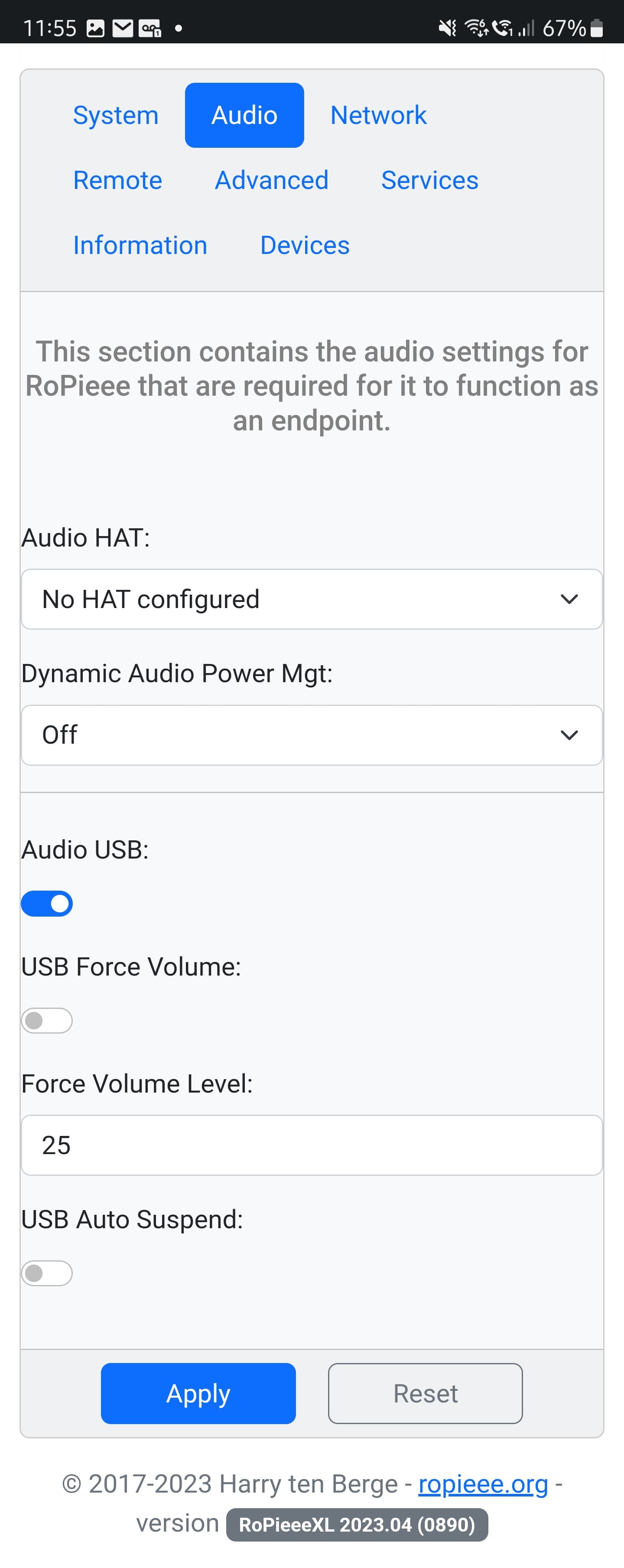

Usb audio is set in the settings.

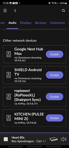

From the below photo you can see its visible as the shairport option shows but no roon ready.

Forget about Shairport. Shairport shows up, no matter if there’s no real audio device.
That works differently for Roon: no audio device, no show in Roon.
I appreciate that but the reason I said that option was showing up was just evidence to show it had a network connection.
