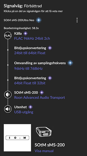

Thank you for your post. Around the timestamp you shared, the SOtM sMS-200Ultra Neo Zone is upsampling the 44.1KHz FLAC file to 705600Hz. It’s also performing this upsampling when grouped. There’s a severe server-side resync delay.

And finally the signal path to the SOtM:

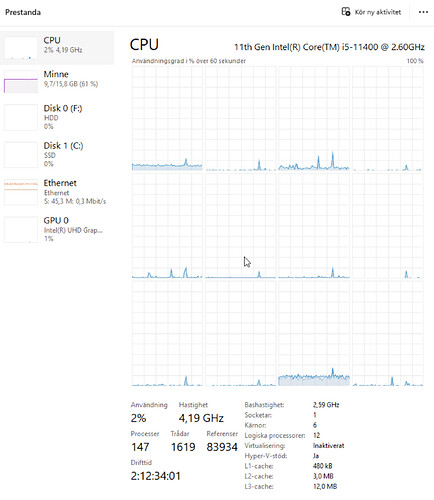

Server idling away:
