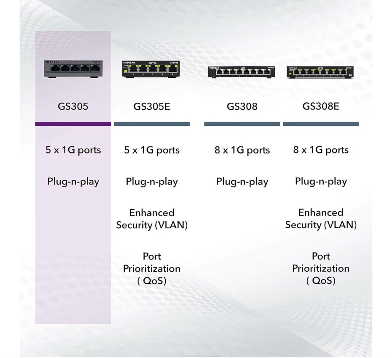

Ideally on a network like yours you need dumb switches like the Netgear gs305 and gs308. These have zero QoS. Links below. I’d try these and they’re cheap. If they don’t fix the issue, return them to Amazon.
Edit: I stand corrected. These have QoS but in its simplest form. They are of the same spec as the TP-Link in the OP.

I checked the data sheet for Netgear GS308: https://www.downloads.netgear.com/files/GDC/GS316v3/Gigabit_Unmanaged_Essentials_Switch_DS.pdf
The parts where QoS is mentioned in the document:
• IEEE 802.1p Priority QoS (all models)
• IEEE 802.1p Priority QoS and DSCP
802.1p QoS for traffic/frame prioritization
I didn’t see any reference to IGMP.
To Roon staff: Which network switches do you recommend? I’d love to know the specific models either in 8 port or 16 ports. Thanks!
mine is an 8 port TP link, I also have a 5 port equivalent that runs VoIP and the ROCK back to the router. Cheap simple and running at least 8 yrs (I had to look up receipt Sept 2017)
Well that’s pickled my brain. The Netgear info I found said they don’t.
The above and (now missing) data sheet stated otherwise. I believe I found the info for the older ones before v3 :man_shrugging::man_facepalming:
