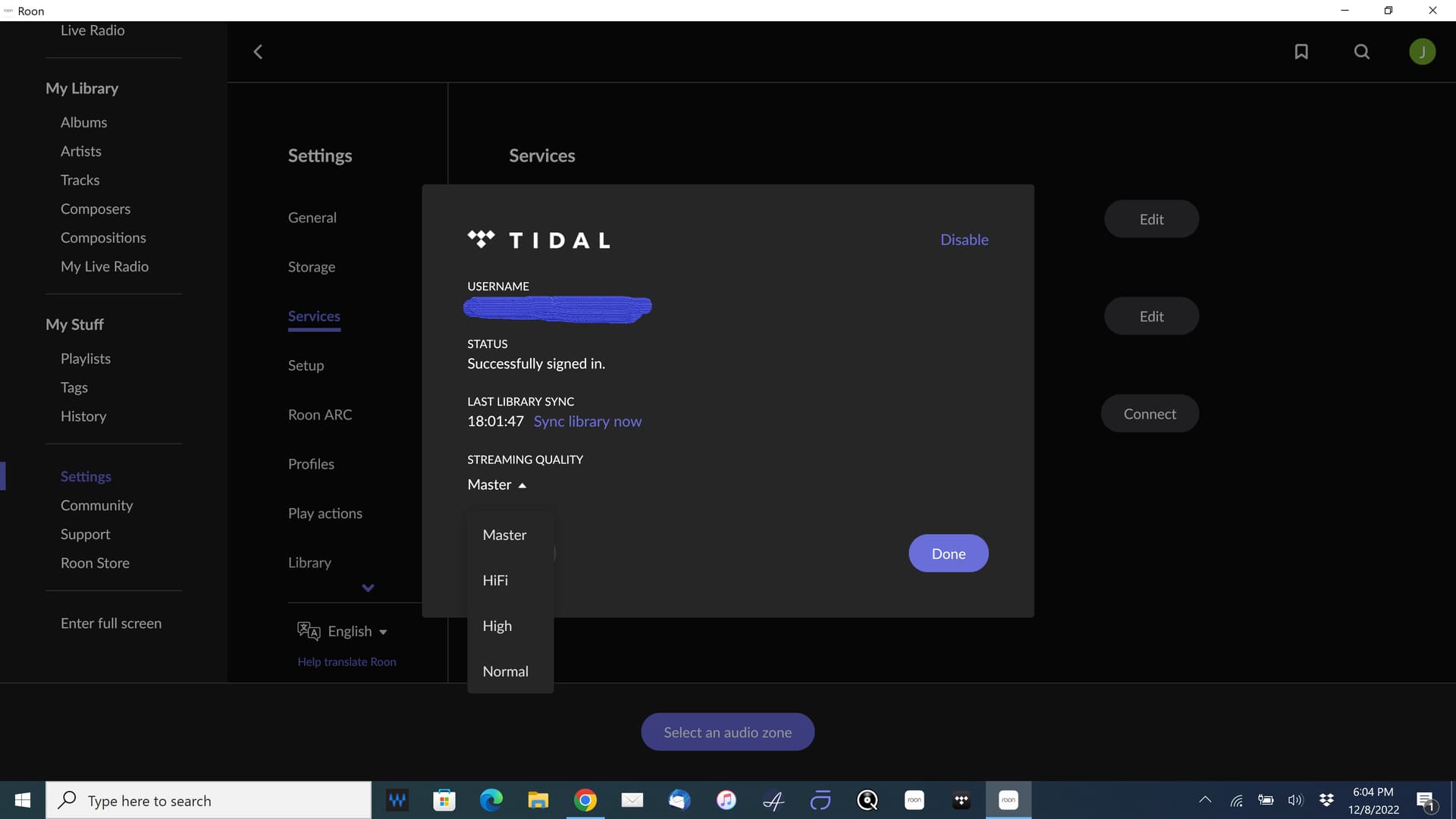

Also, check this setting…
Very good point, AR. I was only subscribed to HiFi, and I see I need HiFi Plus for MQA. But, I decided to stick w/ HiFi, as my DAC does not support MQA, and supports PCM to 24/192. So, no need for HiFi Plus. Thank you for your response.
Thank you for your post, Jim. I checked this setting on my account, and it was indeed set to “Master”. But, I decided to not pursue MQA, as my DAC does not support MQA, and supports PCM to 24/192. Thank you for your response.
