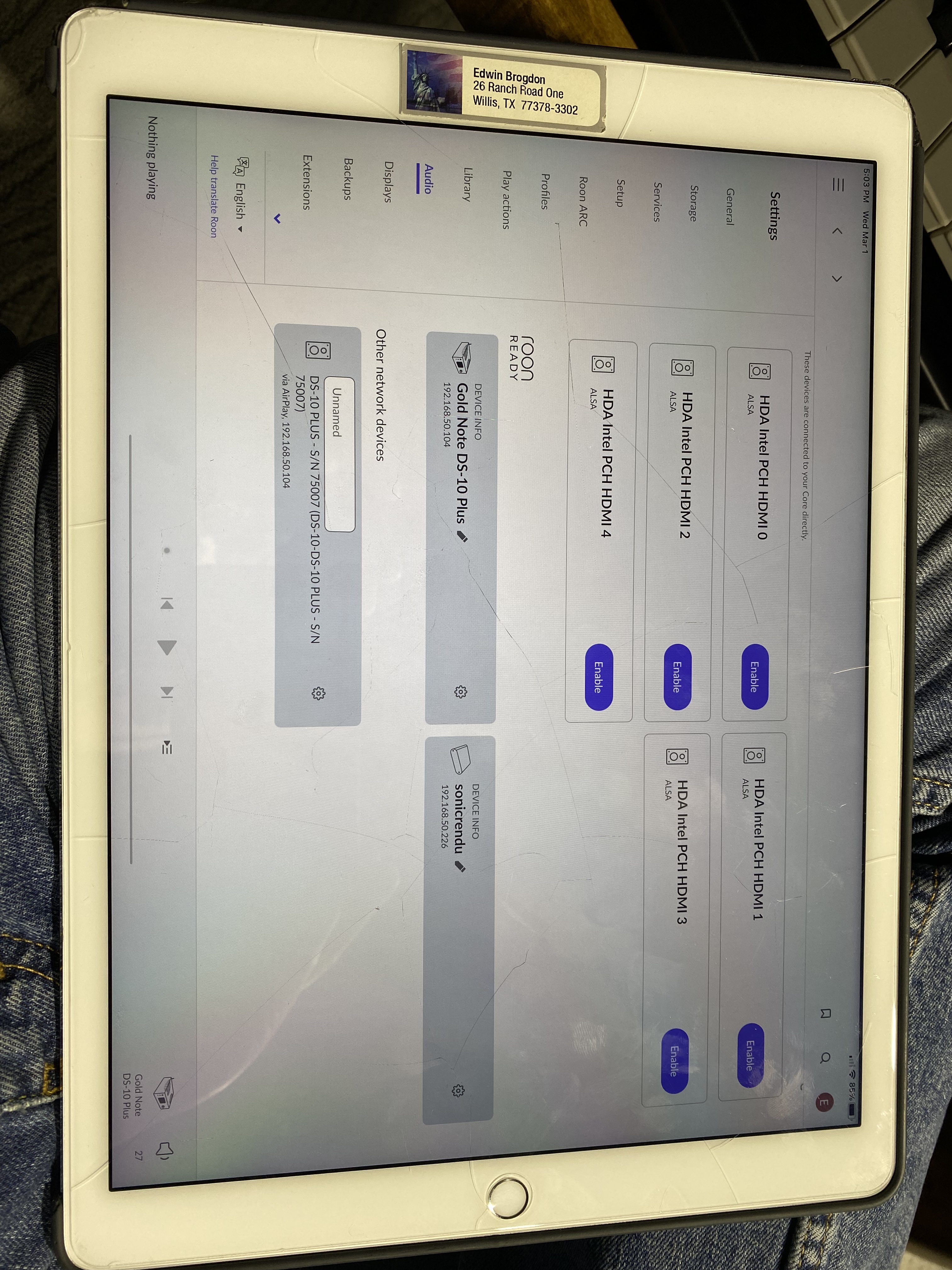

I enabled the DC-10 in the Roon ready section of the Roon software using my iPad. When I switch from the Rendu from zone 1 to the DC-10 in zone 2, the play button lightens up & no longer functions.
I will attach a pic & hope that helps

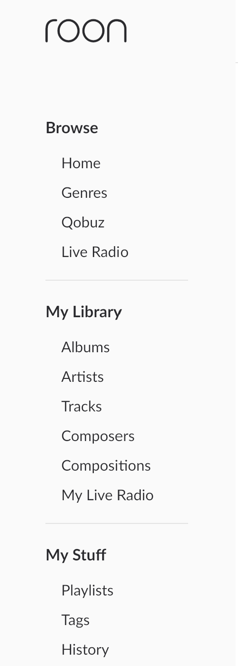

This might be a dumb suggestion, but since it says “Nothing playing” it seems you should back out of settings and then select something to play from the main menu, as in my screenshot…
Hey @Edwin_Brogdon,
Following up on this thread, are you still running into issues with your play button?
If so, can you please confirm that this issue only happens on the iPad? If so, we’ll need to grab a set of manual Roon logs from the device. Please use the directions found here and send over a set of logs to our File Uploader.
I’ll be on standby for your reply. :+1:
