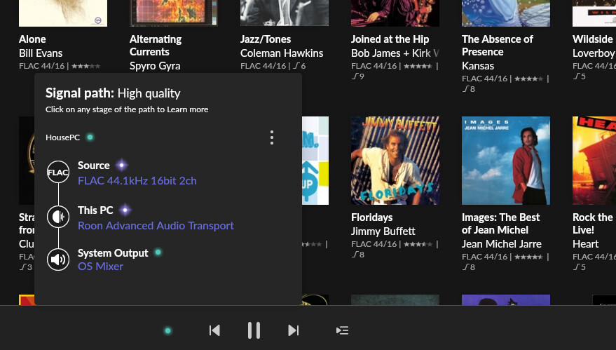

When this happens what is the processing speed being shown?
Thank you! How do I find out?
On your now playing screen next to the transport controls to the left there will be a little coloured dot (colour depends on resolution/quality).
Click on the dot and it will show you the signal path with the processing speed near the top in the form of for example 6.5x.
Anything above 1.3x should be fine, if nothing shown then it means it is over 99x and absolutely no concern ever…lol.
As per my screenshot, no processing speed shown.
Thank you!
