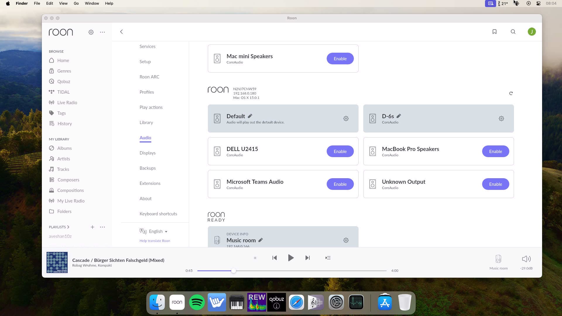

Also - see screenshot below - my Roon Server ‘sees’ my Macbook in its Audio Settings:

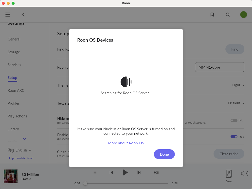

& yet my Macbook cannot find my Roon Server, as the Find Roon OS process never gets past this point:
