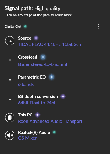

There’s a second Realtek device available (I believe it’s the digital out) and it does allow playback. The signal path for this is shown in the attached screenshot, and it’s set up to be the same as the path for all other zones.

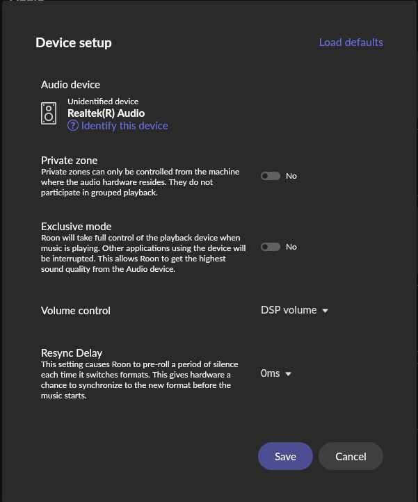

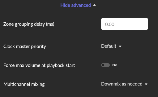

Here are the screenshots for the audio setup on the Realtek device. Out of all of the devices connected, only the Digital Out offers sample rate and bit depth conversion.

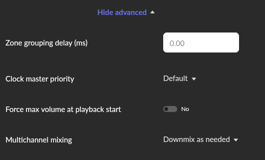

I checked the article, and it cannot apply for my issue due to the fact that none of my devices have the option to change the multichannel setup - they all have the same options in the ‘Advanced Options’ menu, as shown.
