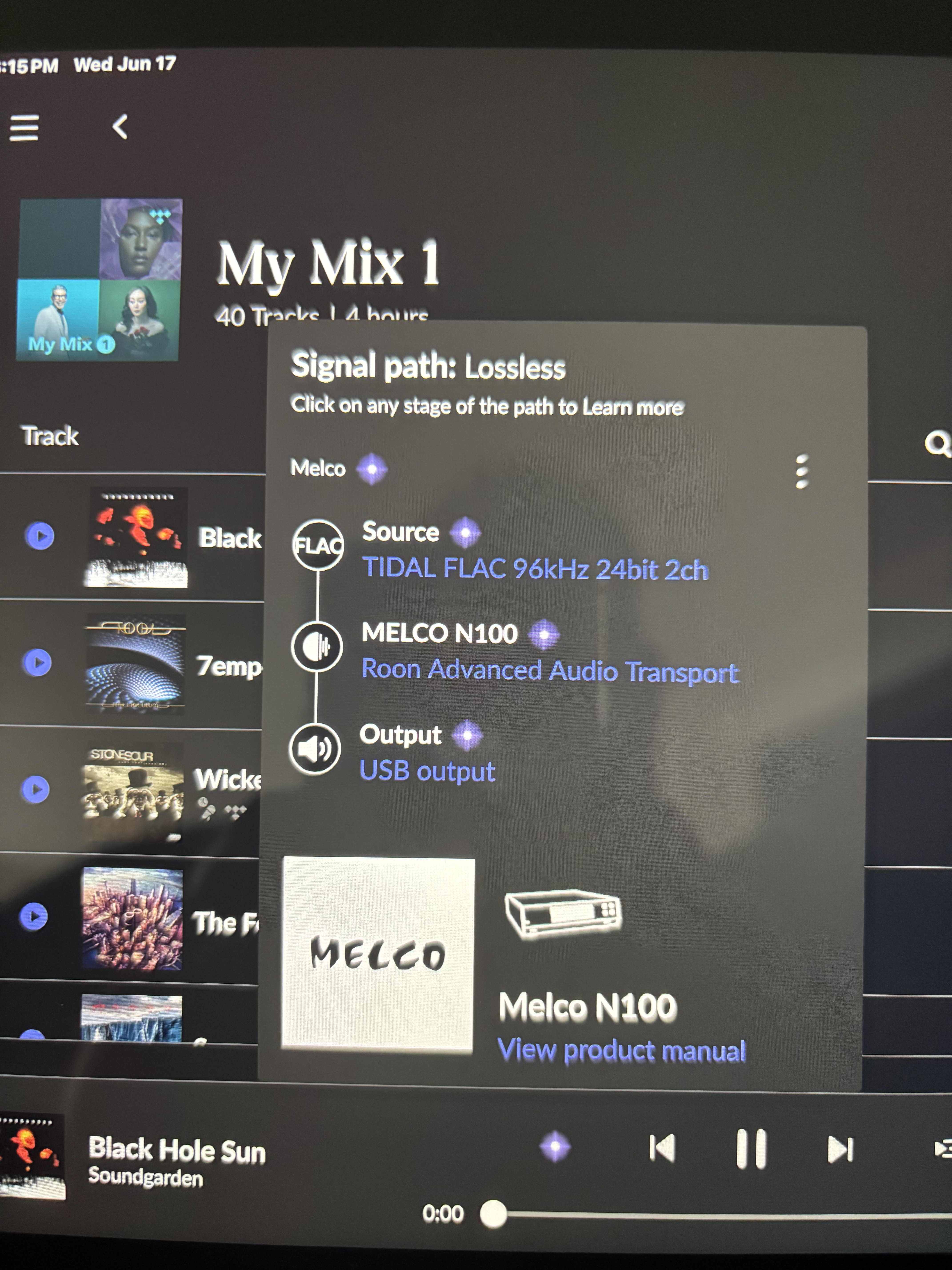

  1. When the issue is happening, open the Signal Path for the affected zone and let us know what it shows right before playback fails. If there’s any format conversion or DSP in use, that will be useful to see.

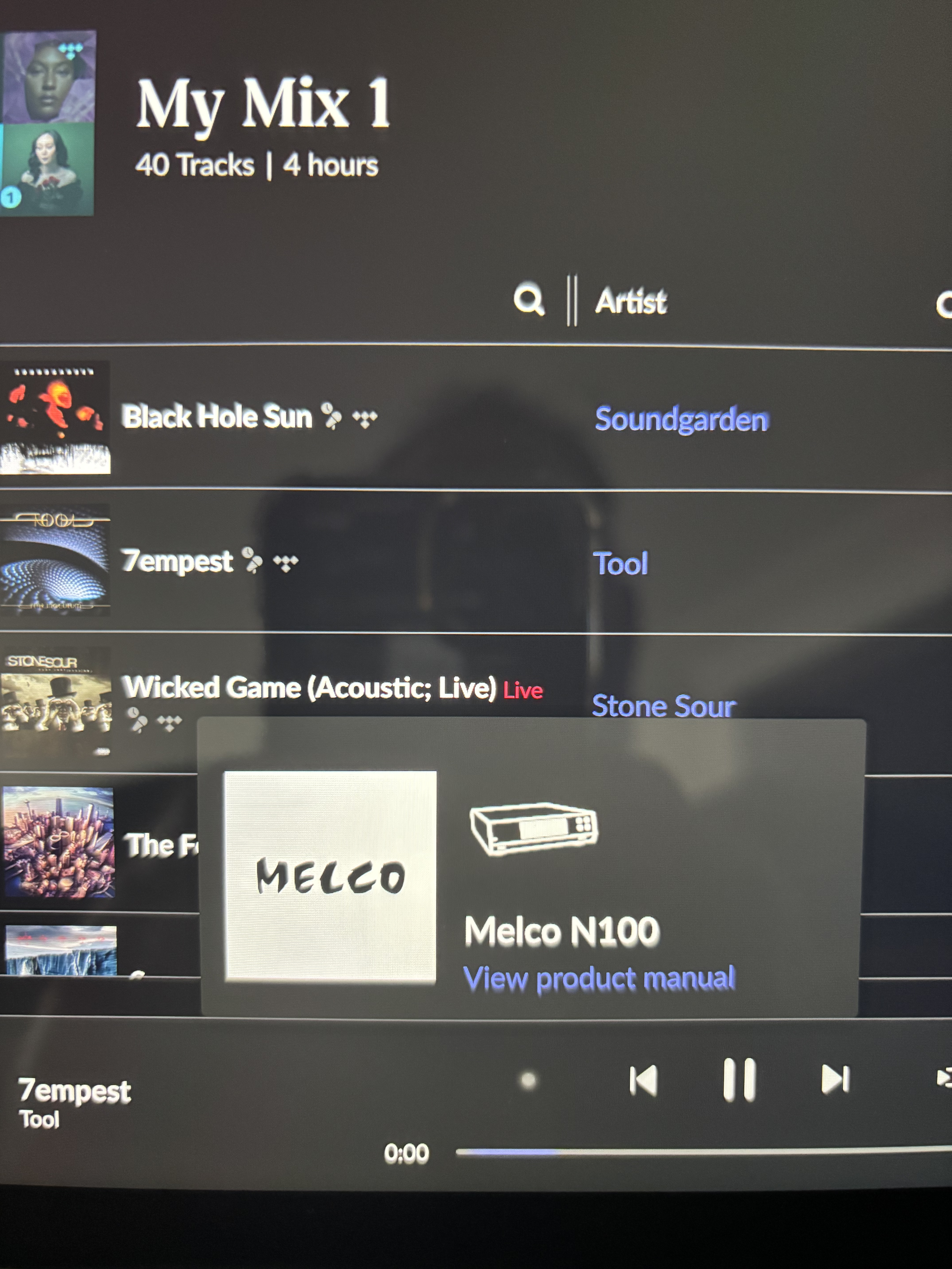

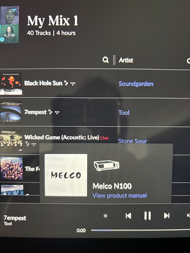

Hi everyone,
Please see below photos I took now.
There is a BELL Fibre Wi-Fi modem / router that I have a POD connected to via wi-fi. From the POD I run an ethernet cable to the MELCO S100. The NUC / N100 are connected to the S100. The NUC sends the TIDAL stream to the N100 VIA USB which sends it to the MUTEC via USB and finally the Border Patrol DAC via coaxial. I don’t have any power saving feature that I’m aware of. The NUC doesn’t have any speakers. I just turned the Border Patrol off and back on and the problem did not resolve.
Thank you
