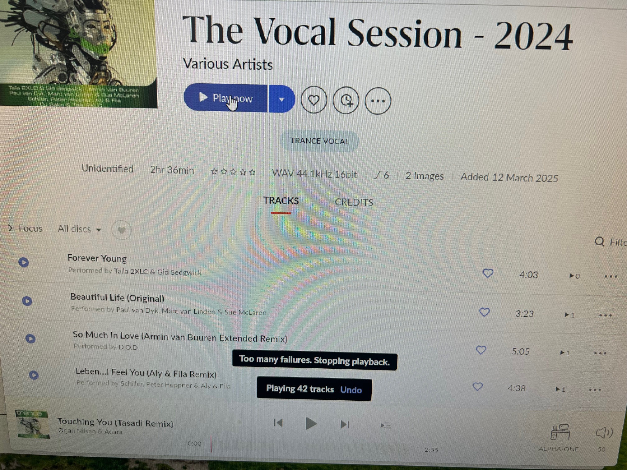

Playback failure on local PC with 'too many failures' error (ref#SPATXO)
· *Only local library *music is affected.
Where is your local content stored?
· Somewhere else on the local network (NAS)
If you move the content from your NAS to a local storage location, do you still experience issues with playback?
· The issue only happens when the content is on the main NAS storage location
Please try playing content of a lower sample rate (44.1kHz or 48kHz), does this work as expected?
· No, lower sample rates are still affected
· 28/06/2025 11:47
· Audio speaker (AORUS X590 Elite - Realtek), Digital Audio Asus Xonar Essence STX, Output Logitech Z906
Press play = 'Playing 1 track' but nothing playing, Press play album = 'too many failures'. this happens with whatever output audio device of local PC is chosen - speaker, Xonar etc.
Unifi network with NAS - all working fine.

Dear Daniel,
Thank you for the assistance.
Following the proposed steps does not work.
Same issue: “too many failures. Stopping playback.”
Output devices work fine with other software.
Interested to learn what could be the next step ?
Best,
Johan
