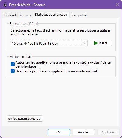

I don’t think it’s a problem of format as those albums played fine before.
Here are my untouched headphones settings:
Playback works fine on any other device. It’s only from the two used with Roon Bridge.
Is there any way to reset device settings?
Hi @Maryline_Lantonnet, thanks for the clarification and the screenshots.
To rule out any interaction with the Roon Bridge setup, could you please try the following:

  1. On your Windows PC, could you please confirm whether Exclusive Mode is enabled or disabled for the affected devices?
  • Roon Settings → Audio → device settings
  • Please let us know:
    • What Default Format is selected
    • Whether “Allow applications to take exclusive control” is checked
Even if these formats worked previously, the error we’re seeing indicates that Windows is currently refusing to open the device at 44.1 kHz when Roon requests it, which usually points to an OS-level audio configuration or device lock rather than a library or Bridge-related issue.

The 1st step was already done, but I rebooted my Linux laptop just to ensure I did everything correctly. Disconnected everything properly and the laptop is powered off.
As for the 2nd step, both devices had exclusive mode disabled. I tried enabling it but nothing changed so I left it disabled. As for the default format, I see nothing of the sort in the device setup interface. Are you talking about “WASAPI” by any chance?
After writing this, I tried setting back to default the device settings, and now both the speakers and the “System Output” work fine. What’s super strange though is that my headphones work fine on the System Output if they’re the default audio device, but their specific device in Roon still doesn’t work.
I have no reason to use the devices separately instead of the System Output (apart for troubleshooting), so I guess my problem is solved? Kinda. I’m still not sure what triggered and solved this problem.
