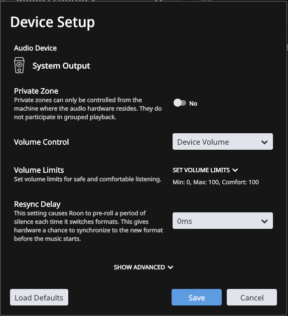

To answer your initial question: yes, I am running on Windows 10 64-Bit and the zone I’m trying to playback with is the System Output zone:
The only thing I can think of at this point is that possibly my Ubiquiti Security Gateway is preventing packets from moving between the Core and the Computer. It’s odd that every other Roon Endpoint in my system is working fine, however, including mobile devices (I have a Samsung Galaxy Note 10 and an iPad Pro).
Any other suggestions before I start deep diving into my router/firewall??
