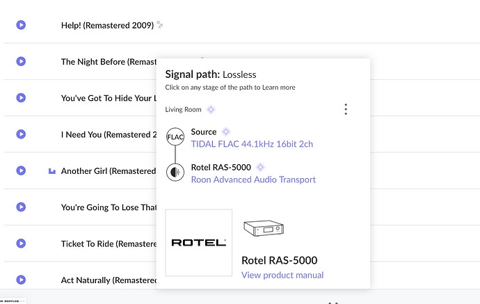

I just tried again now. 12/17/2026 12:37 - 12:38 PM ET. Roon sends the song title and the album artwork but no audio data. The same Roon core works fine for NAD “zone” but fails for Rotel.

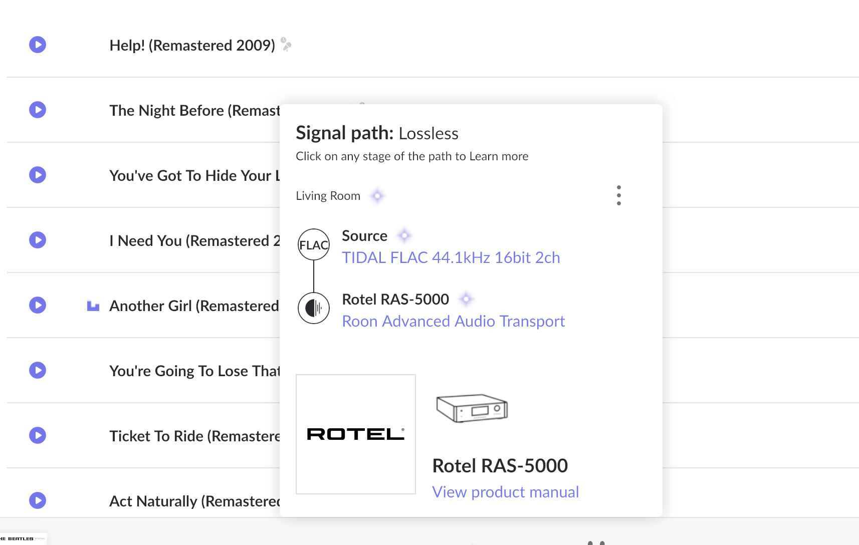

Here is what the signal path looks like. 2/17/2026 10:58 PM ET. No sound.

Yes. Roon is behaving normally with the ethernet cable connection.
The bad behavior returns as soon as I go back to WiFi. The song title and artwork displays but no sound. Also no “Speaker” node displayed on the signal path diagram. (I have not seen the explicit “Too many failures" or timeout messages for a while.)
