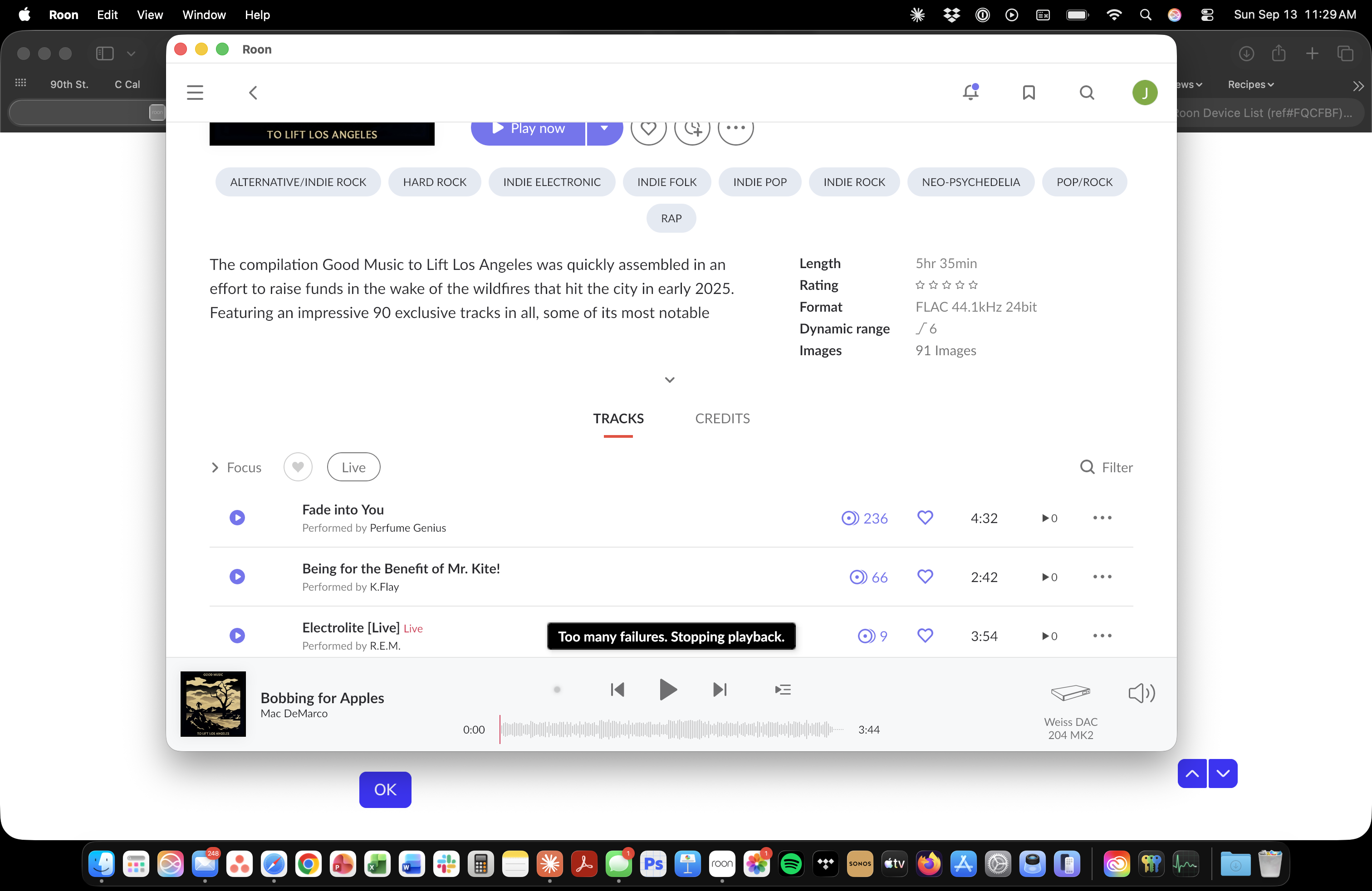

· Hello - I just purchased a Weiss DAC 204 MK2 and connected it to my Roon Nucleus + but it does not work. I keep getting an error message that says "Too many failures. Stopping playback." After my Roon software seems to flip through a bunch of songs attempting to play them. I see from forums that people have gotten their Weiss DAC 204 to work by selecting the Weiss DAC 502 from the "Identify Device" Weiss Roon Ready menu (which does not list the 204) but that does not seem to work either. Please advise. Thank you.

I have a brand new Weiss DAC 204 MK2 that is not working with my Nucleus+ The device is connected, seen, enabled, but music playback results in an error message that says: Too many failures. Stopping playback. This appears after the software seems to quickly try to play/skips through about 3 songs.

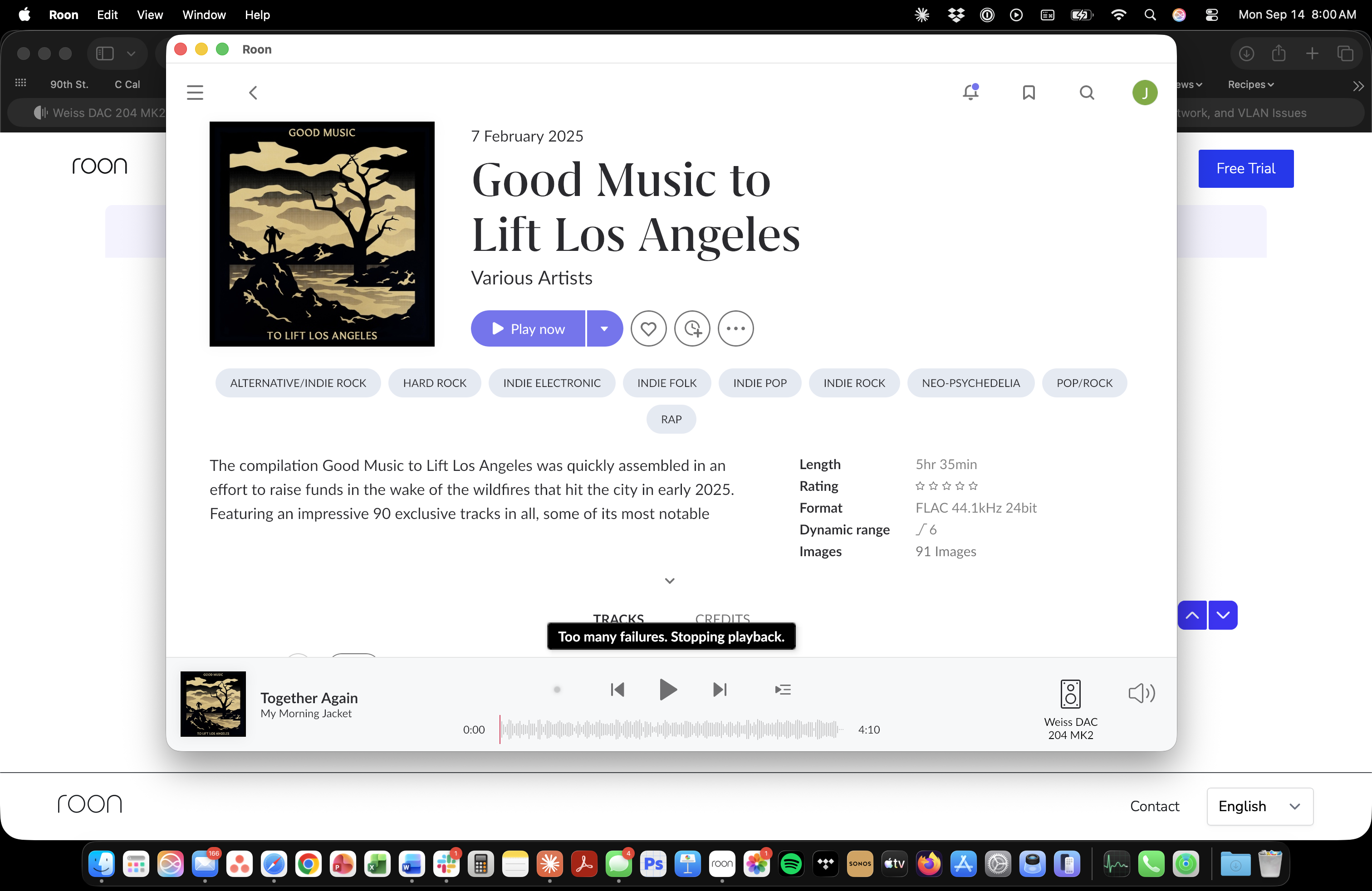

Hi Vadim, Thank you for your response. I have tried the new cord, and different USB port. Can you check the logs and see if you are still seeing the same problem?
Hi @vadim -
The issue does not seem to be the DAC. It works just fine using Roon from my MacBook Pro, connected directly via USB with the DAC selected as the sound output.

Yes, we are seeing the same issue with Format Not Supported in your latest diagnostics. It is rare, but it is possible that the DAC does not have compatibility with Linux.
Just to clarify, the DAC works from the Roon app when connected to the Mac, or was it through another application?
Are you using the latest firmware available for the DAC?
Hi Noris,
The DAC works from the Roon app when connected to the Mac.
I am using the latest firmware for the DAC.
I have also been in touch with Weiss, the manufacturer, and they have confirmed that the DAC works with Roon Nucleus+ and Linux.

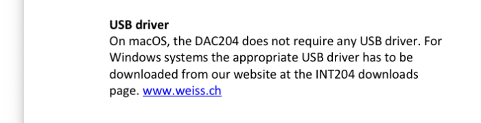

Is it possible there is a problem with the USB port on the Nucleus (I have tried both)? Or could there be a problem in the Roon software? Are there specific settings I should be using in the Roon software for the DAC to work?
FWIW, the manual says:
but nothing about Linux.

We pulled a fresh set of logs from your Nucleus and can now see what is going wrong. We said the DAC advertises a format and then refuses it. That was wrong, which is why Weiss were able to tell you the device was fine. The audio interface opens at the format Roon asks for and then falls over for a different reason.
What actually happens is that the DAC does not answer the Nucleus in time. From the operating system:
usb 1-5: 1:1: cannot set freq 44100 (v2/v3): err -110
usb 1-5: 1:1: cannot set freq 96000 (v2/v3): err -110
usb 1-5: uac_clock_source_is_valid(): cannot get clock validity for id 41
usb 1-5: clock source 41 is not valid, cannot use
Error 110 is a timeout. The Nucleus asks the DAC to set its sample rate, a standard USB Audio request, and the DAC does not reply within the time allowed. Everything after that follows from it, including the “Too many failures” message you see in Roon. The same pattern appears even at the moment the DAC is plugged in, before any music is involved: several of its volume controls also fail to answer.
This is why it works on your MacBook. macOS is more tolerant of a device that answers slowly. It is also why changing cables and USB ports made no difference, and we should not have had you doing that.
