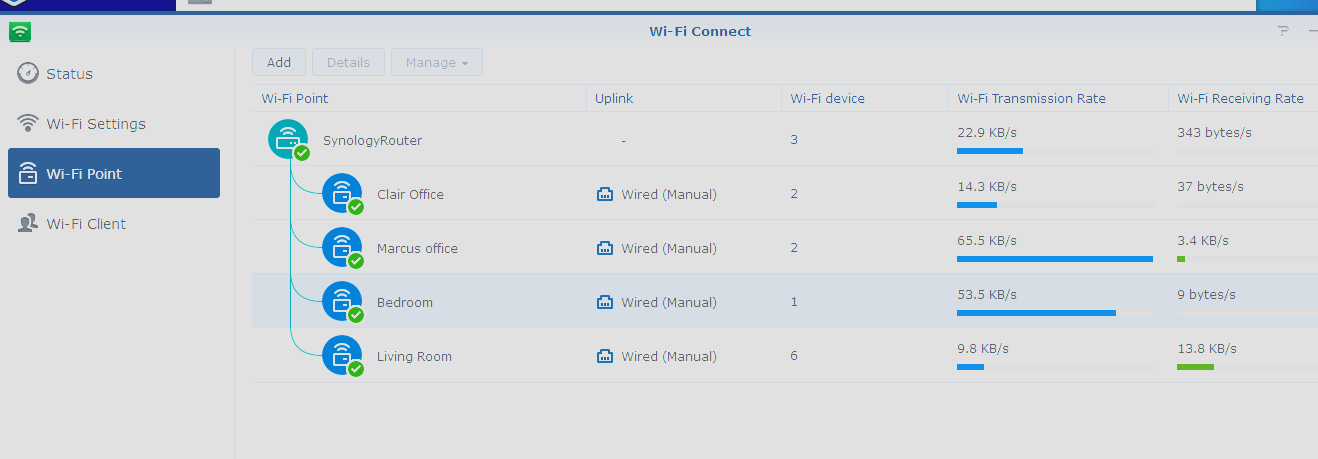

I have a synology mesh system with an RT6600AX router as the primary in the basement. An RT6600AX as a secondary access point in the living room, an RT2600AC in my office a WRX560 on the first floow and an MR22ooAC on the 2nd floor. They are all wired in via ethernet. the MR2200AC and WRX560 are wired into the RT6600AX via an unmanaged switch.

This morning I took out another router which was operating as a mesh access point so we’re only running the two rt6600ax and the one wrx560. These are all the newer models so maybe that in combination with less access points will reduce the interference.
I also managed to end up with two Internet connections via two isp’s. The first one was slow so we changed but couldn’t cancel. I found out that if I used load balancing across these the roon server would sometimes disappear from the network. I just have the second wan access as failover now, which seems to work better.
