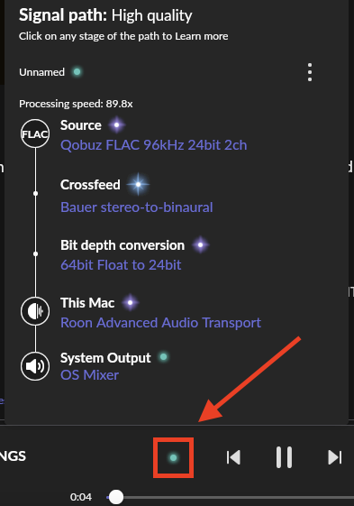

Thank you for your post. Diagnostics indicate that the Signal Path contains a sample rate conversion that is preventing Roon from transporting audio to this Zone.
Please share a screenshot of Signal Path, as well as any custom DSP you have applied in MUSE.

Here’s a screenshot of the Signal Path - all you need to do is click the small light to the left of the play commands:
