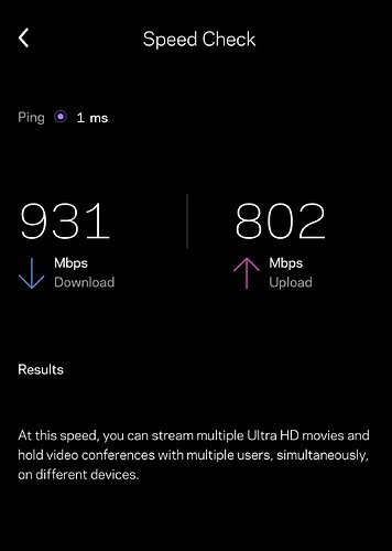

· All devices are hardwired Ethernet. I’m in community fibre full fibre internet. I have four systems feeding into Roon.

  • Treat this as a network problem at the endpoints, despite "all hardwired." What are the actual paths for the WiiM Ultra and Bluesound NODE 2i specifically? Try switching ports, cables, and whether either is silently falling back to Wi-Fi or sitting behind a powerline/MoCA adapter or an unmanaged switch that's flooding/dropping multicast (RAAT discovery is multicast-sensitive).
  • Update endpoint firmware on the WiiM Ultra and NODE 2i, if needed.
Thanks @Chris_Robinson1!
Hey @Chris_Robinson1,
Just checking in on this, and I wanted to see if you had a chance to test playback with the grouped zone broken apart. Have you been able to try Qobuz on each endpoint individually, and, while you were at it, check the WiiM Ultra and Bluesound NODE 2i for any firmware updates or network path issues like cable, port, Wi-Fi fallback, or a powerline/MoCA link? If you have any results from those tests, send them over and we’ll take it from there, thanks.
Firmware for all devices are up to date. Playback via Qobuz appears fine when using one player at a time.
I don’t see any WiFi fall back but I’m continuing to test.
