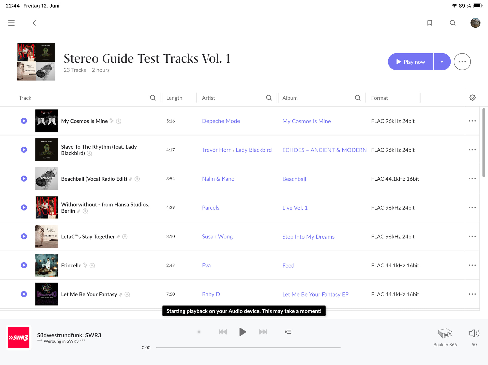

I'm having trouble playing Roon through the Nucleus server on a Boulder Amp 866. Whenever I try to play something, I get a message telling me to wait. I have to restart the Roon server software first before I can play the stream

Both connected via ethernet direct to fritzbox 5590.
Nothing elseconnected.
Hey @Andreas_Hohn, thanks for the screenshot and the network details - that helps a lot.
I’ve gone through your logs, and we have a clear picture of what’s happening.
Root cause: The Boulder 866 runs both a RAAT stack and an AirPlay (ShairportSync) stack simultaneously. When Roon receives a TTL=0 mDNS packet that expires the Boulder’s AirPlay advertisement, the amplifier sends an standby event over RAAT, which drops the active stream. Roon immediately tries to restart playback by sending a new setup command - but the Boulder’s internal audio subsystem gets stuck re-opening the audio device while it’s still finishing the teardown. It never replies to the setup, Roon waits 15 seconds, times out, and the zone is left in the broken state you’re seeing. Restarting the Roon Server clears it because it forces a fresh connection.
