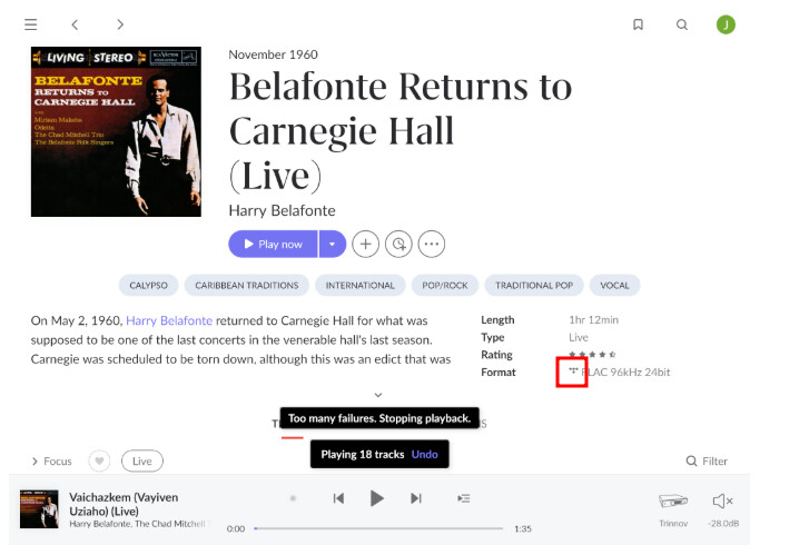

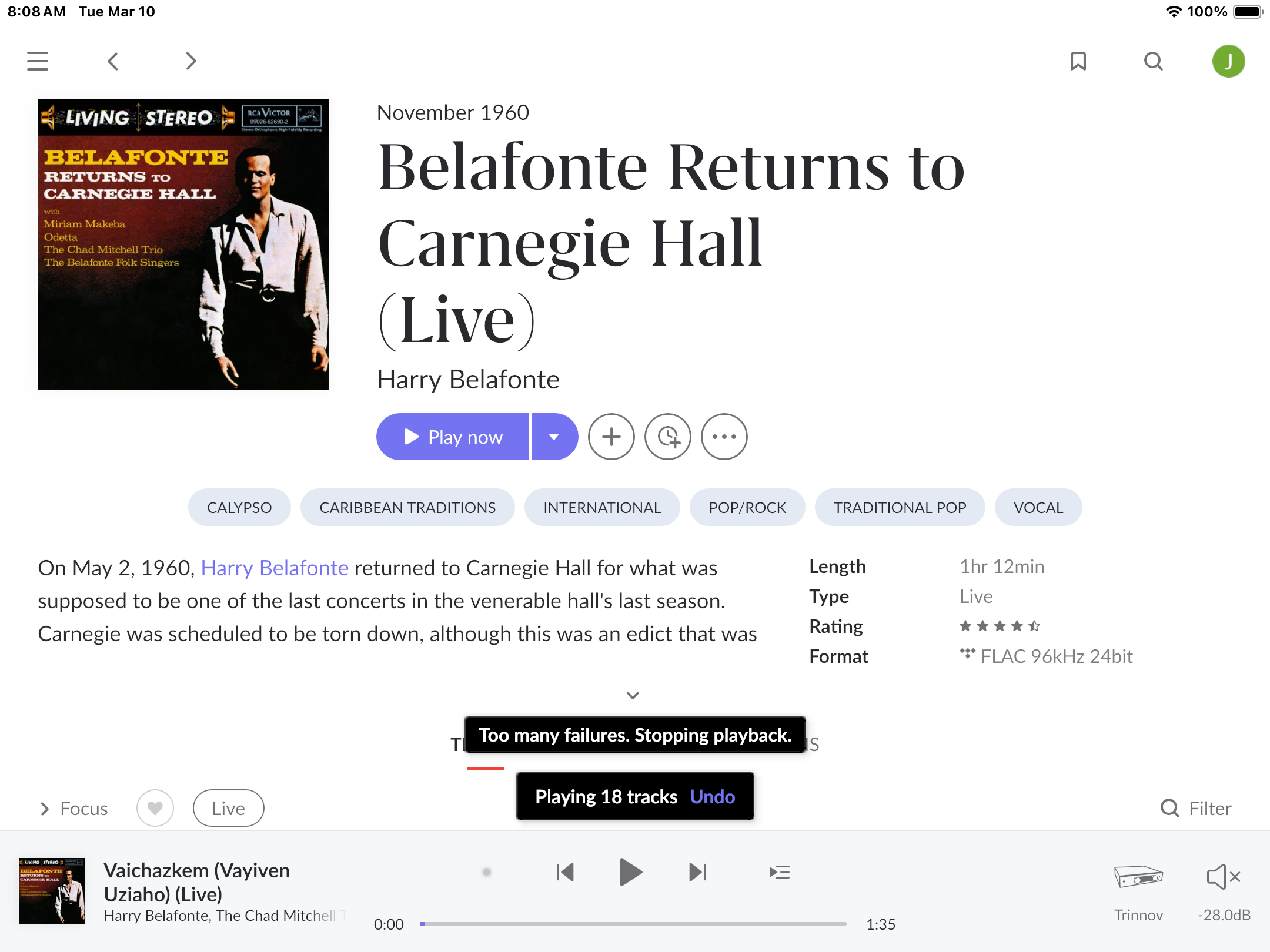

I have two issues that just occurred.
1. Albums that I load only play 29 seconds of each track
2. Some albums won't play, an error message appears "Too many failures, stopping playback"
Roon Roc using i7 NUC, Trinnov Amethyst, all connected via Ethernet

Turns out the albums that are failing are not available on Qobuz. Am I correct that this issue is also related to the Tidal account being a trial?
Thanks for your assistance.
Hello @John_Vogt,
Spot on! You are absolutely correct.
When an album is exclusively available on TIDAL and your account is on an expired trial or free tier, TIDAL’s servers actively reject Roon’s request to stream the full track. Roon quickly tries to skip to the next track in the album to keep the music going, gets rejected again, and after a few rapid-fire rejections, it stops trying and throws that exact “Too many failures, stopping playback” error.
Since both the 30-second previews and the playback failures trace directly back to the TIDAL account status, your Roon Core on the NUC and your Trinnov Amethyst are actually working perfectly!

One thing, I wish when doing a search for an album the result would show which streaming service the album is from to avoid confusion. I didn’t know that search scan both services even though I was using Qobuz.
Hello @John_Vogt
It’s marked on the album page itself.
