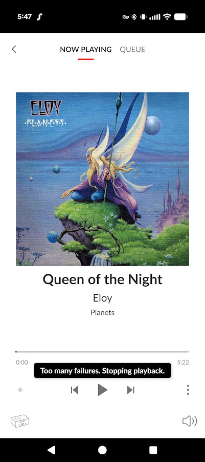

Playback keeps stopping on HifiBerry due to multiple failures (ref#MPBGJ3)
· The queue is skipping tracks
· The issue *only affects one file *format.
Which format is giving you trouble?
· FLAC
· It is connected through a different device (e.g Rasberry Pi)
· Only one output type is affected while the other output type works as expected
· now
· Hifiberry
HifiBerry - too many failures, stopping playback
Wifi
All other WIRED devices are working correctly. Firewall is off. This appears to be either because of Wifi or ANDROID app.
Previously this has worked perfectly!

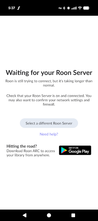

I do have an issue with Android Roon app. When I turn the UFW on, it’ cannot find the server. I have the recommend “Roon” UFW rules, and again, it’s been running fine for many years.

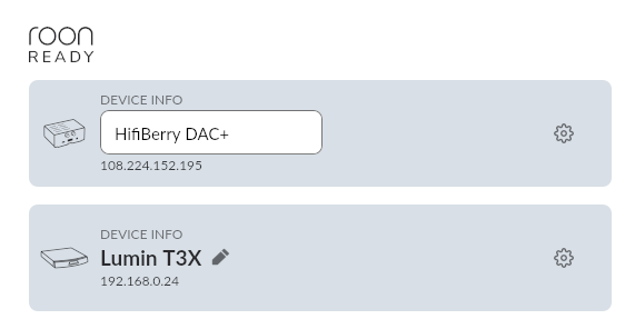

Note that wired endpoints work fine, Roon Arc works without issue. Hifiberry on wifi will play fine from wired Windows Roon app. All is with UFW enabled.
Problem is
  1. Android app cannot find server with Firewall on.
  2. Roon app on Windows cannot find server with Firewall on.
  3. Hifiberry will not playback over wifi from Android app or Windows app with firewall off.
So clearly there’s something going on with Wifi and UFW.

Thanks for the screenshots and additional information! Based on a fresh Roon Server diagnostic report, it does appear that UFW Is Blocking RAAT’s Dynamic UDP Clock Sync Ports.
Every failure looks like this:
GOT {"audio_port_tcp":35925, "clock_port":35590, ...} ← RAAT negotiates ports
failed to sync sender clock to endpointHiFiBerry DAC+ ← UDP reply is blocked
failed to sync clocks with any endpoints..giving up ← gives up, stops playback
The TCP connection succeeds (it’s initiated outbound from the server to the HiFiBerry, so UFW allows it). But the UDP clock sync reply from the HiFiBerry back to the server is blocked because those ports are random and not in your UFW rules.
Why wired endpoints work: Your wired Ropieee and Lumin T3X likely either have specific ALLOW rules, or wired traffic is on a trusted interface (e.g. ufw allow in on eth0), while WiFi traffic comes in on wlan0 or a separate interface that doesn’t have that implicit trust.
Why playback from wired Windows app to HiFiBerry over WiFi fails: The issue isn’t the control source (Windows app). It’s that the HiFiBerry itself is on WiFi and its UDP clock sync packets to the Roon Server are blocked regardless of what initiates playback.

With UFW on, roon apps on Wifi cannpt find the Roon Server.
With UFW off, roon apps on Wifi find the Roon Server, but when played to the Hifiberry “Too Many Failures. Stopping Playback” both Wifi and Wired.
