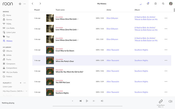

While scrolling through the playback history today, I saw the word Unavailable in small, red letters briefly appear for a few seconds above the track name and then disappear for a couple of tracks that had been affected by the problem. Later, I was quick enough to capture a screenshot (attached) of a page of the playback history when this ephemeral Unavailable label appeared briefly above every track. Does anyone know what might cause this? It certainly seems likely that it is related to the problem.

I may have isolated the problem to the USB connection between the SSD that my local “watched” music folder is on and the Mac mini that runs the Roon Server. The “Unavailable” label that briefly appeared above tracks in my Roon history led me to focus on that part of the playback chain.

Alright, it’s a wrap. The USB-A to USB-C adapter cable was definitely the culprit. In the end, nothing indicates the problem had to do with Roon itself. I guess I’ll never know why after almost every occurrence of the fault the playback position skipped to exactly the fourth next track.
