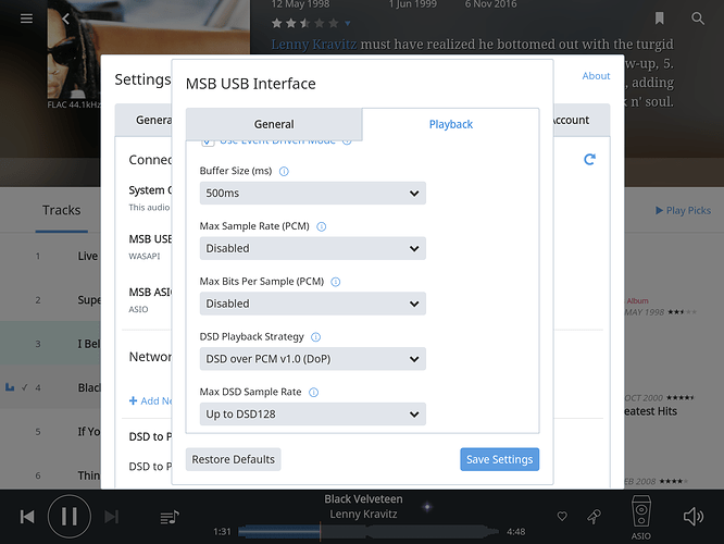

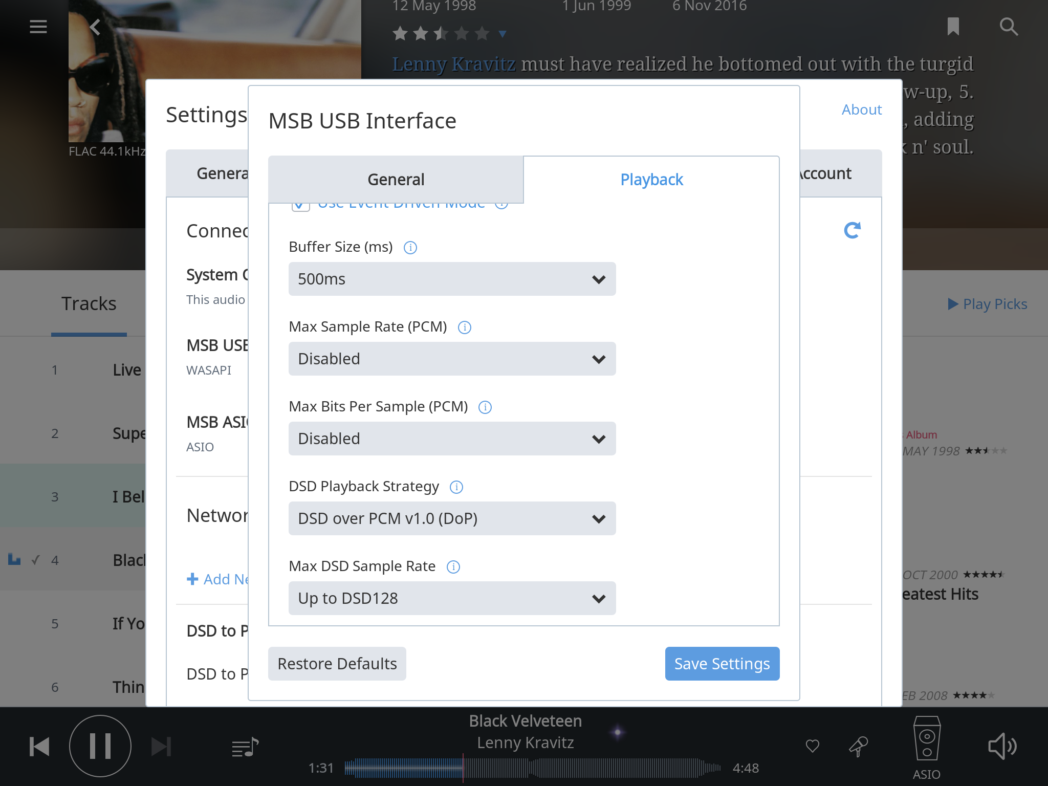

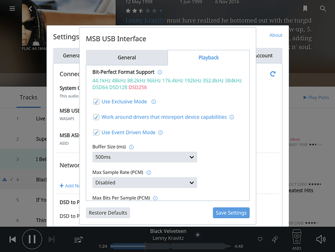

I have tried several combinations of settings but to no avail. E.g. buffer set at 500 ms and “Use exclusive mode” off.

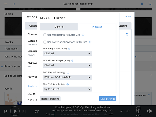

To make DSD128 work, “work around drivers that misreport device capabilities” and “Max DSD sample rate” = “up to DSD128” are necessary.
The USB384 wil not work with native DSD. DoP is required (as per design).

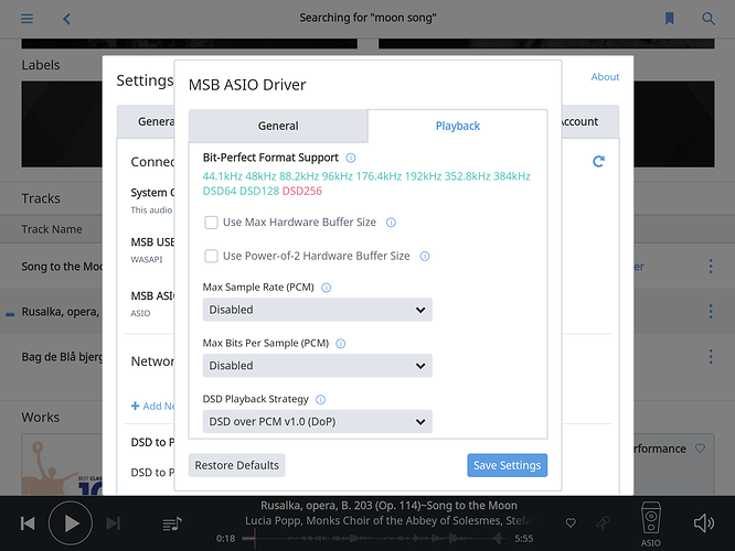

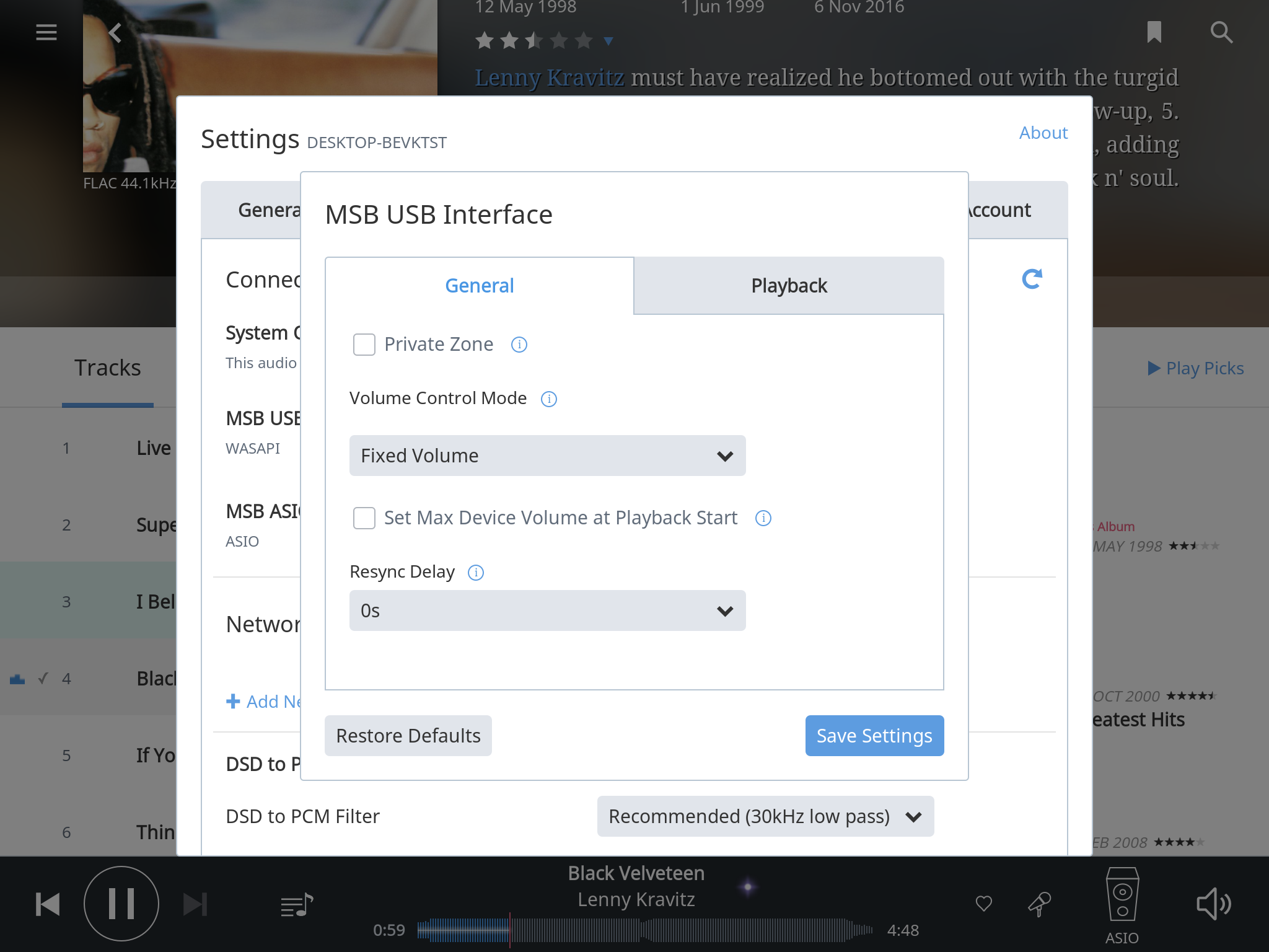

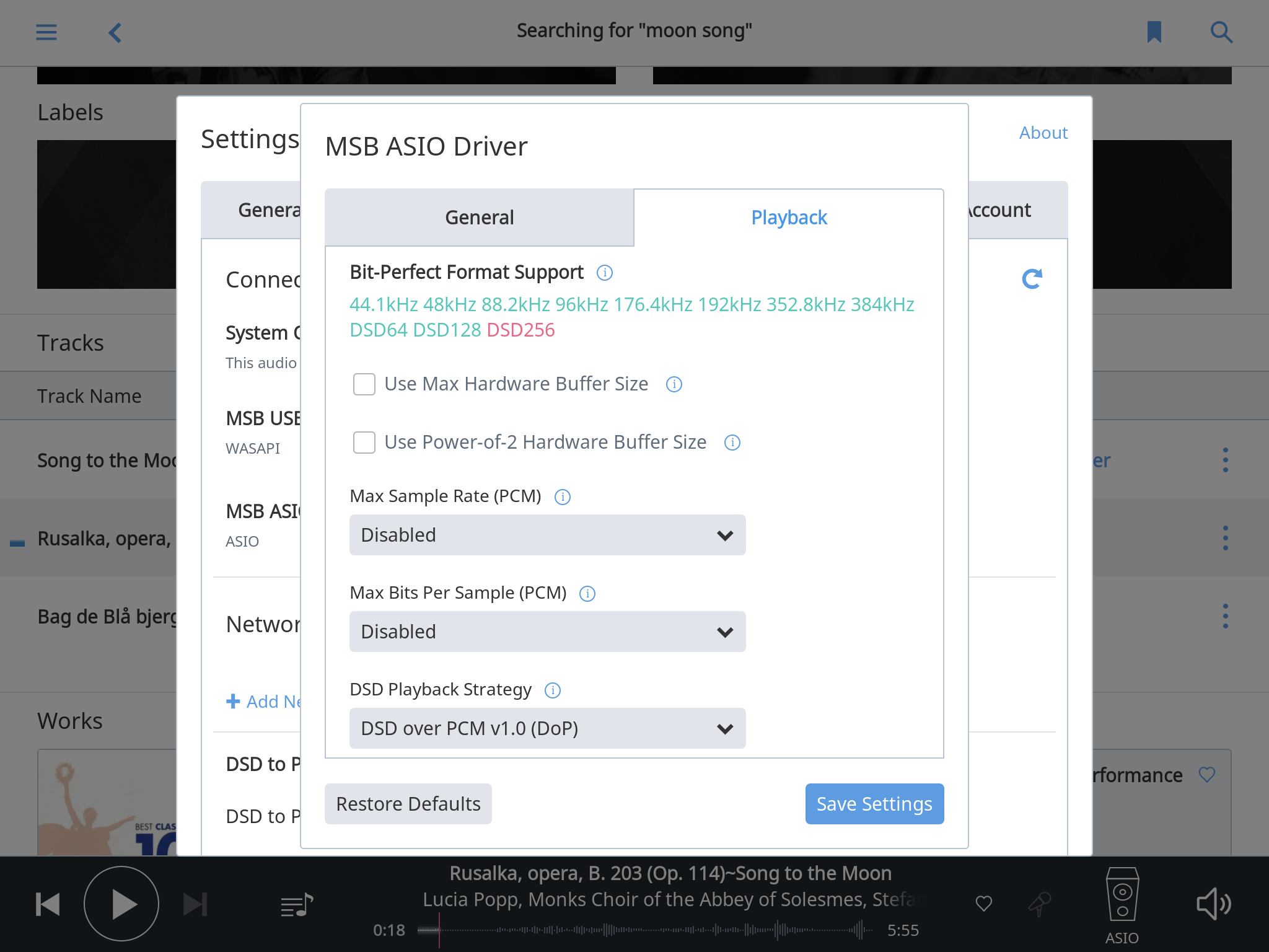

Screenshots (some menus on 2 screenshots - they are not expandable. I had to remove 2 screenshot, since only 5 are allowed. The ASIO driver is set at Fixed volume and Resync delay = 0s):

Thank you for answering. I thought the WASAPI driver was necessesary for the MSB USB extension and the ASIO driver for Roon. Sorry.
I can now play both DSD and PCM files in the same queue (ASIO disabled).
However, when skipping in the queue from DSD to PCM or from PCM to DSD, the very beginning of the selected file is warbled or not played (1 to 2 seconds).
This does not happen when skipping between files that are only either DSD or PCM.
I’m using a 500 ms buffer.
Is there anything I can do to make the transition between files of different format smooth?

Moving forward, have you tried adjusting your buffer setting? How about the resync delay? Perhaps try adjusting to 1 or 2 seconds? I am curious to see if adjusting these setting will offer a change in results for you.
