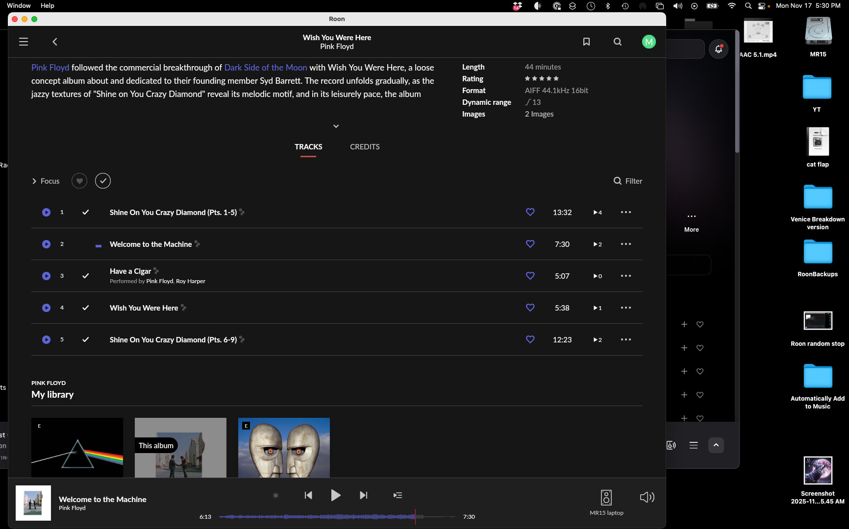

I started a support ticket a few months back about Roon randomly stopping playback. The problem was solved but I think its returned - maybe with this latest update? the screenshot shows the last time it stopped playback - maybe you can check on your side what happened at that point? Thank you!
no network - server and Roon on same laptop

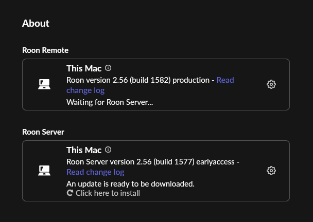

How do I revert to production server? I re installed the roon app, but the server is still showing as the early access version. Thanks

Sorry but on my system, installing from the link you sent gives me a DMG that replaces the Roon remote software, but not the Roon server software. How do I revert the Roon server to the production version please? Also ,how do I opt out of early access? I am still getting update notifications in Roon for the Early access versions, so if I hit update, Roon auto updates to the early access version. Thanks

When you opened and dragged over the Roon app from the production .dmg, was RoonServer closed from the taskbar? The RoonServer application is a bit hidden in the taskbar area, so if it was running at the time, it may have been failing to overwrite because of the already-running RoonServer instance in the background.
Once you are back on the Production track, the notifications to install Early Access updates will cease.

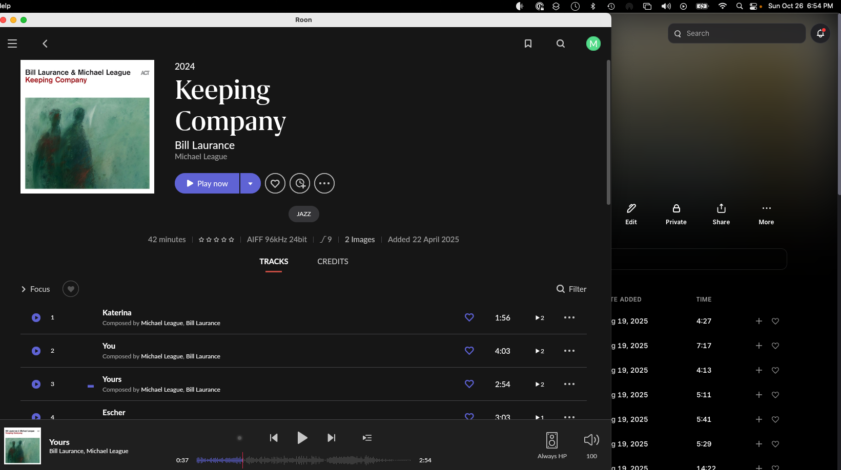

ugh.. unfortunately Im still getting the random stop :frowning: So frustration! Here’s the latest one - maybe you can see what was going on at this time?
