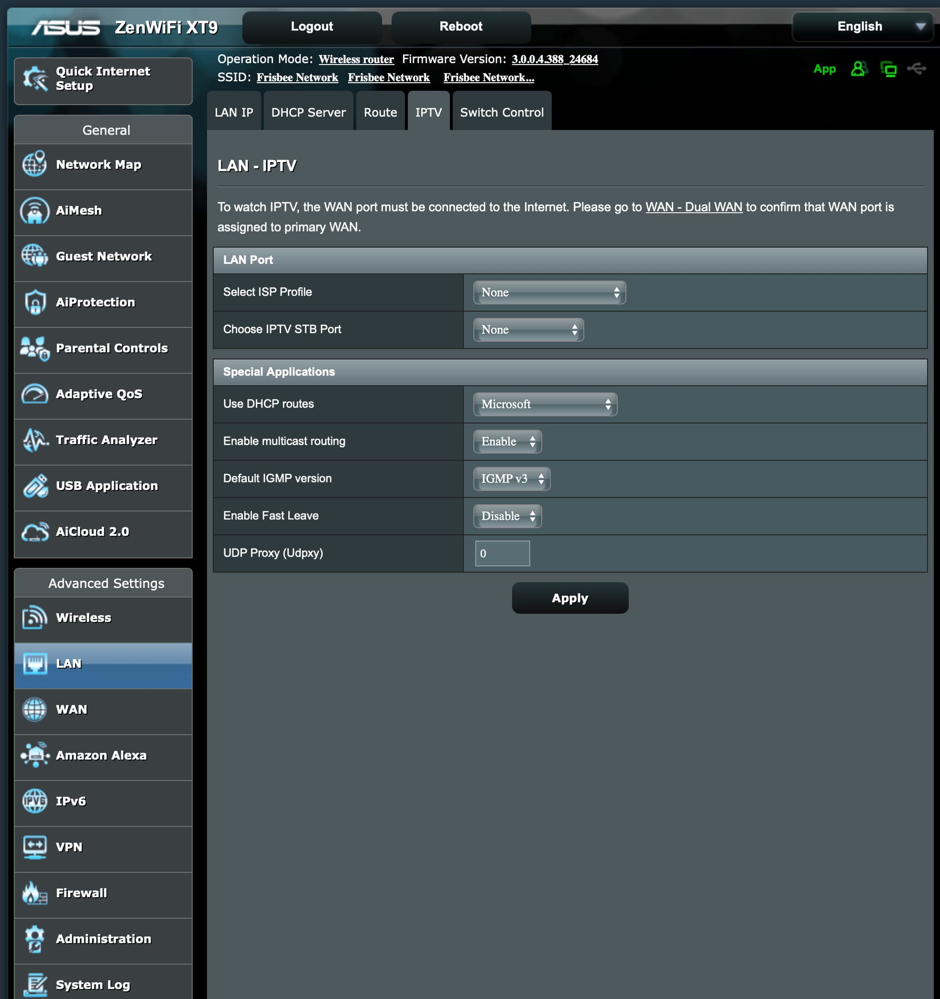

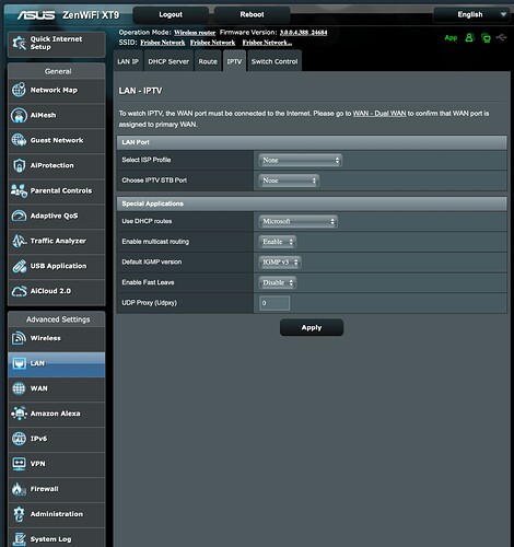

Note that multicast routing is enabled (see screenshot), and so is IGMP snooping on the router Wireless-Profession page.
Is it possible to tell if Lumos is providing a sub-par fiber link with a high error rate? Is there an independent way to test for this?
I should also note that the “Smart Connect” feature of the Asus routers in the WiFi setup is turned off.
