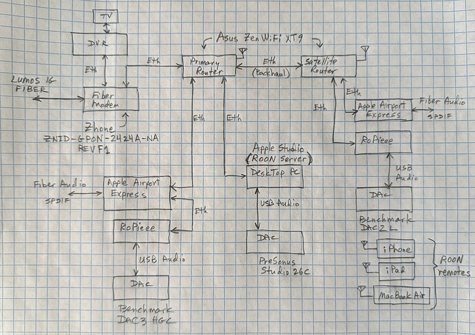

To summarize the issue with reference to the block diagram:
  1. The Raspberry Pi connecting to the second router is encountering sample dropouts and a broken pipe error in the TCP connection that together interrupt playback
  2. The Raspberry Pi connecting to an Airport Express is experiencing sample dropouts
  3. Any endpoints grouped to either of these Zones lose sync due to dropped samples with the Raspberry Pis
  4. Since this is agnostic to source (streaming vs. local), we can assume the blockage is within the LAN.

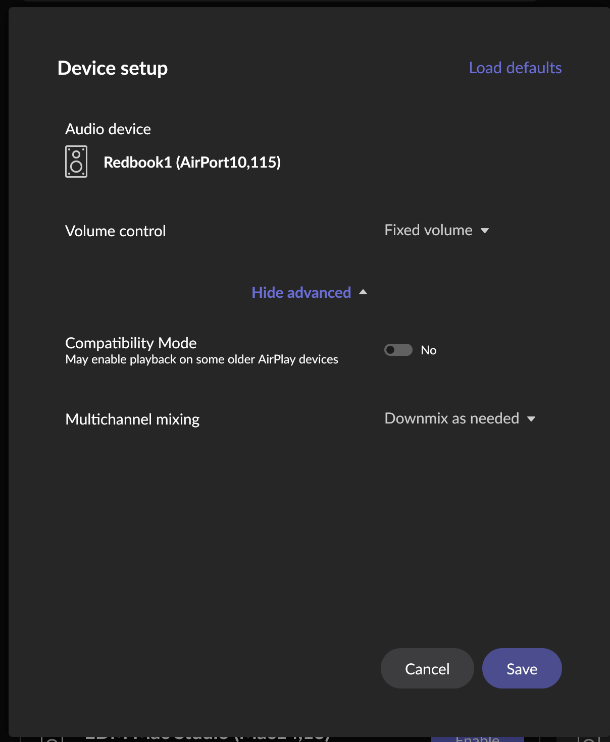

Let’s try connecting to the Airport Express as an Airplay Zone (add it to the Apple Home app on an iOS device). Turn on Compatibility Mode in the Device Setup page in Roon Settings → Audio. Do you experience dropouts with Airplay when you play to this Zone? This will help us identify if there’s something wrong with the network connection to this node, or with the protocol itself.

Furthermore, I realized this AirPort Express is connected to the router via a cheap Chinese switch (TrendNet TEG-S5g), not shown on the diagram. I removed it and connected the Express directly to the router. Not sure if this could be an issue…

The two AirPlay devices are indeed wired via Ethernet (see block diagram way above in this thread). Is this what you mean by “hardwired?” I added a switch back to the primary router (not shown in the diagram) so that AirPlay device goes via the switch

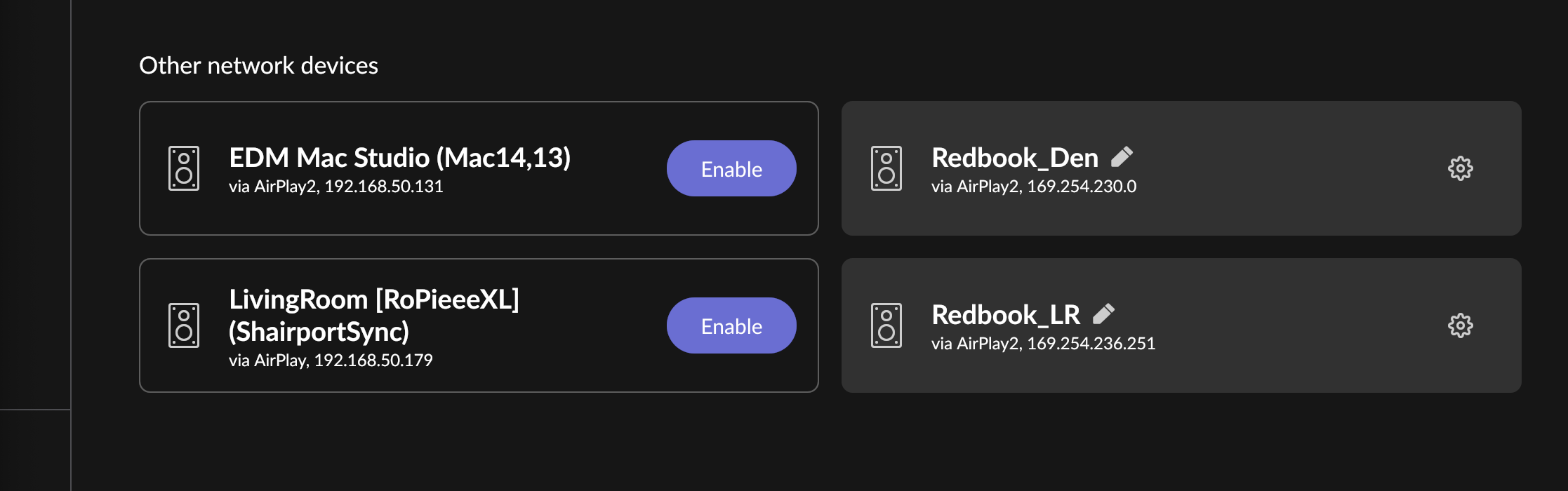

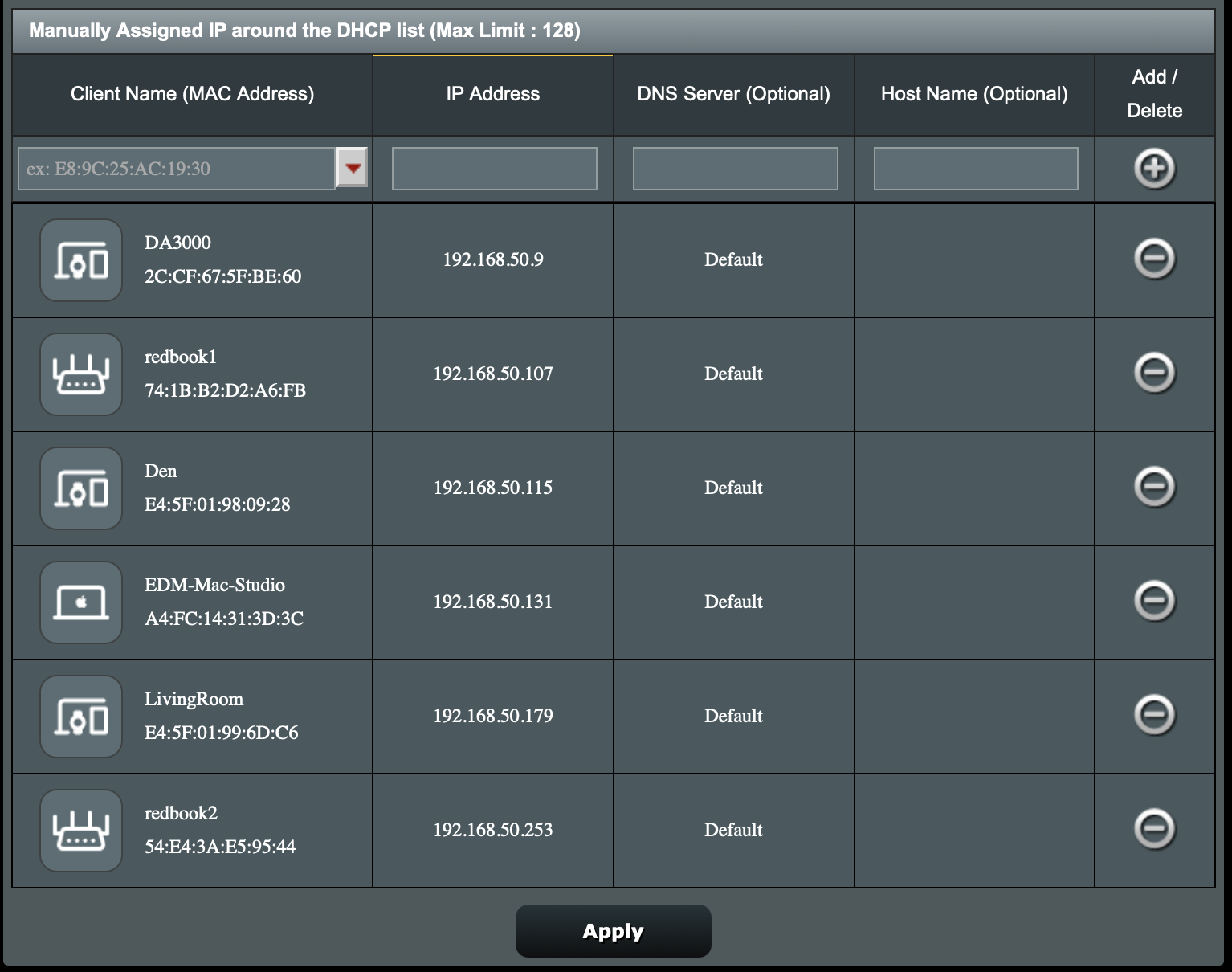

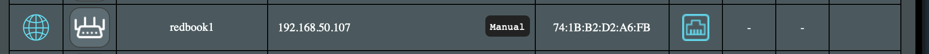

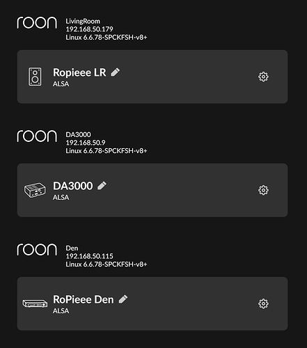

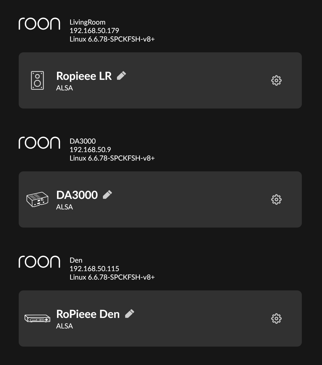

Interestingly, Roon has always shown these AirPort devices with a 169.254… address (see screenshots), but the router table shows the manually locked IP. I always wondered why they show a 169… IP in Roon. I unplugged each device one at a time, and they both came back with the same address shown in Roon and the router table.

The 169.254 subnet indicates that the device is unable to get an IP address from the DHCP server. By default, Asus routers set the DHCP lease time to 86400 seconds (24 hours). During this time, the device will receive the same IP address it was assigned previously.
You can try to set up a Reserved IP address in your router settings and then reboot your Airport devices, perhaps then it will pick up the correct IP address, but the 169… IP generally means that the device wasn’t able to get an IP address from the router.
In this network diagram here, is the primary router handling the DHCP assignments and the rest of the routers are in access point mode (no DHCP assignments)?

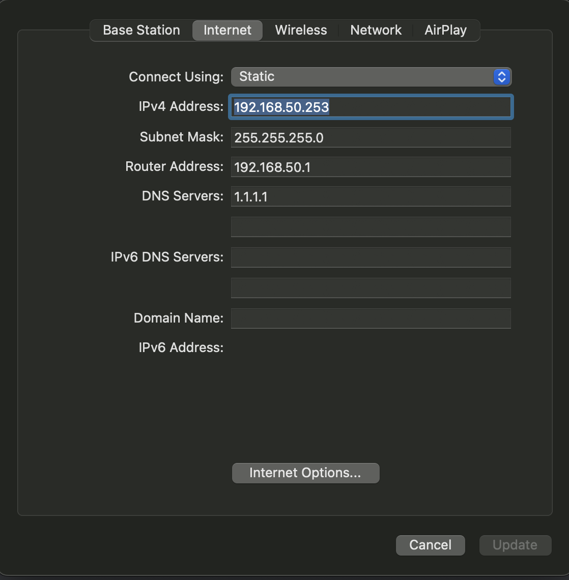

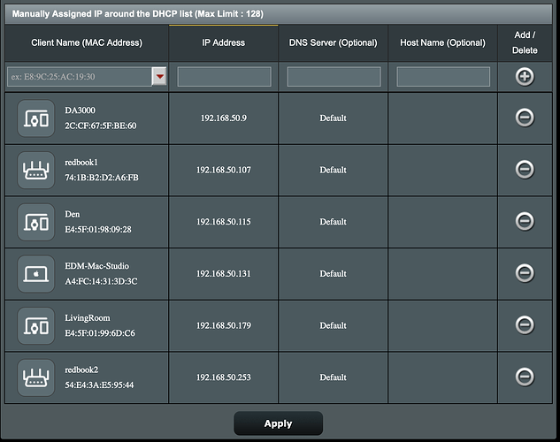

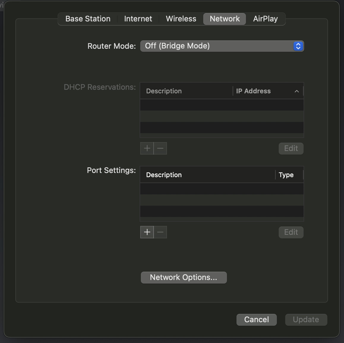

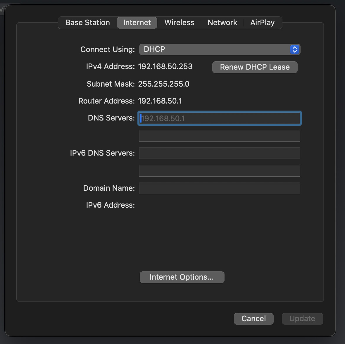

The 2 AirPort Express modules do have “Connect using:” set to DHCP (see screenshot below). The other choices are “Static” and “PPPoE”. However they are both showing the IPv4 address that has been manually assigned in the Asus router.

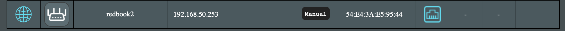

As seen on the previous screenshot (scroll above) of the Asus router list of “Manually Assigned IP around the DHCP list”, the AirPort Express devices are using the manual IPs assigned in the router. Also if you look at the device list in the router, these devices are shown as “Manual”, not “DHCP” or “Static.”
Given the AirPort Express modules are set up with a manual IP in the router, I assume there is no lease time involved from the router’s “perspective.” I haven’t tried setting the AirPort Express devices to “Connect Using: Static”. Do you think there is any point in doing so?

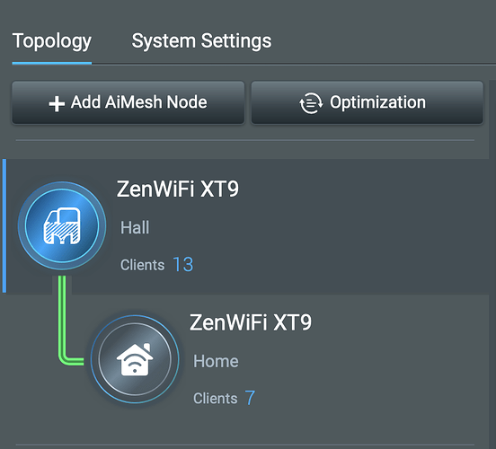

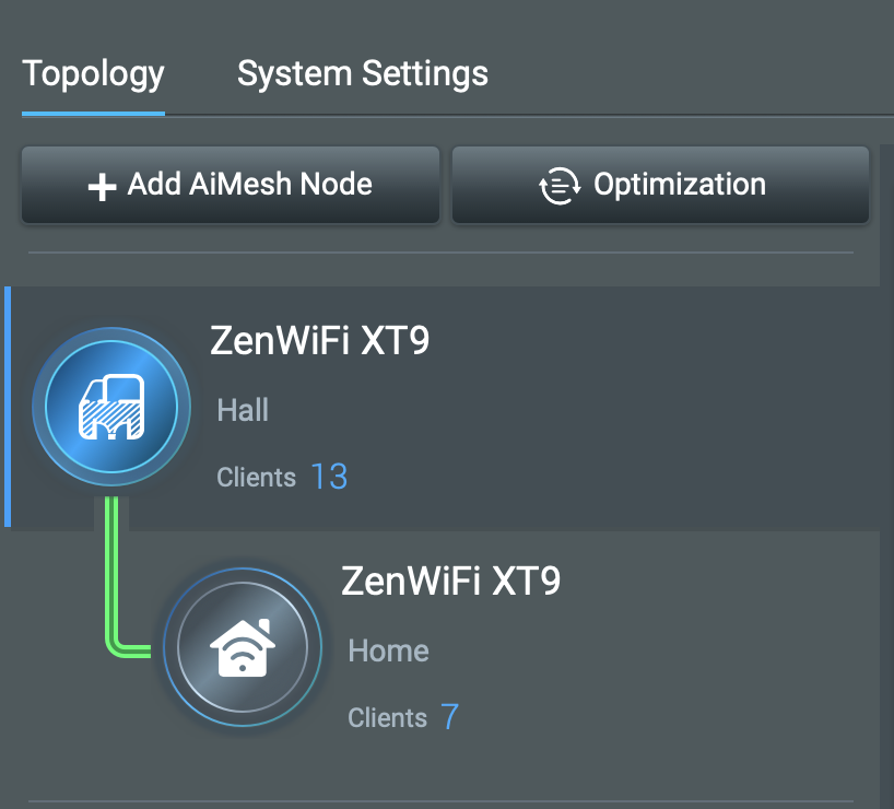

Regarding the Asus “primary” and “satellite” router configuration, they are set up in the Asus proprietary “AiMesh” mode (see screenshot below), with “Ethernet backhaul”. Both AirPort Express modules do show the router address as 192.168.50.1 (the screenshot below), which is correct. “AiMesh” is somewhat mysterious to me.

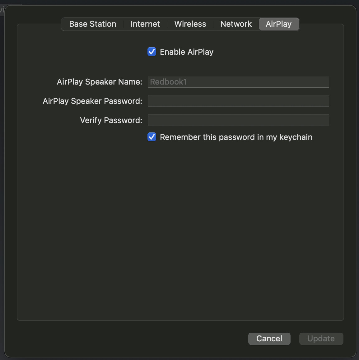

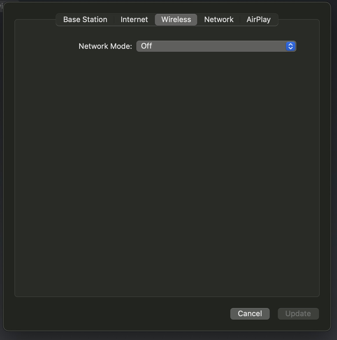

Also see the below 3 screenshots of the other AirPort Express module configuration screens
Noris

I temporarily disconnected power from one of the AirPort Express devices and checks the Roon Audio settings on the Mac Studio. When I scrolled to the device that was power cycled, I noticed the Roon display (“via AirPlay2, …”) went from a 192… IP back to the 169…IP- maybe as a result of scrolling to where it could be seen at the bottom of the page.
Updated AirPort Express config screenshots below.
Hi @likeanice1903 ,

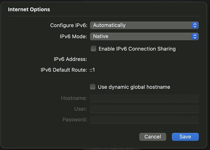

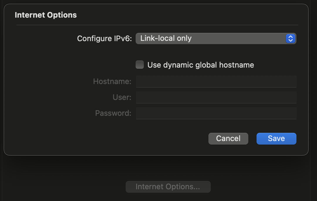

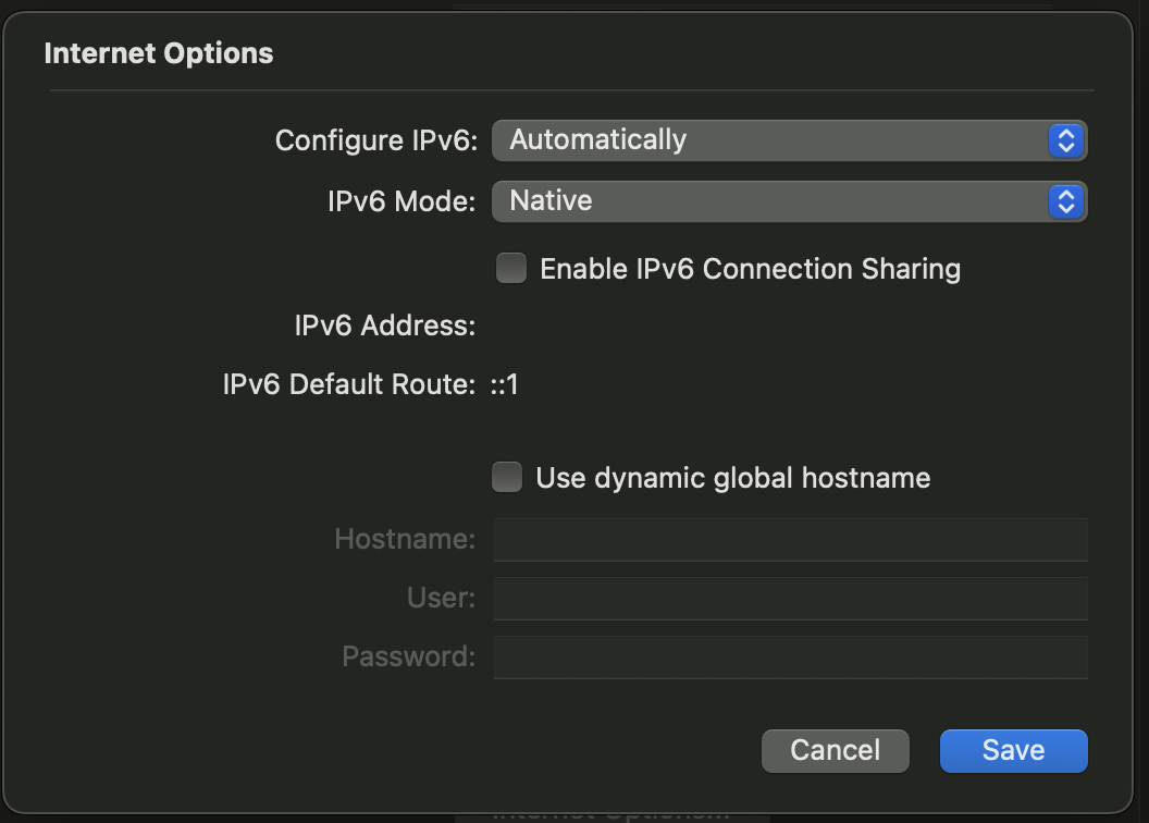

Thanks for the screenshots and the additional info. I was able to look over your latest diagnostics and I do see the 169.254 IP listed there. I also noticed a 403 Forbidden error when trying to pair with the device. I’m going to check with the team regarding these errors and we will get back to you. In the meantime, can you please also confirm if disabling IPv6 triggers any change in behavior?
Noris I disabled IPv6 on the AirPort Express modules and rebooted one of them, as well as restarted Roon. The Roon Settings>Audio page still shows 169.254… IPs, but the router shows 192.168… IPs.
A week ago one of the AirPort devices rendered 2 hour long playlists from various sources and resolutions with no problems, so despite the IP address mystery they seem to work.
AirPort Express IPv^ page:
Roon>Settings:
