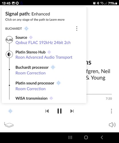

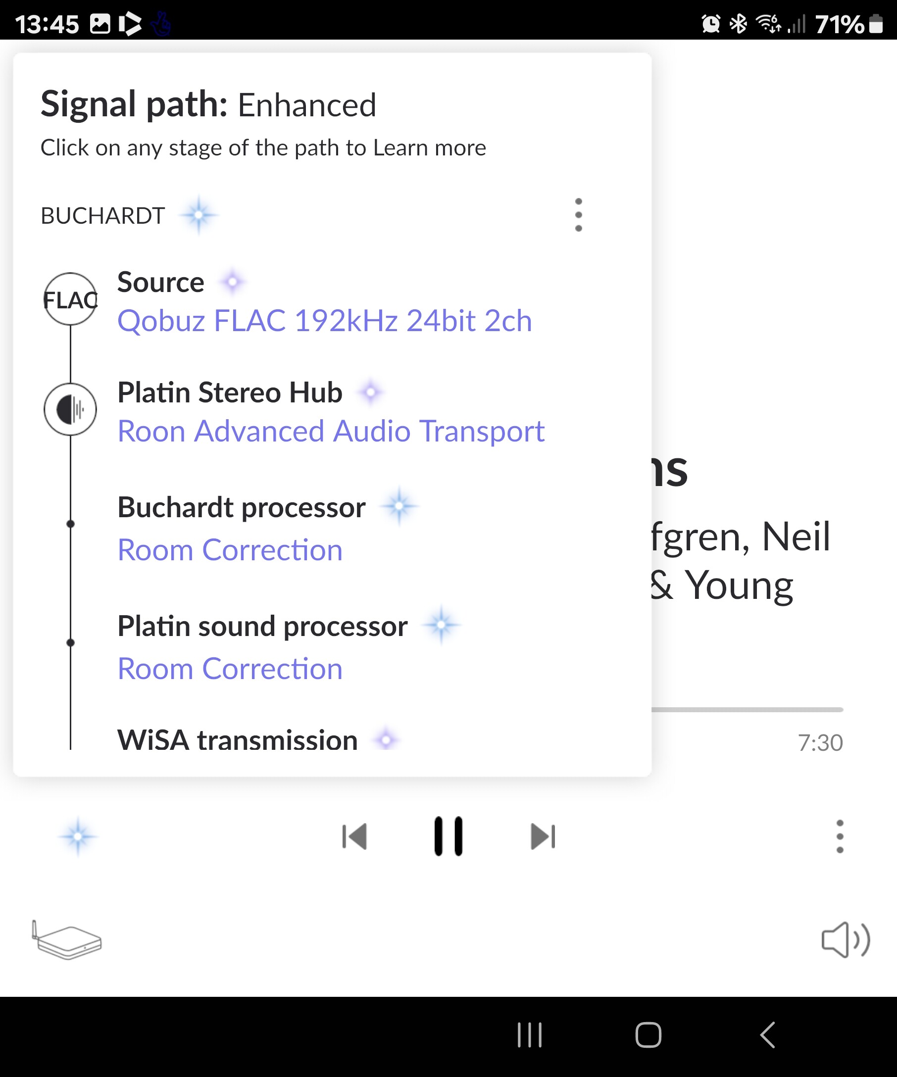

Hi please see attached screen grab…dropped just now at 13.45 gmt…
The innous mini is ethernet wired to router…platin hub is WiFi but inches from router…
Thanks
Hey @Tony_Doherty,
Thanks for the update! From your screenshot, there appears to be some DSP occurring after Roon sends control of the audio signal to your streamer. If you temporarily disable all DSP, do you still run into the same issues?

Hi Thanks for that but the platin hub cant be hardwired for ethernet…and the DSP doesnt effect playback when i use tidal or Quboz directly only via Roon.

That’s a helpful detail—thank you for pointing it out. Roon’s DSP engine works differently from the native apps, which can sometimes lead to unexpected playback behavior. Were you able to test playback in Roon with DSP disabled? That could help us narrow down whether the issue is specifically related to Roon’s processing.
