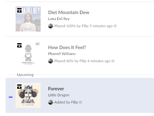

· Playback skipping to next song before current song ends when using Chromecast on KEF LSX II LT. This happened on 29.05.2026. around 15:05 CEST - one track played to 40% and then Roon jumped to playing the next track without any input from me.

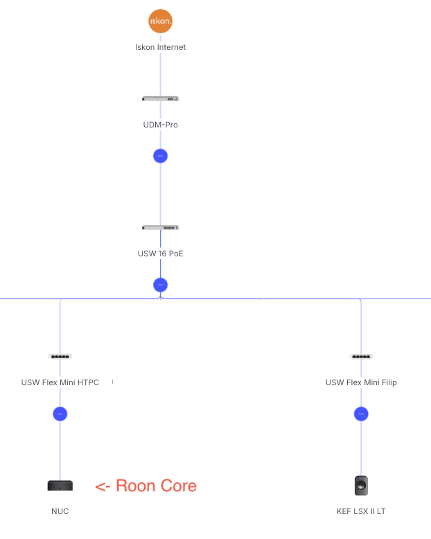

Hi, due to the way the wiring is set up in the house, there are some additional switches in the network, so the NUC that runs Roon Core on Linux and KEF are not on the same switch. They are managed Unifi switches:

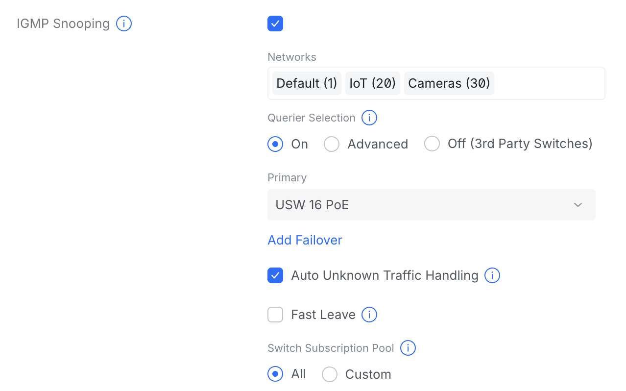

IGMP snooping is set up like so:
Both KEF and Roon core are on devices on the Default VLAN.
Multicast settings of Wifi (which I commonly see suggested as a potential fix) are irrelevant for KEF (I tested those as well a while ago for Sonos since those use WiFi, but it didn’t make a difference).

We confirmed the exact incident at 15:05:27 CEST on May 29. At that moment, the KEF itself sent Roon an StoppedEndOfMediaUnnatural signal — meaning the KEF’s internal Chromecast receiver terminated the media session unexpectedly and reported it back to Roon. Roon’s buffer was at 100%, there was no CPU or memory pressure, and no network timeouts on Roon’s end. Roon correctly treated it as an error and advanced the queue. The skip originated on the device side, not Roon’s.

Why AirPlay doesn’t have this problem: Roon serves audio to the KEF’s Cast receiver via a local HTTP stream that the KEF fetches over the network. AirPlay uses a push model where Roon pushes packets directly to the device, which is more resilient to brief network hiccups. With the NUC and KEF on different switches, even a transient inter-switch disruption can drain the KEF’s Cast buffer and trigger the early stop.
What to try:
  1. Same switch — if wiring allows, put the NUC and KEF on the same UniFi switch. This eliminates inter-switch hops from the HTTP stream path and is the most likely fix.
