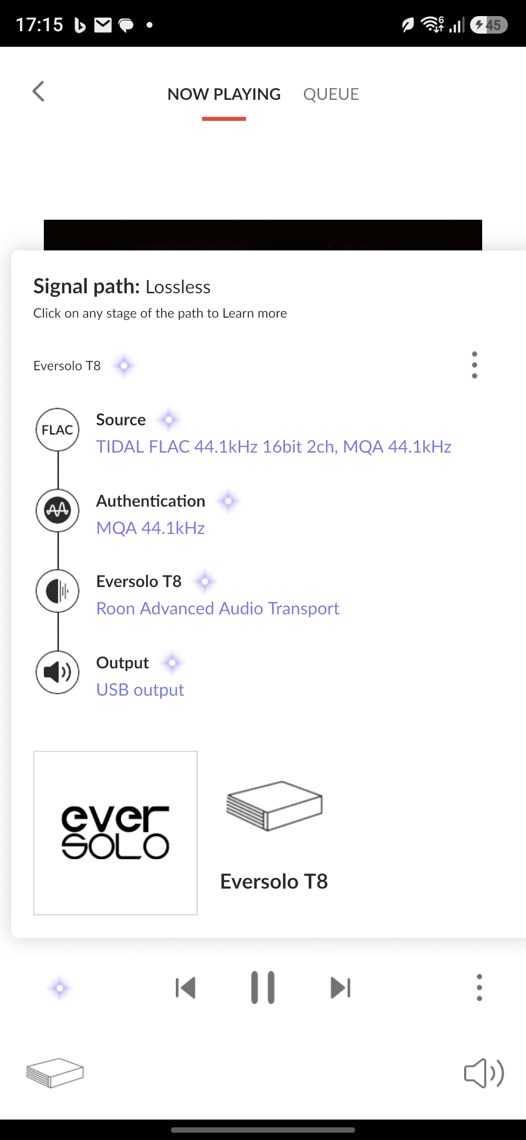

· When playing music with Roon Nucleus One using the Magnetar UDP900 MK2 as DAC, and Eversolo T8 is the Roon endpoint, the speed of music is faster and plays at a higher pitch. I notice this with 44.1 and 176.4 khz:
A piece of 4.40 minutes is turns into 4.17 min with 44.1 khz, and one of 5'29" turns into 5'01" with 176.4 khz.
Music at 192khz is OK.
Measured using a stopwatch.
It happens only when USB connection is used, not coaxial or optical.
When Magnetar is the endpoint, speed is normal. (no T8 involved)
Looks like a handshake, sample rate or clock synchronicity mismatch problem. I've already set and tried different configurations in Roon, Magnetar and T8, like 'resync delay' and 'clock master prioriry' with different values in Roon. No DSP (Muse, in Roon) is used. I did a factory reset and on-off several times. Connected/disconnected cables. Eversolo T8 Firmware is v1. 5.75. Will there be an update to address this problem in case it belongs to the T8?
Magnetar UDP900 MK2 is 1012CR-ESP01 May20.2026.
ROON Nucleus One is 2.67 (build 1661)
· Router NOS.pt Hitron Coda-5519HUB6, Switch SilentAngel Bonn 8

When playing 44.1 kHz-family rates (44.1 / 88.2 / 176.4), the T8’s USB output stage is actually clocking the audio at the corresponding 48 kHz-family rate (48 / 96 / 192). The DAC plays 44,100 samples-per-second of data at 48,000 samples/sec, so the music finishes 8.8% early and 8.8% higher in pitch, exactly your stopwatch numbers. The 192 kHz case is fine because 192 is already a 48k-family rate, so there’s no mismatch.
That said, it’s doesn’t appear to be every 44.1 playback, it’s intermittent, but when it breaks, it breaks by exactly the 44.1k→48k ratio. That’s a hallmark of the device’s USB clock domain failing to switch to the 44.1 kHz master clock and staying on (or falling back to) the 48 kHz clock. Note 88.2 didn’t appear in your test sessions but would behave identically.
Roon is doing everything correctly here. For every track it negotiates the right format with the T8 and sends the matching sample rate: sample_rate:44100 for 44.1, 176400 for 176.4, 192000 for 192.
The T8 accepts each one (“status”:“Success”). So this is doesn’t appear to be a Roon configuration or handshake problem on Roon’s side, Roon hands the T8 a correct 44.1 kHz stream.
It appears that the fault is inside the Eversolo T8’s USB output path. When it plays a 44.1 kHz-family rate, its USB audio clock domain is not switching to the 44.1 kHz master clock, it stays running at the 48 kHz-family clock and plays 44,100 samples-worth of data per second at 48,000 samples/second. That’s why:

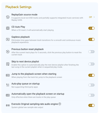

Looking over the Eversolo T8 Manual, I would confirm you are on the latest firmware and it looks like there may be an Original Sample Rate Audio Engine setting, which may help:

I’ve checked the menu you present. Most options are likewise, mainly the last one. Replaygain is off, too.
Turned the last option shown to off, and the quick speed continues.
