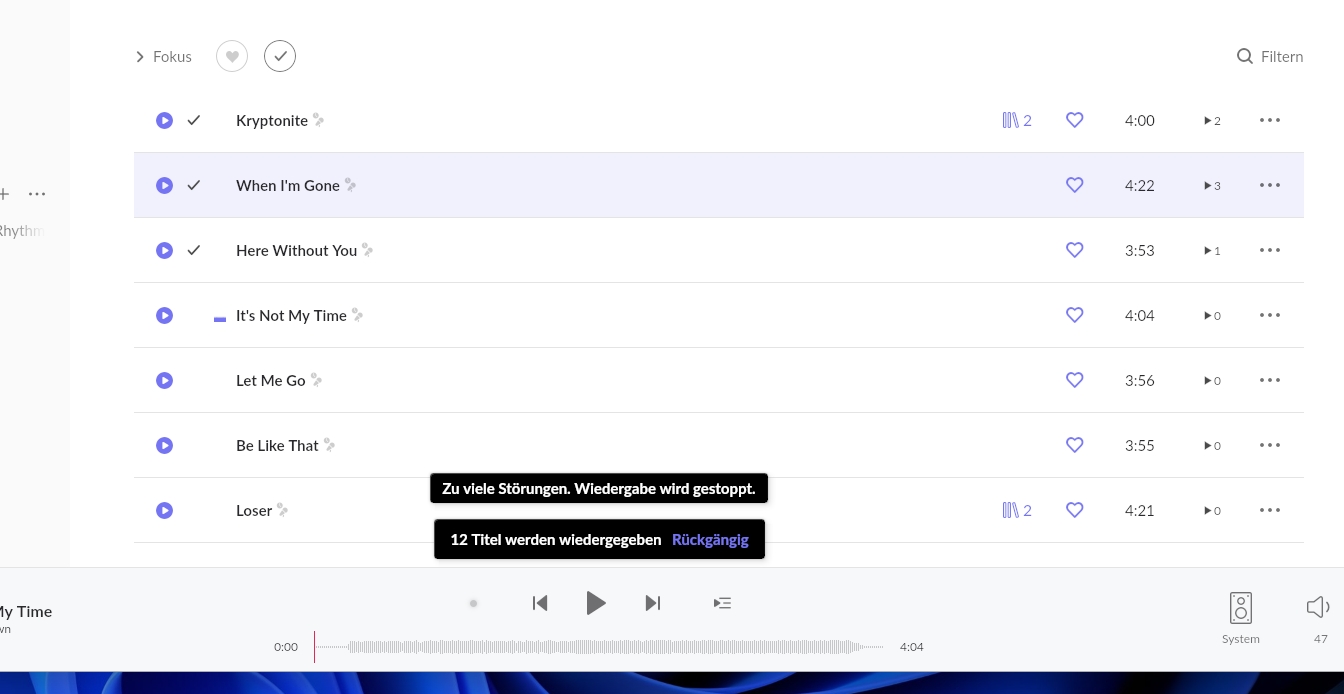

I'm getting the same error again as I did in February 2026. After switching the output to my Cambridge streamer (which worked) and then switching back to the built-in Windows 11 audio playback, I'm getting the message “Too many interruptions; playback has been stopped” again. I've already checked the firewall settings, and I don't know of any other solution. Why doesn't Roon work reliably on Windows 11?

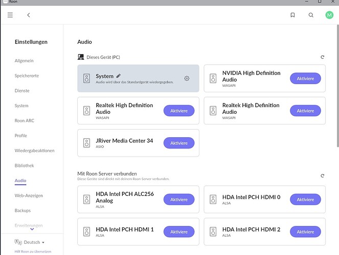

We have checked the diagnostics report from your Windows PC and were able to confirm that the problem is caused by a format conflict between Roon and the Windows audio mixer. Specifically, when routing audio through the default “System Output”, Roon is attempting to play standard 16-bit audio, but the Windows mixer is rejecting this specific format. Furthermore, using “System Output” prevents Roon from utilizing Exclusive Mode to take direct control of your audio hardware, which leads to the “Too many interruptions” error.
In order to resolve it, we recommend bypassing the Windows default mixer entirely by taking the following steps:
  1. In Roon, navigate to Settings > Audio and disable the System Output zone.
  2. Under the "Connected to this PC" section, find your specific physical audio device (for example, Realtek High Definition Audio via WASAPI) and enable it directly.
  3. Click the gear icon next to this newly enabled device, select Device Setup, and toggle on Exclusive Mode.
This will grant Roon direct access to your audio hardware, allowing it to manage playback and switch sample rates automatically without any interference from the operating system.

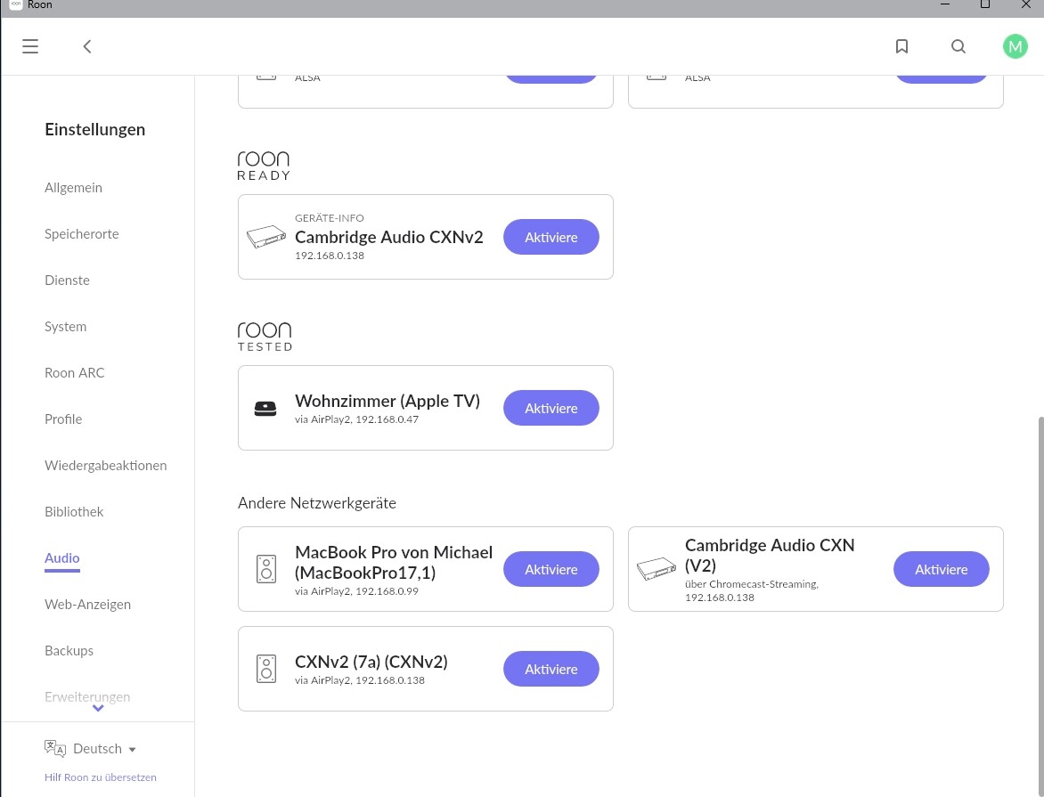

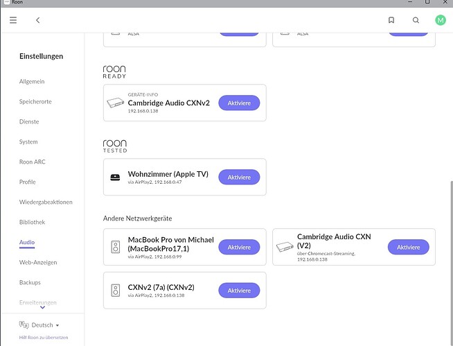

sorry but i don’t find the option you provided there is no “connect to this PC Section” at all
Why should I disable the System output zone if I want to play back via the W11 System Audio driver?
What is a gear icon ? Do you have an example?

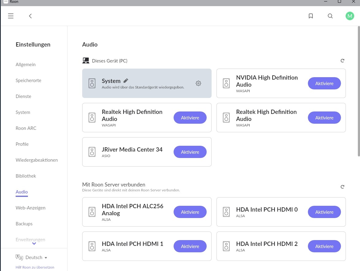

Hi @Michael_Herzog,
Your first screenshot is what we’re referring to - all your audio device options under (PC) in your audio settings.
To confirm, you attempt to enable your WASAPI output options under your (PC) devices, and it fails? What fails specifically, can you include more information or errors you see?
Once you enable a zone, you can access it’s settings via the cogwheel / gear icon - it’s shown in your first screenshot again:
From there, access your advanced settings and enable ‘exclusive mode’ - you may want to try this with your WASAPI output as well.

First of all I had to reinstall the RealTek audio driver 2.82 to get it working. Now I’ve enabled both RealTek WASAPI options because the first one didn’t work.
What is a zone? What is it used for? for what do i need private mode

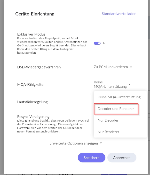

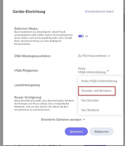

i found exclusive Mode if i activate it and choose Decoder and Renderer no Sound is played

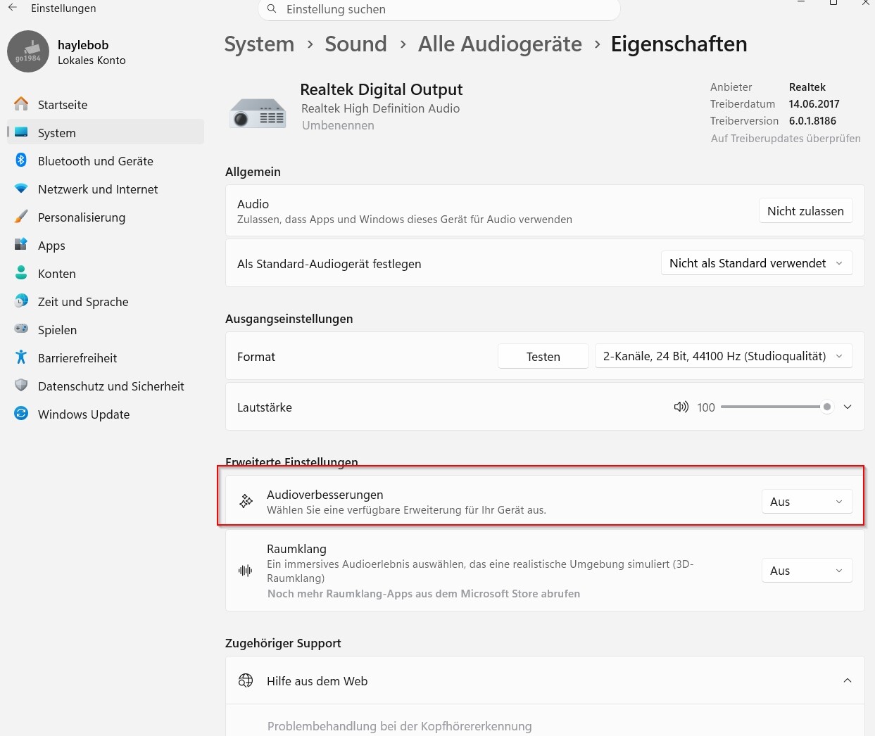

Hello @Michael_Herzog,
It sounds like you’ve done some great detective work with your local AI assistant! You are absolutely on the right track regarding that setting in your Windows 11 screenshot.
In your third screenshot, the red box is around “Audioverbesserungen” (Audio Enhancements).
You should definitely turn this “Aus” (Off). Here is why: Windows 11 often tries to apply its own processing (like “spatial sound” or volume leveling) to the audio stream. When Roon tries to send a high-quality stream to your RealTek hardware, these Windows “enhancements” can cause a timing conflict. This is exactly what triggers the “Too many interruptions” error—the Windows mixer is essentially tripping over Roon’s data.

In your fourth screenshot, you have the MQA setting set to “Decoder und Renderer.”
  • The Reality: Your built-in RealTek audio chip on the motherboard is not an MQA-certified device.
  • The Fix: You should change this setting to “Keine MQA-Unterstützung” (No MQA Support).
When you tell Roon the device is a “Decoder and Renderer,” Roon sends a specific bitstream that your RealTek chip doesn’t know how to translate, which is why you aren’t hearing any sound when you toggle that on.
  1. In Windows: Keep those “Audioverbesserungen” set to Aus (Off).
