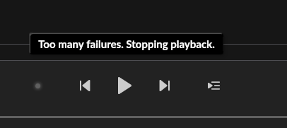

Playback stops intermittently due to multiple failures (ref#FE6MBA)

Too many failures - Stopping playback

Hello @Serge_Auclair ,
Welcome to the forum! I activated diagnostics for your account and I noticed that you are getting an error with clock sync for your Cambridge zone. When this issue occurs, do other zones continue to work as expected (e.g. Airplay zones), while only the Macbook-connected devices have an issue?

Hello noris, I only have one zone and I use an HP laptop under Windows11 with a wired USB cable from my laptop to the USB port in my CXA81. I also use an iPhone 16 and an iPad 9th gen with Roon remote app. Everything is now working fine. I hear a significant difference with Roon. I am wondering if this problem had something to do with the NordVPN I recently installed.

Hello noris,
Roon is working fine on my laptop but the app on my iPhone 16 and on my iPad 9th can’t connect to the server???
And Roon on my laptop no longer works…Obviously the fundamental problem is not solved. Thank you.

Hello Robert,
I uninstalled and reinstalled Roon and it is now working fine but it doesn’t take much to end up in the same too many failures. Stopping playback.situation. I have to uninstall and reinstall Roon to solve the problem which is not the right way to solve this issue but that is the only thing I can do to solve this. I am not super computer savvy but I Love what Roon does to the sound of my system which is the first reason I use Roon. Thank you for your attention and thank you very much for removing the solved flag. Please let me know if some hardware addition to my current set-up would create a more stable plug and play solution.

The use of VPNs falls outside the scope of Roon support, unfortunately - can you please disable all VPN usage and reproduce the issue? Please share a specific date, time, and if applicable, the name of track playing when you run into a playback failure.

Hello Benjamin,
I did try to turn off the NordVPN and it doesn’t seem to be the problem. For now, all is fine. When I get this message, the software tries one song and the moves to the second and so on for about five times and then I get this message. Thank you your assistance. I absolutely love what Roon does to the sound of my system.
Hello Benjamin,
Got it!
It is the VPN and to solve the problem you not only have to disconnect NordVPN you have to quit the app altogether. Once ROON is operating I can put the VPN back on and it will not interfere. Thank you for your assistance and have a great day.
