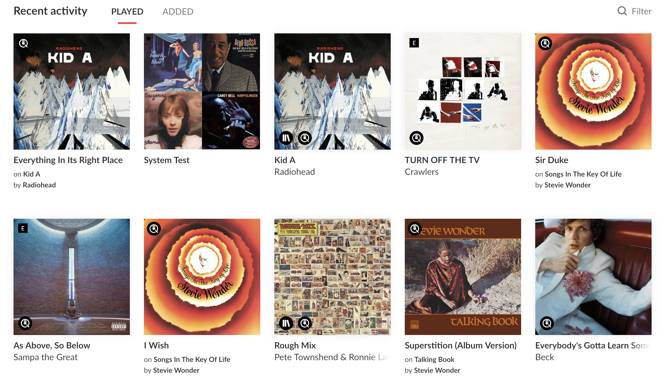

Since restoring my Roon database from a backup onto a new ROCK installation (Intel NUC10i3FNH, Roon 2.71 build 1683), the Played view in Recent Activity behaves incorrectly.
Symptoms
The first two entries (one track and one playlist) remain permanently at the top left most position of the shown list (first and second positions).
Newer plays are recorded, but always appear from the third position onwards.
Replaying the pinned track creates a second Recent Activity entry in the third position the list rather than replacing the original.
The underlying History view is correct.
The issue is identical on multiple Roon Remotes (macOS and iOS).

  1. Yes. The issue appears on the home page of all Roon Remotes when using my profile. I have this evening realised that my daughter’s profile updates Recent Activity correctly. So it seems to be limited to my profile.
  2. No. The affected objects weren’t present in the queue for any of my zones. I’ve also cleared all queues and then played another track to test whether the stuck objects would move. Unfortunately, they remained in place.
  3. System Test playlist contains entirely Qobuz content. I do have one of the tracks in my local library as a lower-resolution version, but I specifically added the high-resolution Qobuz version to the playlist.

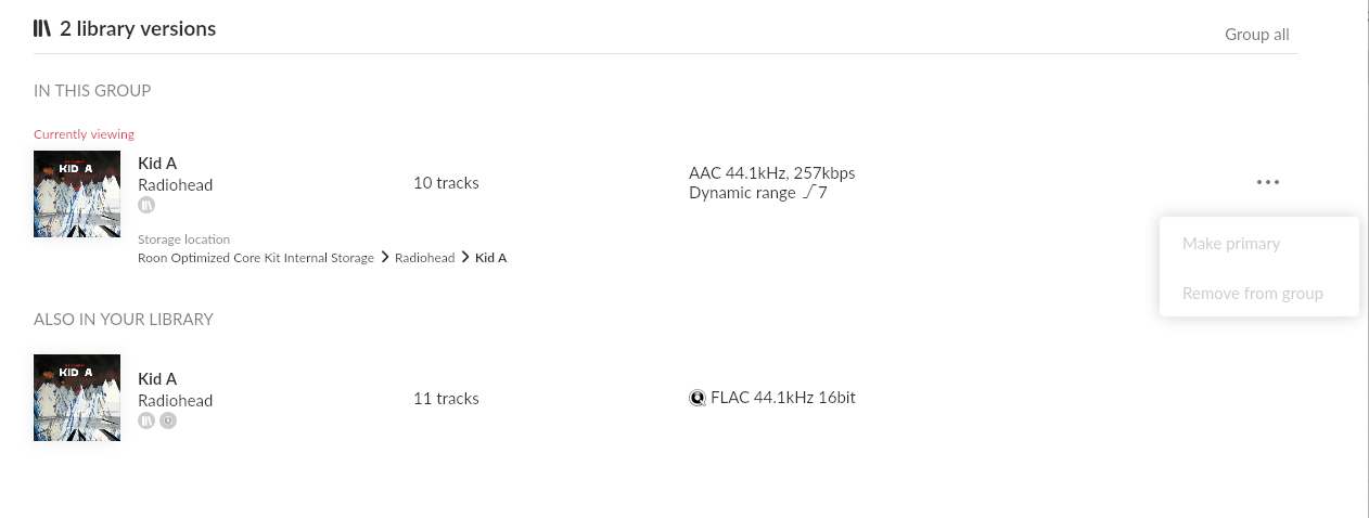

Lastly, logs seem to indicate that the restore collapsed the identity association between the Qobuz and local object of Kid A. Try opening Albums → Focus → Inspector and adding a Duplicates filter. Are the two objects separated? What happens if you merge them or mark them as alternates using the Edit Album tool?

I checked Albums → Focus → Inspector → Duplicates. Kid A does not appear in the duplicates list.
The duplicates that do appear seem to be expected ones, for example, albums where I have both a local AAC version and a Qobuz Hi-Res version in my library, and albums where I intentionally have separate stereo and mono editions (e.g. The Beatles).

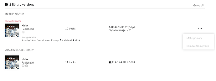

I investigated Kid A further. The local AAC version and the Qobuz version are already shown together under “2 library versions”.
The local version has 10 tracks and the Qobuz version has 11 tracks.
The context menu only offers “Make primary” and “Remove from group”, but both options are disabled (I’ve attached a screenshot).
So from the UI, Roon appears to consider the two versions already grouped correctly, and I can’t see any option to merge them or mark them as alternates.

Kid A is a dead end, and you can stop chasing it. Your screenshot shows the two copies correctly grouped, with the AAC version as primary and currently selected. Those context menu options are unavailable because there’s nothing there to change, the versions are already grouped, and the one you’re viewing is already primary. It won’t show under Duplicates either: 10 tracks against 11 makes these different editions, which Roon groups as versions rather than flagging as duplicates. Nothing to merge, nothing to repair.
