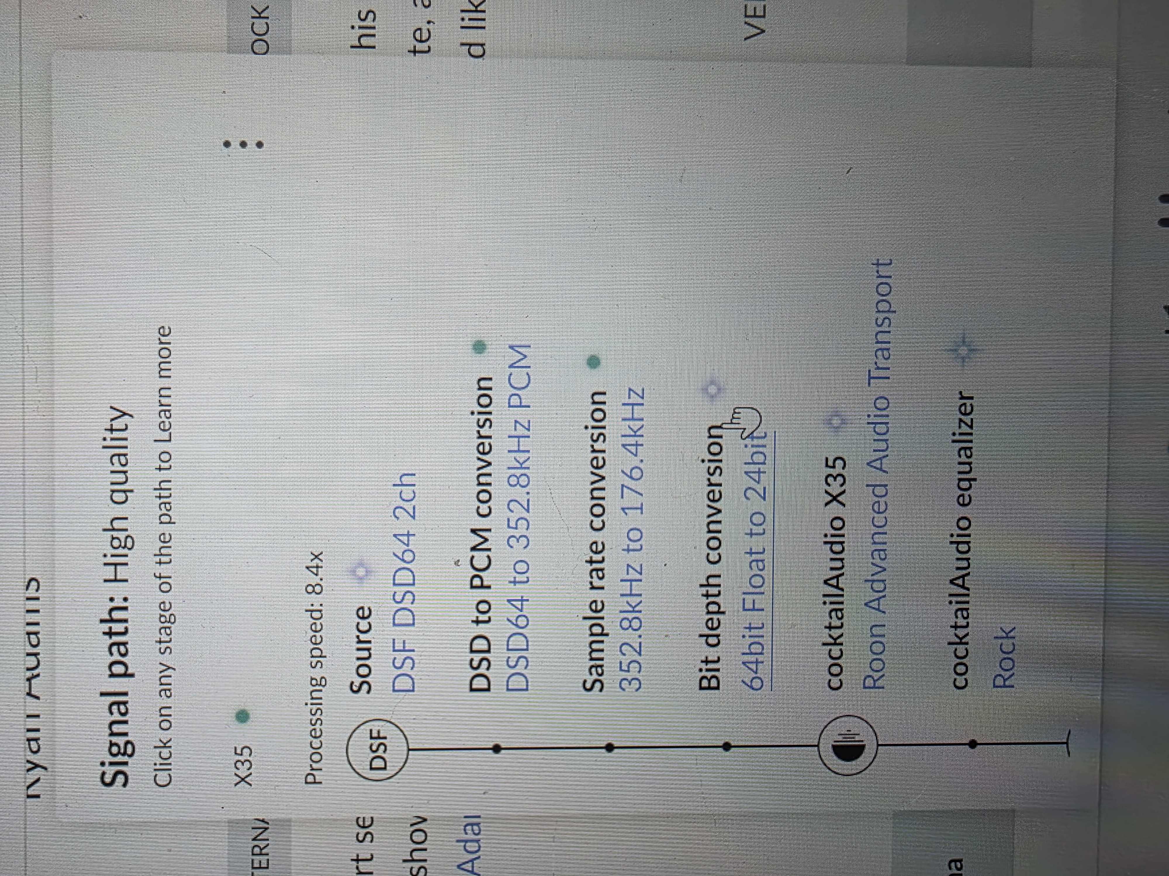

Playing Native DSD Issue with Roon Certified DAC (ref#CDM70G)
· Playing Native DSD to a ROON Certified DAC
· NA
Hi, welcome! I guess the issue is that DSD gets converted to PCM? If so, try to disable the equalizer and see if that fixes it.
Seems to be a limitation of the X35 regarding roon. Years back discussed here… Cocktail audio X35 converting DSD in PCM - #18 by ged_hickman1
You may check if your X35 has the latest firmware.

Have you tried changing your DSD Playback Strategy to DoP?
Don’t consider SL-G700M2, it has the same problem with native DSD in “Roon ready” mode.
Tried everything lol.
Honestly, ROON should just feed Native data no matter what format to the DAC/Streamer and let it deal with it.
That won’t help if it can’t deal with it. (And if it can deal with it, the device should tell Roon)

According to the older thread, DSD over RAAT was not implemented in the x35, so blindly sending it can’t fix that
