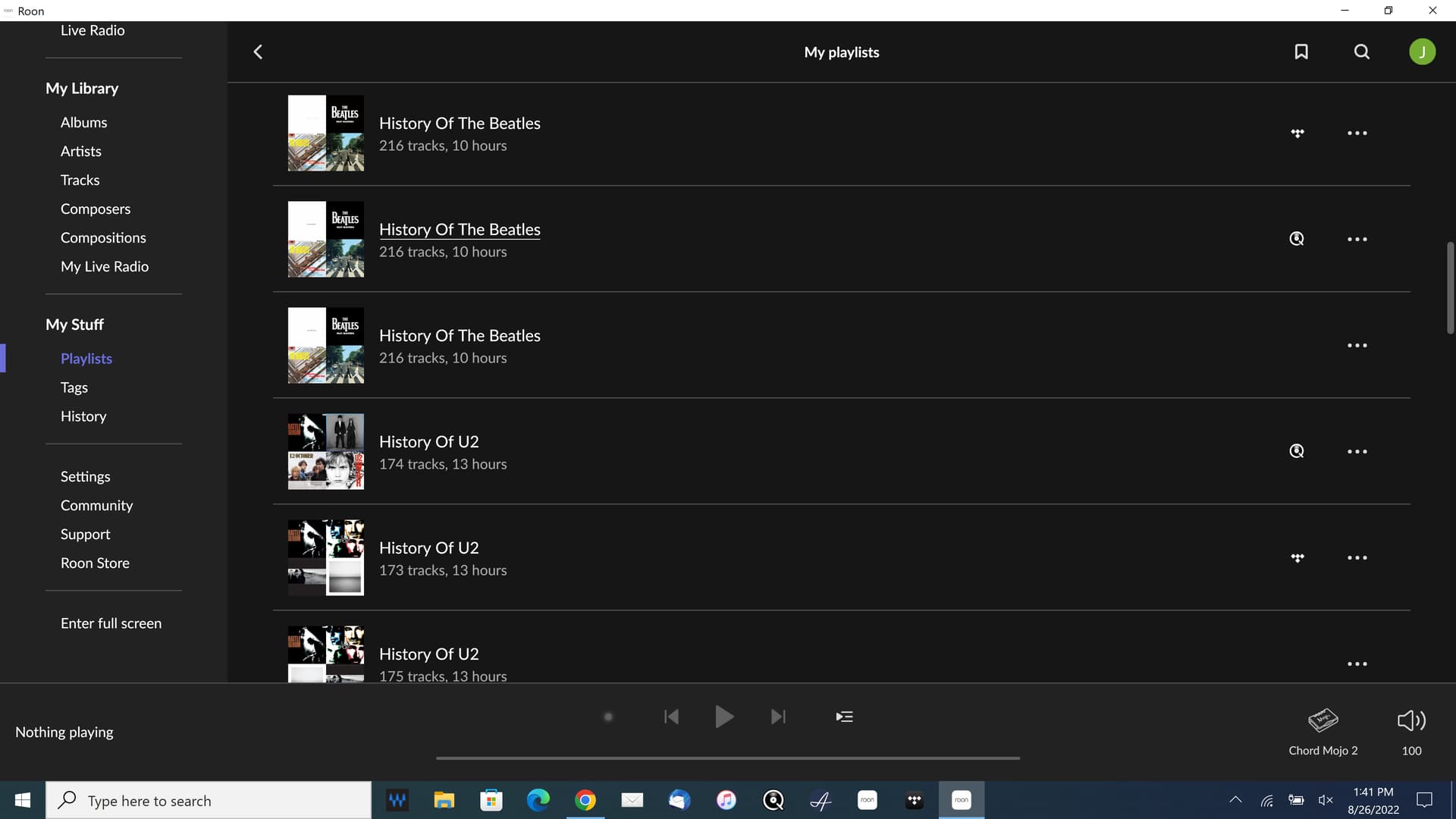

I make all my Roon playlist using Qobuz linked files. Then, I use Soundiz to export them to Qobuz, Tidal, and Apple Music. Soon after, they will show up in Roon as playlist from Qobuz and Tidal. So, I have three copies of every playlist in Roon. They are Qobuz, Tidal, and local.
Click the three dots ICON out to the right of the playlist you want to export.
