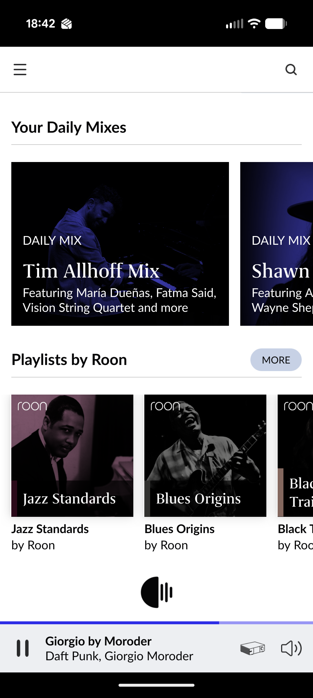

· No content appears below the "Playlists by Roon" section. Below the playlist view, there is simply a "loading" animated indicator. This has been going on weeks, though has been gradually slowing for some time. This occurs across front end apps (latest Android, latest app update as of today, multiple iPads running latest OS and app). Tried clearing app cache, uninstalling app on all devices. Tried updating and restarting Roon Server (Ubuntu 24.04), deleting server and reinstalling, then restoring backup. No effect. Confirmed no server or host utilization issues, no network issues.

Issue has gotten worse. Now the “Playlist by Roon” feature takes upwards of 1.5 minutes to load, at which point the animated load icon again remains loading forever, never showing anything below playlists. I went through and performed, once again, full maintenance. Cleaned up, ran manual backup, uninstalled Roon app from all devices, reinstalled app, made sure cache was cleared, reconnected. Disabled all network ad blockers and monitored traffic from the Roon server on my firewall looking for unlogged drops, monitored NICs for low level packet transit errors, nothing there either. Monitored CPU, memory, and disk usage. Everything very low. Then swapped the Roon server over to use my second internet connection, a business class connection with static IP (just in case). No change. Qobuz and Tidal apps work fine.

Thank you for the response! I’ve disabled Qobuz as suggested, then force quit the mobile app. I’m seeing the same behavior as the screenshot I attached to the ticket. Playlists by Roon appear to work (at least, I see playlists there, clicking on “More” works, and clicking through to a playlist loads tracks), but nothing loads past that. I can reboot the server if needed, and am happy to attach any logs requested.
