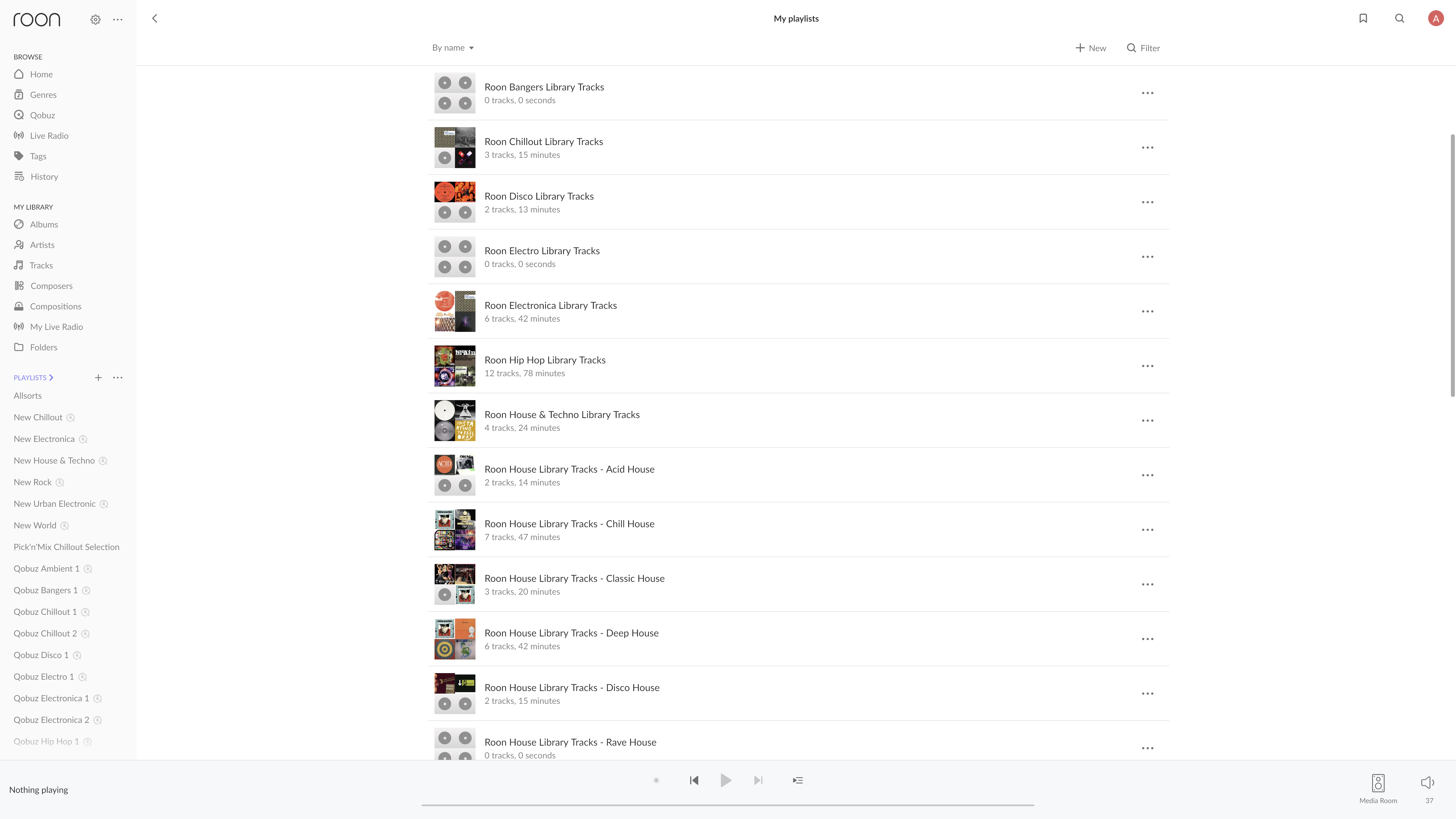

The Roon playlists that were emptied contained tracks from my local library that are not available to stream on Qobuz, and it took me a considerable amount of time to curate these, so I am obviously distraught that they have ended up empty or nearly empty.

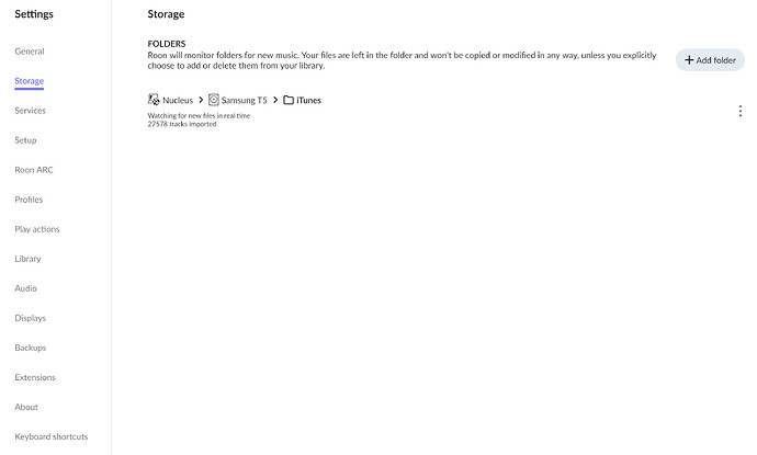

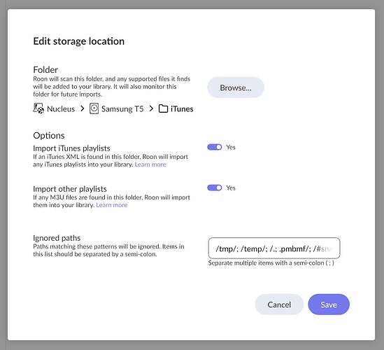

Can you confirm that the storage path under Roon Settings>Storage hasn’t changed or been updated since you made the backup you were restoring from?
Sometimes, even after restoring, you may need to edit/update the storage path within your settings. Are you able to share a screenshot of your Roon Settings>Storage?

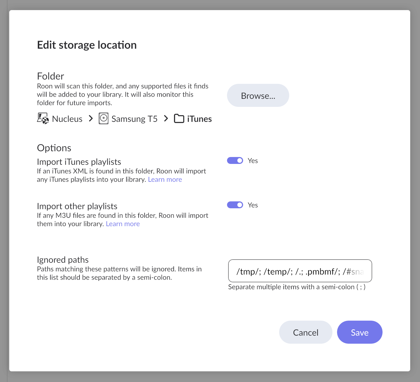

It is the same storage path, as shown in the screenshot below. The only change I made was to add a current iTunes Library XML file to the iTunes music folder in order to be able to access iTunes playlists (which I now can - the iTunes playlists icon appeared in Roon>Playlists after rebooting).

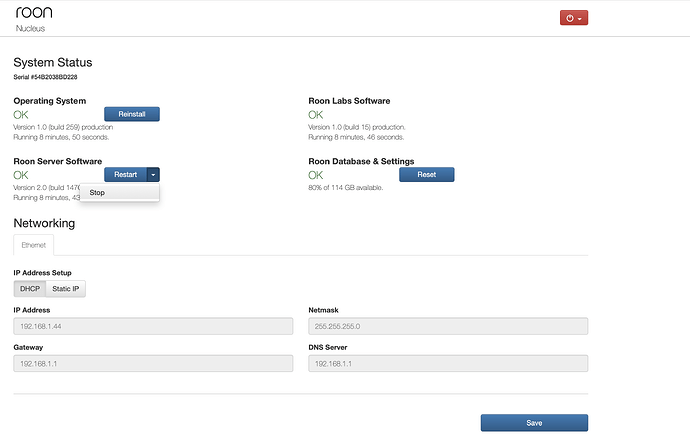

It may be worth stopping Roon Server from running, and then power down both your server machine as well as your router, and then reboot both.
By this, do you mean selecting ‘Stop’ in the Roon OS management page shown below, and then switch off/restart both Nucleus and Router?

Click the three dots next to your storage path > Edit and edit to reflect the updated path
Yes, exactly.

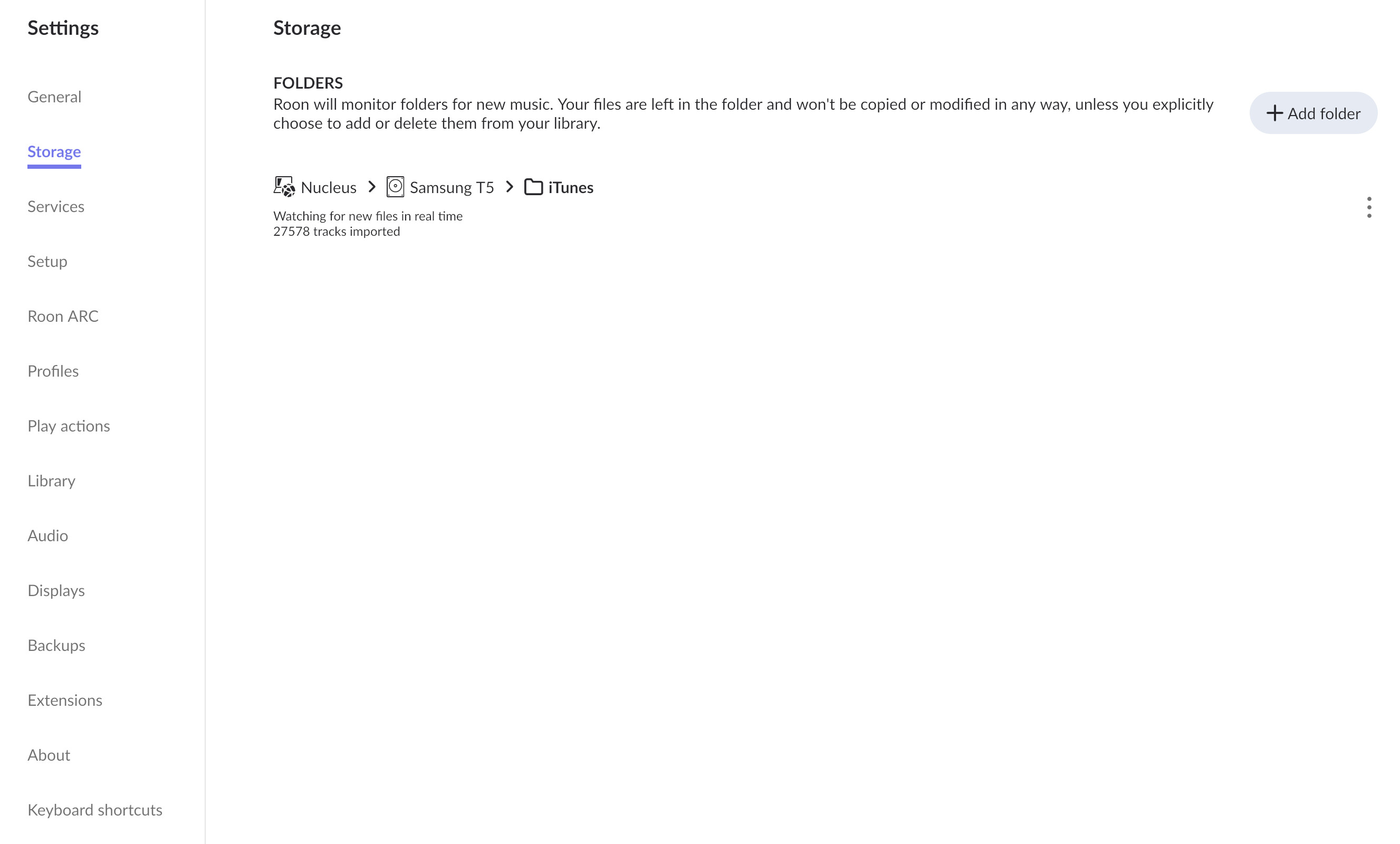

The storage paths are as they always were - Nucleus to two separate Samsung SSD drives. I made this clear in posts 3 and 4 above.

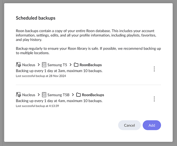

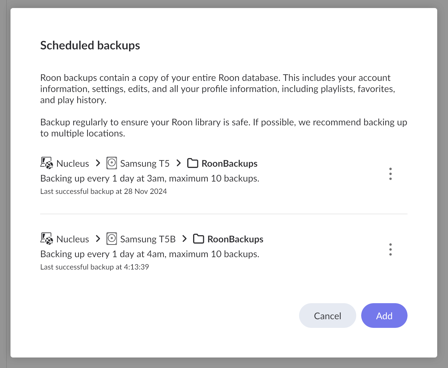

Screenshots of the paths to my backups is shown below, Mac OS is Monterey 12.7.6, all Mac and Roon software is up to date.
You can see in the screenshot that the upper of the two SSD’s (which contains my iTunes library), did not automatically back up this morning at the scheduled time, but the lower one did. Both SSD’s have recently been failing to complete backups when scheduled, despite not missing a beat for years prior to this.
I was obviously concerned about the possibility of the SSD’s failing, and the initial problem occurred when I disconnected the SSD containing my library to run Mac Disk Utility First Aid on it, which diagnosed no problems. On reconnecting this SSD to the Nucleus and then doing a force re-scan (I had updated my iTunes Library XML when I had it connected to the Mac), it seemed to import the whole library again, because it stated on the storage screen that it was ‘importing’ instead of just ‘scanning’.
The outcome is that several playlists I created in Roon seem to have either emptied or nearly emptied, and I have been unable to re-establish these playlists by doing a backup restore, so it would seem to me that a new library has been created which has superseded the old one, and my playlists have been decimated as a result.
I am keen to find out why things went so spectacularly wrong, when as far as I could tell I was following the correct steps. These particular playlists took a long time to curate, and they contained all of the tracks in my collection which are not available on my streaming platform, Qobuz, so it has been very dispiriting to lose them.

Maybe I’m missing something, but you cannot/should not backup to a watched folder (drive). Use one drive as watched folder containing music files. Use another drive for your Roon database backups.
Well, the Nucleus only has two USB ports for connecting the external drives, and I was following their advice below:
We recommend configuring Scheduled Backups to more than one location. For example, backup to your NAS and Dropbox, or to a local hard drive and your NAS.
I was backing up to each of the two SSD’s attached to the Nucleus. One SSD contains the Database Backup folder and the Watched Folder, the other SSD contains only the Database Backup folder.
Roon also says:
We strongly recommend that you do not set the location of Database Backups to be within any Watched Folders because Roon will try to scan that directory and scan the Database Backup itself. This can cause issues, so please keep the locations separate.
My watched folder containing my iTunes library does not have the Database Backup folder within it, so I thought I was OK, as the Database Backup folder is not being scanned by Roon. Is there still some risk in what I am doing?

Put your music in one drive and make that your watched drive. Backup to the other, not a watched drive. Keep them separate. You can also do backups to another computer via your network, etc. Of course, you can install an internal drive for your music files.
