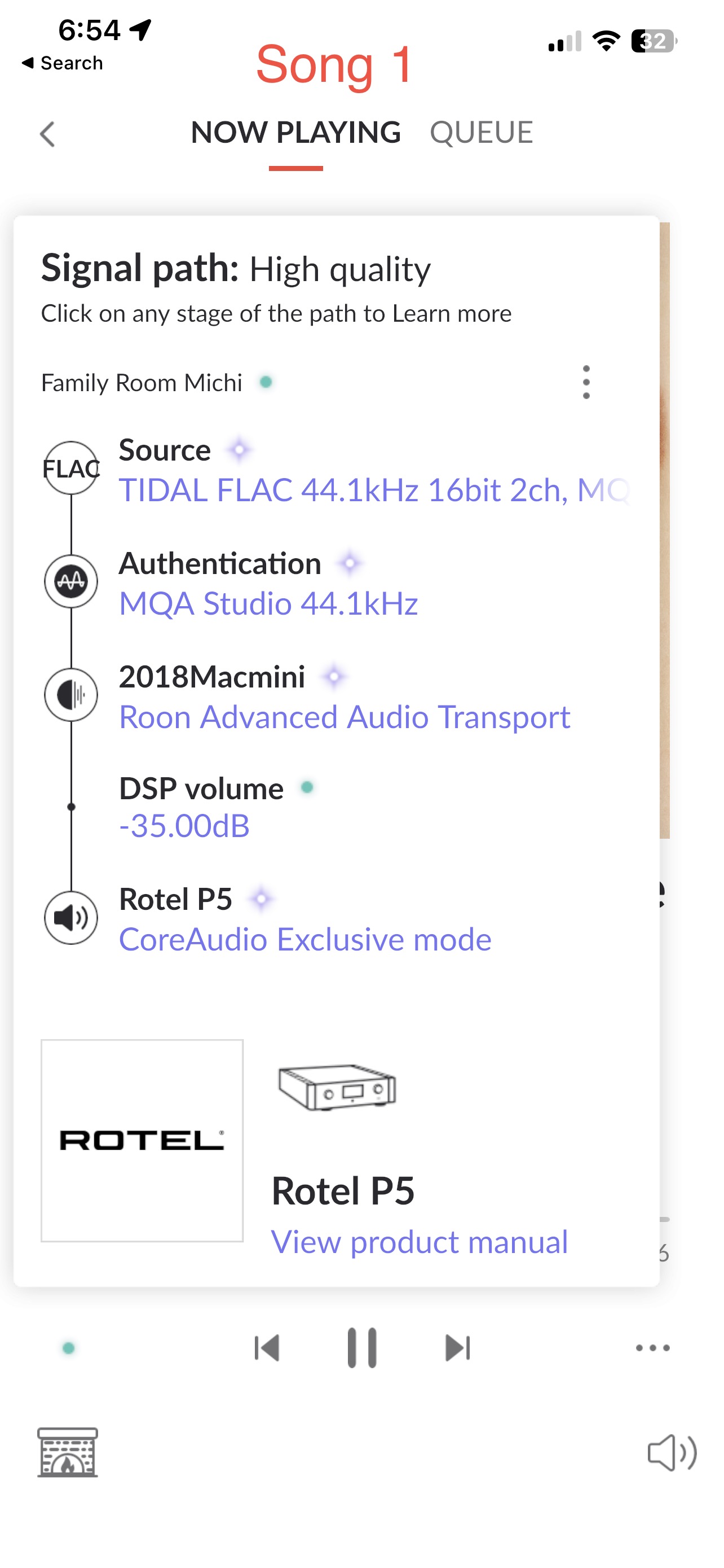

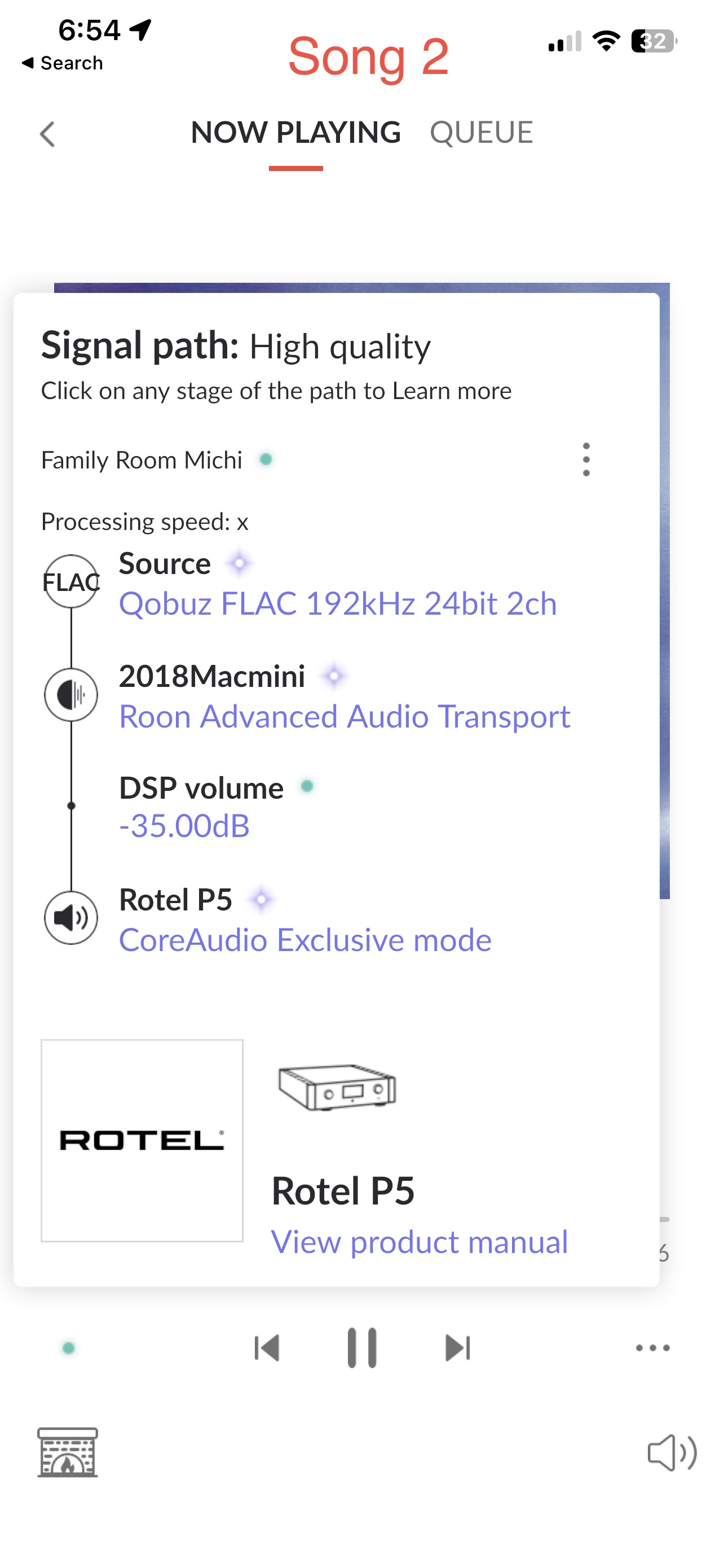

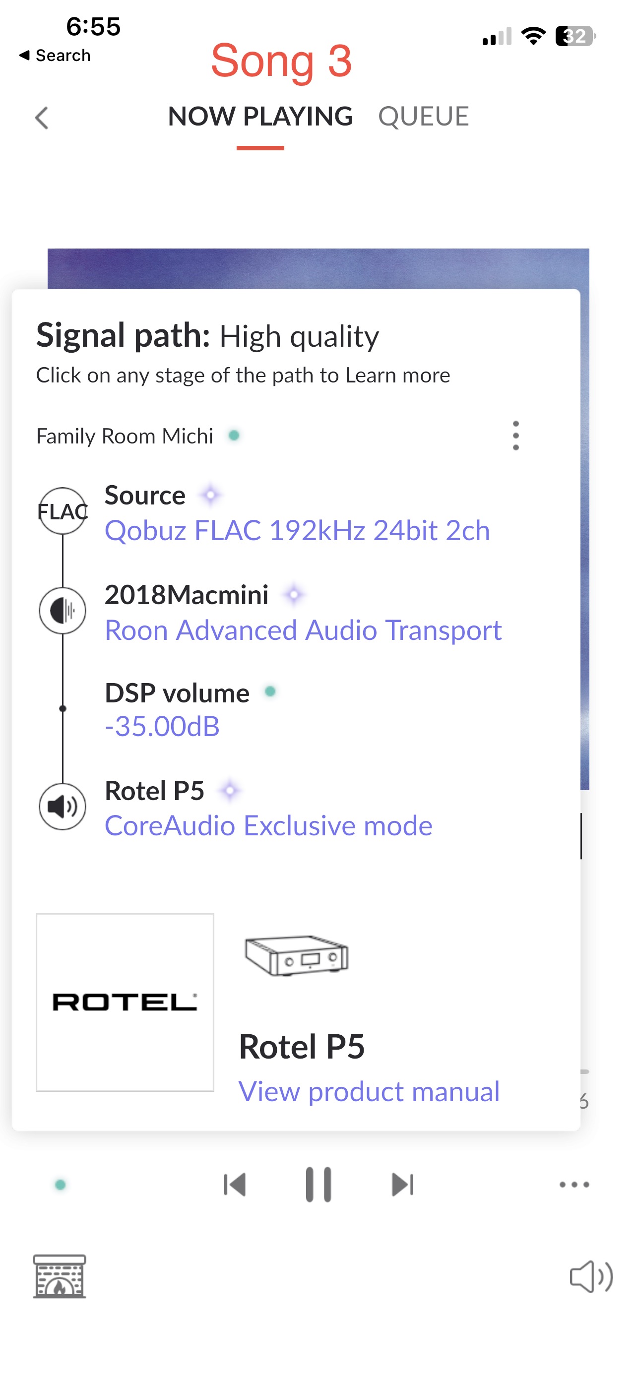

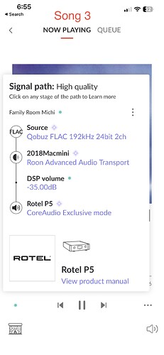

OK… the source format changes always seem to cause a problem… here is a sequence where there was a pop between song 1 and 2, then none between 2 and 3.

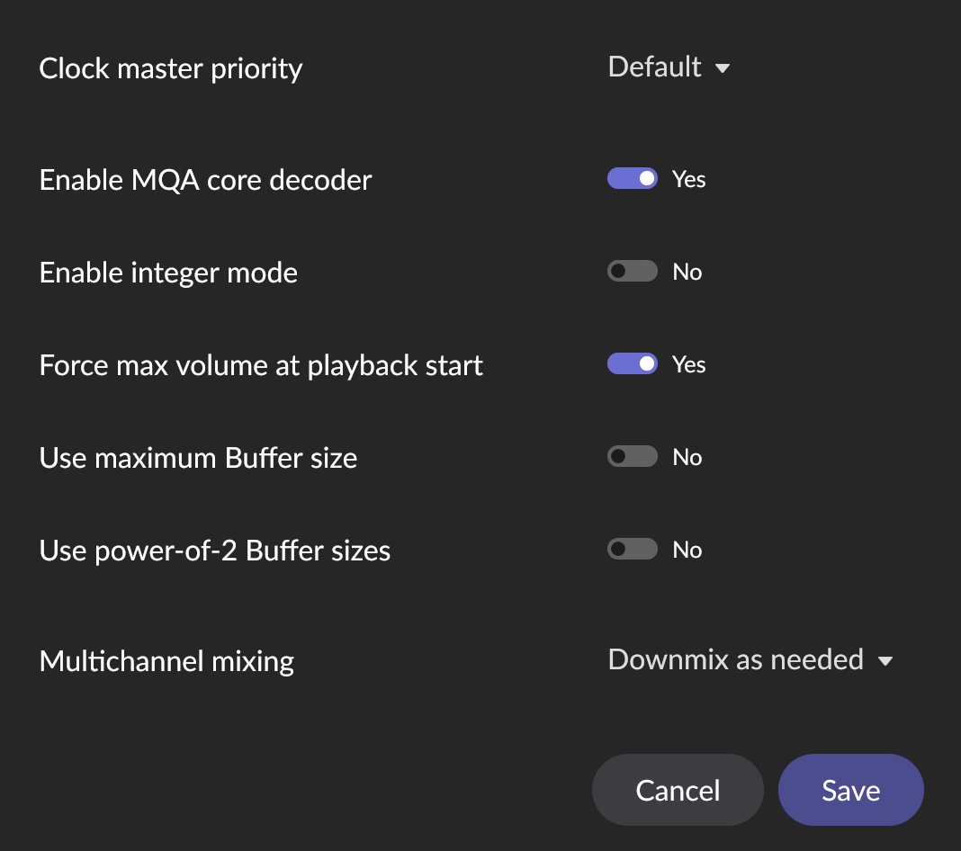

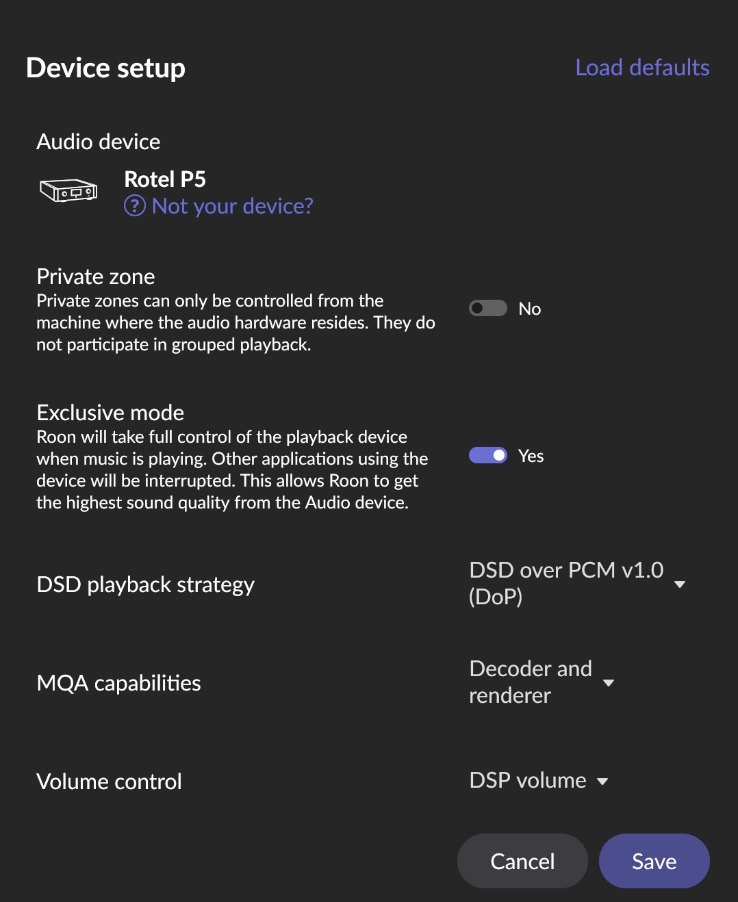

Here are more images… these are device settings for the Michi
This sounds unfortunately like a DAC resolution switching problem, not Roon…
You might need to contact the DAC manufacturer.
Question. Why is this set for dsp volume. Are you not controlling the volume at the integrated and not with the roon controller.

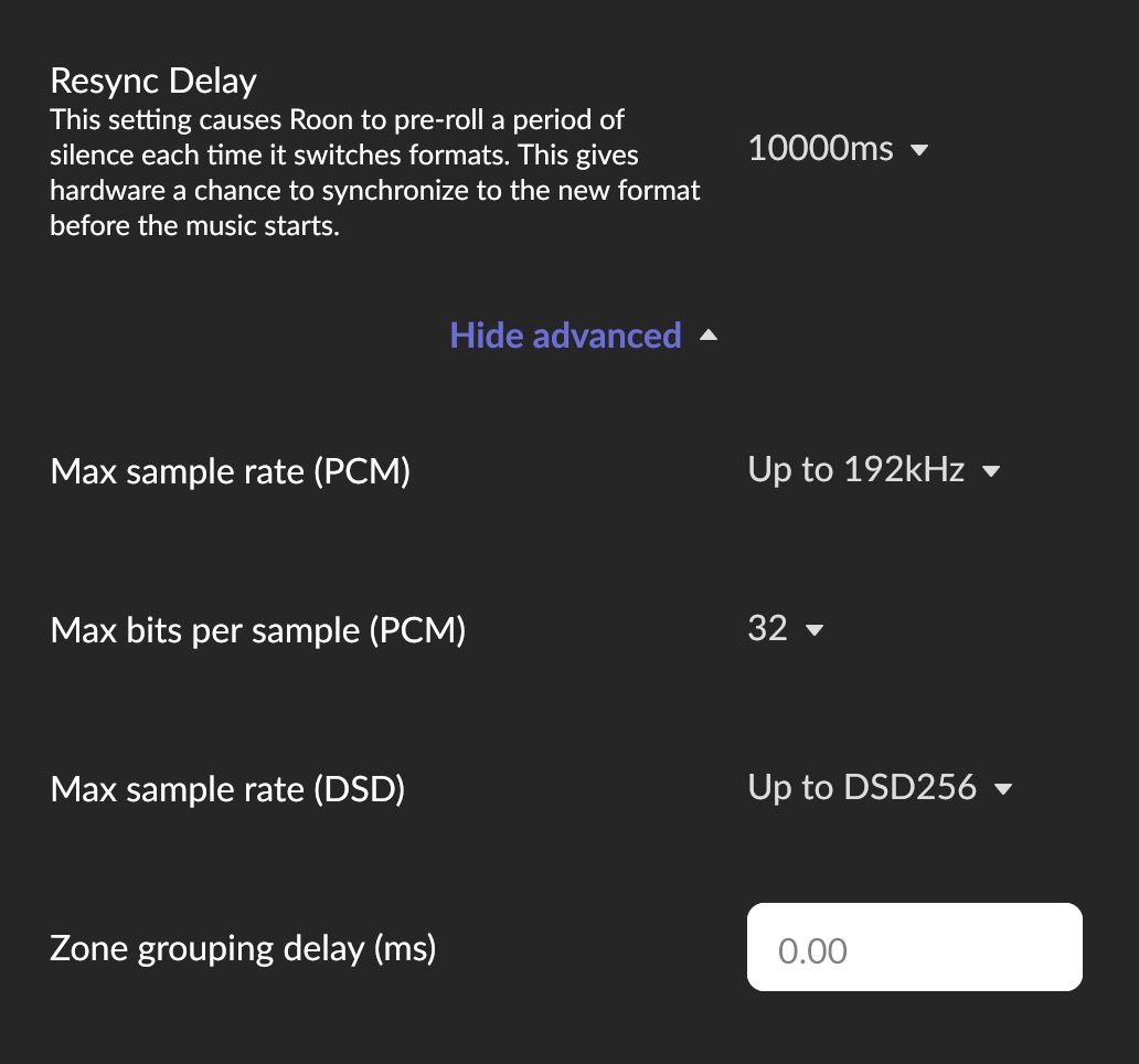

10 seconds Resync Delay, really? Is so much necessary? Maybe the DAC switches the input off and then on again which causes the pops?
I control the michi from a separate room.
I’ve tried every option on the list. There was an email from Roon recently that recognizes this problem and they suggest to increase the resync.
