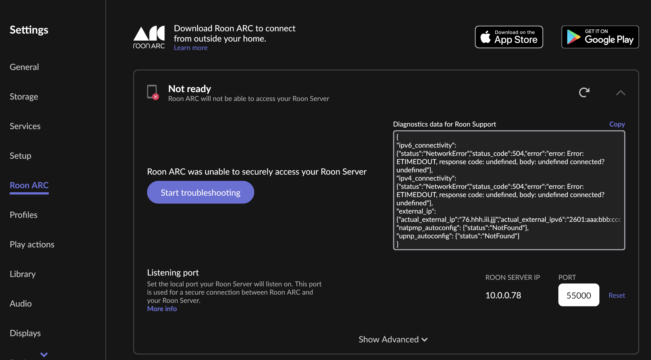

Port Forwarding Issue with Nucleus for Remote Access (ref#8JE3KY)
Mac Mini

Thanks for the reply. I use two routers. One is an Xfinity Gateway that’s plugged directly into the Mac Mini that serves as my Roon Core. The other router is a Linksys Velop mesh router that I use in bridge mode.
I created a manual port forwarding rule on my main (Xfinity) router using 55000, and everything works again. (Yay!)
That said, I’ve been running Arc since it was deployed with no problems. So I wonder why I had a port forwarding issue now (when I did not make any changes to any settings). I have no recollection of ever creating a port forwarding rule in the past.
