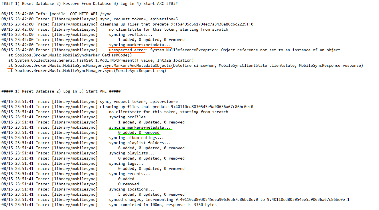

@Early_Access I wanted to bring this to your attention in case this is a regression. This looks/feels very similar to the ARC connection/sync issue that may have been related to genre tags discussed in arc-fails-when-syncing-to-core-update-to-build-1148. If not, I can take this over to regular support if I need additional help.
Logs (image highlighting where I believe the issue is vs success)
Details
I finally gave in :slight_smile: and traded in my Nucleus+ for the Titan. It arrived the day 1448 rolled out, so I upgraded the Nucleus+ to 1448 and I made sure the Titan was on 1448 before I attempted to migrate over. I created a fresh database backup from the Nucleus+ with 1448.
I have a DHCP reservation set for the Titan, and it was the same IP address that the Nucleus+ was using previously. I have a port forwarding rule for ARC using that IP address. Testing ARC from within Roon Remote on the Titan is always successful.
I also moved over an internal hard disk. No issues with that.
When starting with a fresh database on the Titan, if I restore from my 1448 backup first and then login, everything within Roon Remote looks correct. Added / Played albums, history, playlists, etc. are all correct. However, starting with a fresh ARC (cache and storage cleared from android app settings), ARC fails to connect after selecting the Titan and logging in. I get “Something went wrong while syncing to your Roon Server”. I believe this corresponds to the first part of the logs I highlighted with orange.
On the other hand, if I reset the database (either by resetting from the web interface or renaming RoonServer), I can then start a fresh ARC (cache and storage cleared from app settings) and connect to the Titan without any issues.
I can repeatedly go back and forth between these two scenarios and so far, I’ve gotten the same results each time.
Hi, @gsuzor91, thank you for your report. We are investigating it now, will let you know if we need any additional data. Quick question, will it be possible for you to switch to the production track on your Nucleus Titan and see if this issue occurs there?

Thank you for the response, @gsuzor91! We were able to reproduce this issue locally and created a ticket for our dev team.

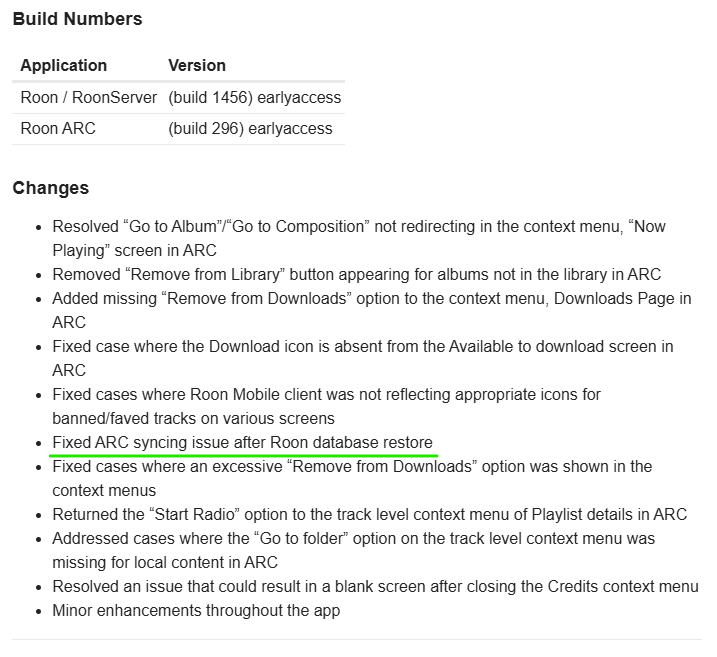

I believe the particular ARC sync issue I was experiencing with ARC 288 early access was resolved back in early access 1456 / 296. I verified this with the latest 1459 / 298 ea release.
Steps Confirming Issue is Resolved
Web Interface
  1. Reset database
  2. Reboot
Roon Remote 1459 (Windows 10)
  1. Select a different Roon Server / Yes
  2. Connect
  3. Restore a backup (hiding at the bottom)
  4. Select the backup from last night from my NAS
  5. Relaunch
  6. Connect
  7. Wait a couple of minutes for the history on home page to load
  8. Reboot
ARC 298
  1. Settings > Disconnect
  2. Connect to my “new” server
  3. Connection / Sync is successful
