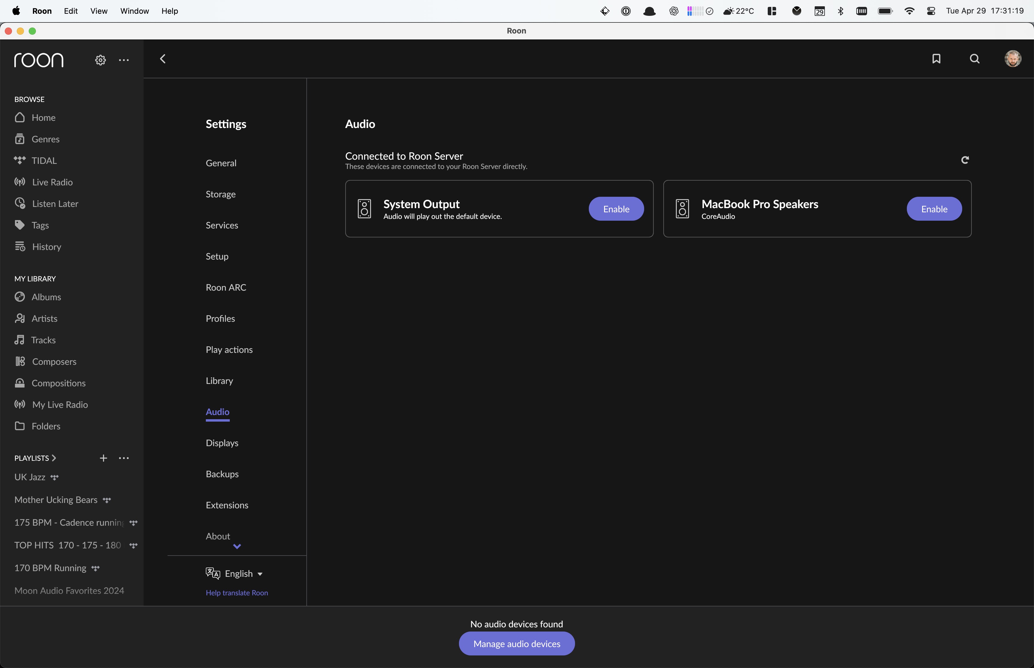

App is glitchy and dropping songs. Now after the update, it does not detect any audio devices other than the server. This problem is also not new.
Tiny flat, Asus router, roon server running on MacBook pro, other macbook pro as the client.

From a recent Roon Server diagnostic report, we do see the following error which stopped playback:
Warn: [zoneplayer/raat] Error during streaming: System.Exception: serverside buffer overrun
We’re seeing the track buffer at 100% before this happens, so the issue doesn’t seem to be between your Mac and upstreaming services like Tidal, but rather, network bandwidth between your Mac running Roon Server and your endpoints within your local setup.
How are they connected? Can you temporarily set up a simple, hard-wired Ethernet connection between them and test?
