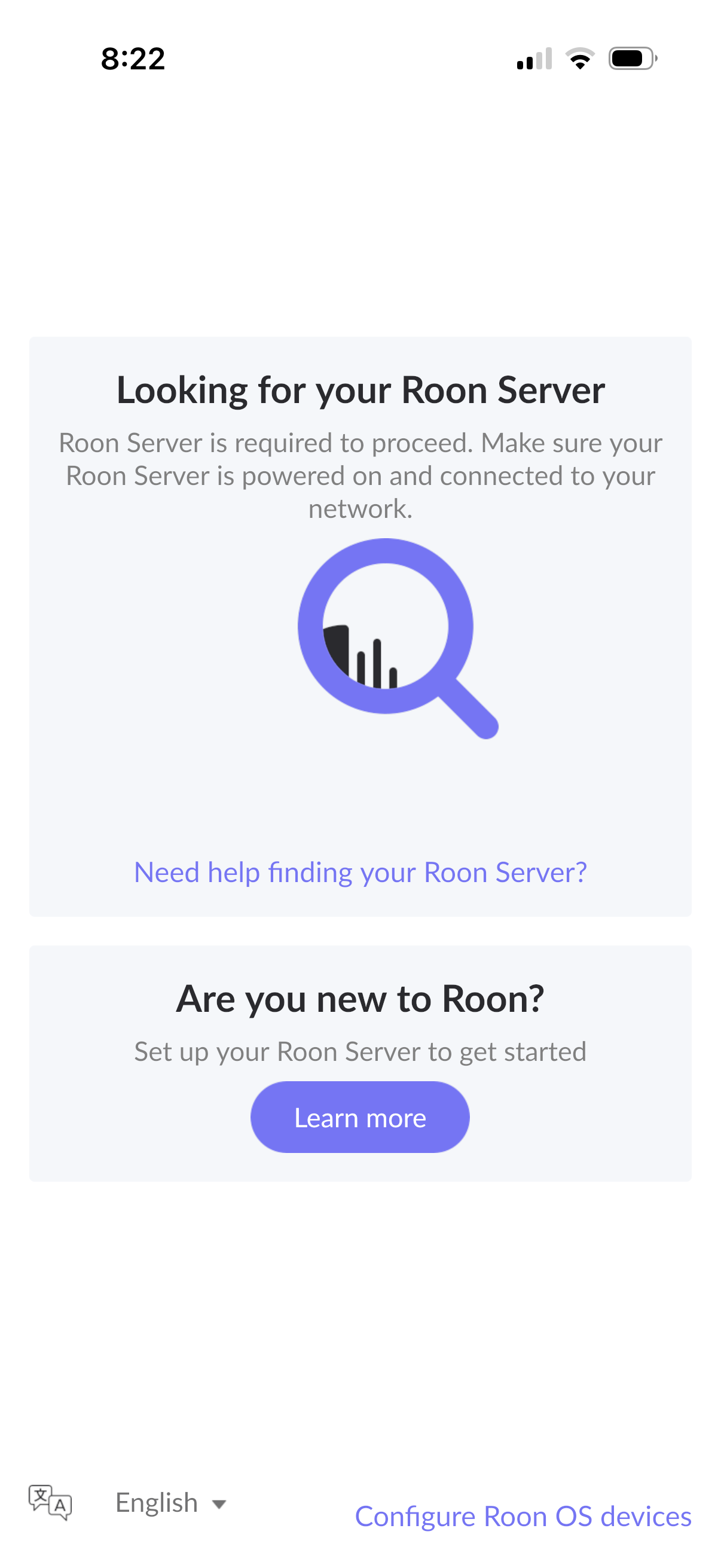

Is Roon Server running?
· "Waiting for your Roon Server"

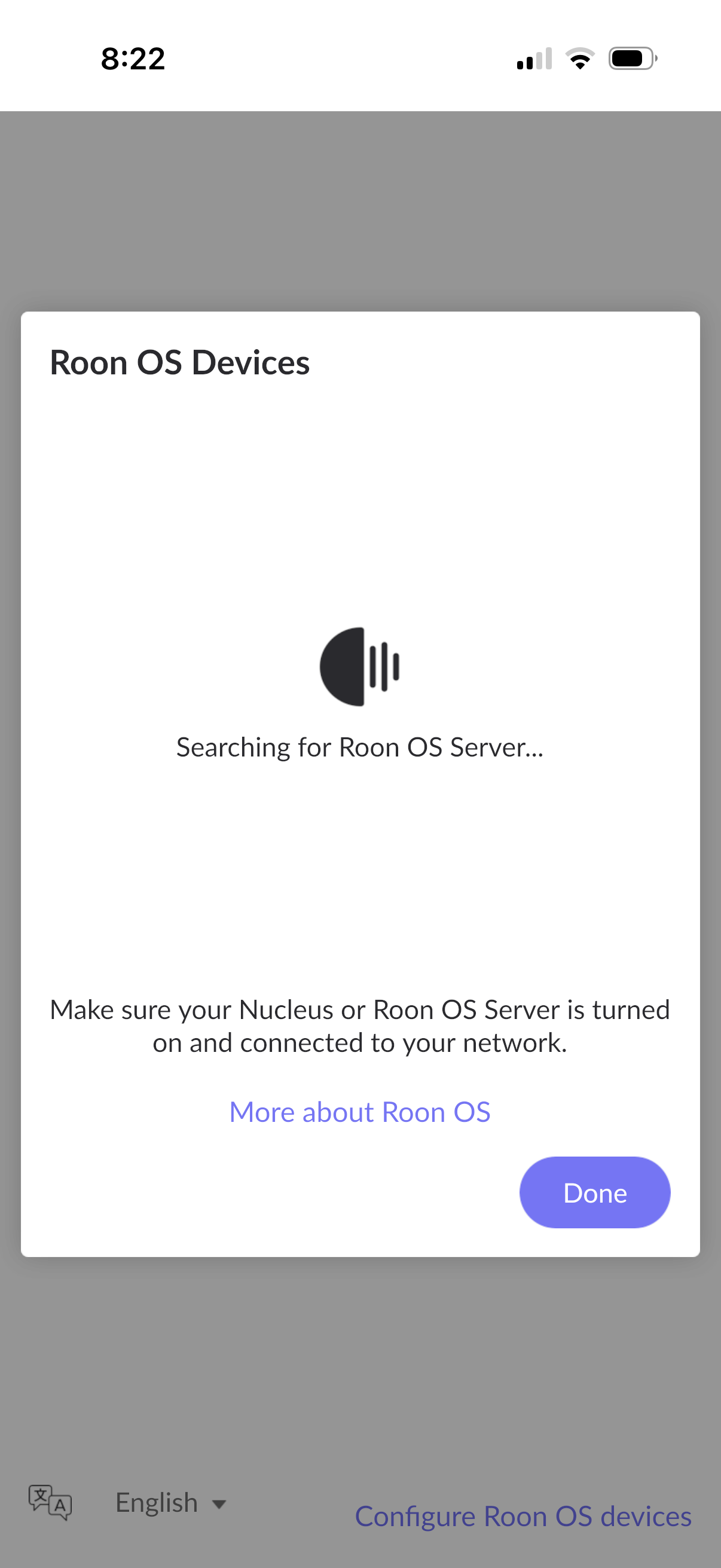

What happens if you press the "Select a different Roon Server" button?
· I don't see Roon Server.

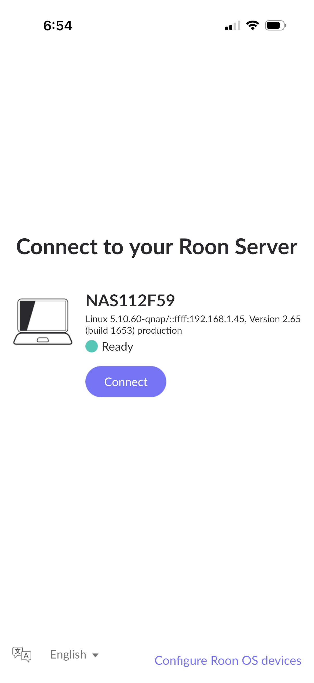

Following the Roon update of 2026_04_27, neither my iPad Pro (M5) nor iPhone 17 Pro would connect to the nucleus on my QNAP TS-463U NAS, to which a Samsung SSD is connected. I couldn’t connect to Roon using my PC even though I hadn’t updated the Roon software there. I rebooted, then power cycled the QNAP; rebooted my UniFi Dream Machine Pro router, USW Pro Max 16 switches; and U7 Pro Max WAP. Except for the iPad and iPhone, everything in the Roon system is hard-wired. The software on all devices is up to date. I can connect to the QNAP NAS from my iPad, iPhone, and PC.

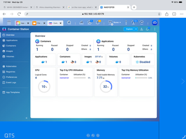

  1. Container Status: Please share a screenshot of your Container Station dashboard showing the status of the Roon container.

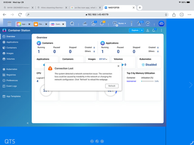

Here is another photo of the Container station.
