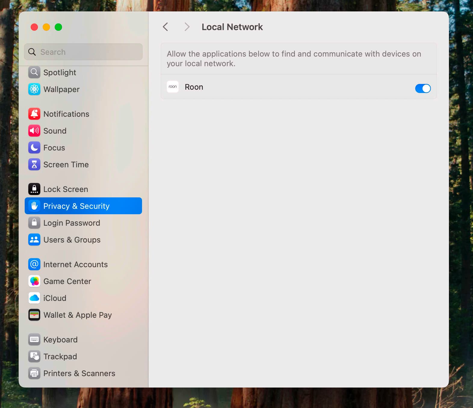

Curiously, only Roon shows up under Sys Settings>Privacy>Local Network. Roon Server is not showing up now (it was before).

Should I be concerned that Roon Server is no longer showing up?

Can you please clarify what you mean by Roon Server is not showing up? Is this only happening on one Roon Remote or multiple? What exactly are you seeing, can you share a screenshot?
I’m referring to System Settings>Privacy & Security>Local Network. Here’s a screenshot.

This IS my Roon Server! Everything seems to be working okay now (music plays fine), but this concerns me.

The good news is that I installed the latest Roon update with only minimum issues: a couple of Server restarts and router restart. The bad news is that Roon Server is still not showing up in Sys Settings>Privacy & Security>Local Network. Otherwise, it seems to be running fine.
Hi @Rob_Welles,
I’m glad the update went well and everything seems to be working except for RoonServer not showing up in Local Network. Like @benjamin said we will need to check in with our developers to see if this is indicative of a problem. Just to make sure are you able to connect remote devices to your RoonServer right now?
