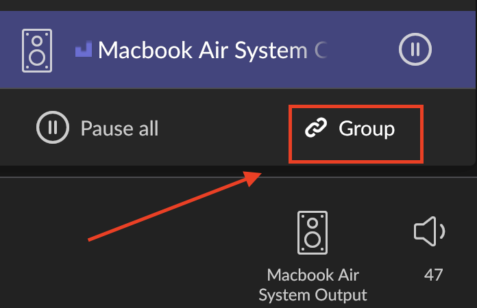

Then : Open Roon > Settings > Audio. Look for a section called “This Mac” or “AirPlay Devices”. If you see your AirPods listed as an AirPlay device, click Enable and give them a name (e.g., “AirPods”).
Selecting playback from a single endpoint will allow you to use it as a single zone, so no additional work is needed there.
To set up a zone with all three Kefs - select one of them, then select the Kef zone icon > ‘Group’. This will allow you to select your other Kefs and create a zone with all three endpoints grouped together:
Be sure to rename the zones so you can clearly distinguish them. Let me know if this helps! :+1:
