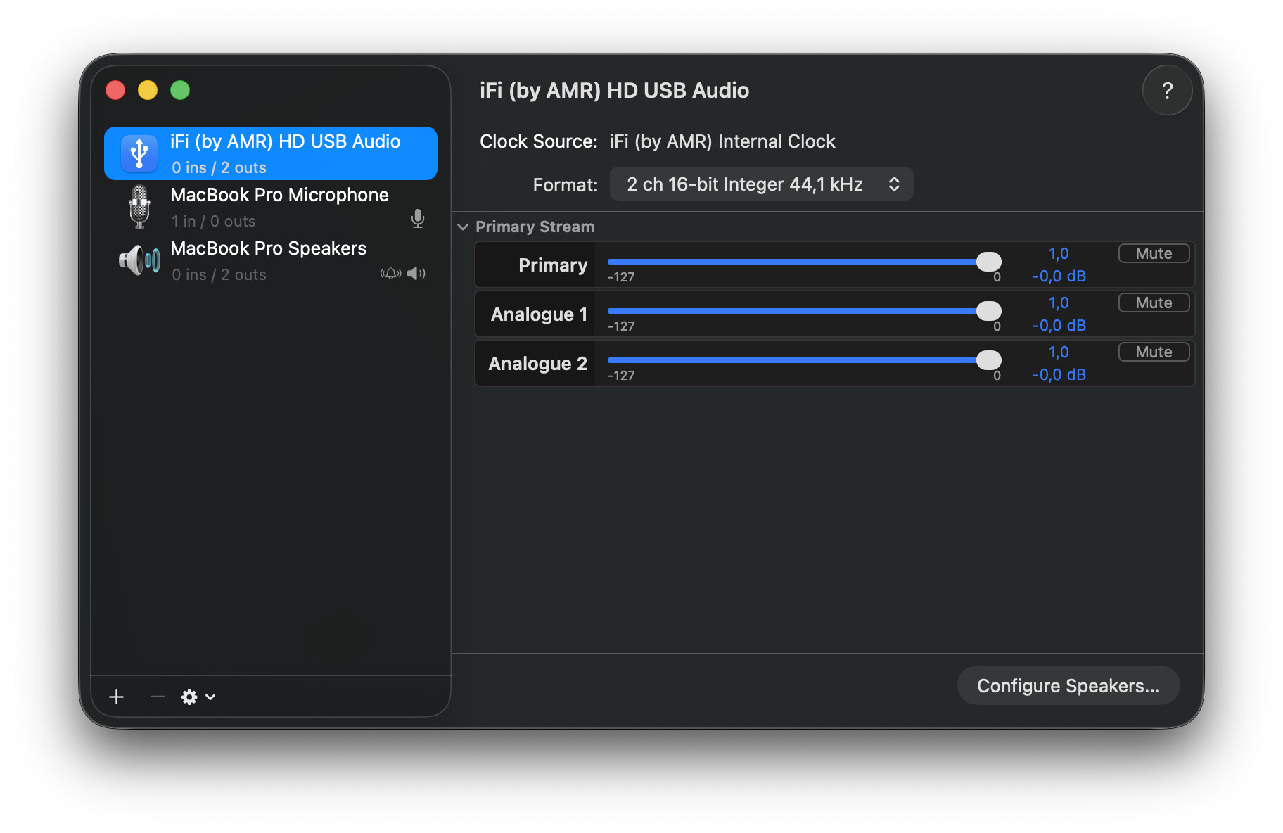

Example how things should be (iFi DAC as HQPlayer output in this case):

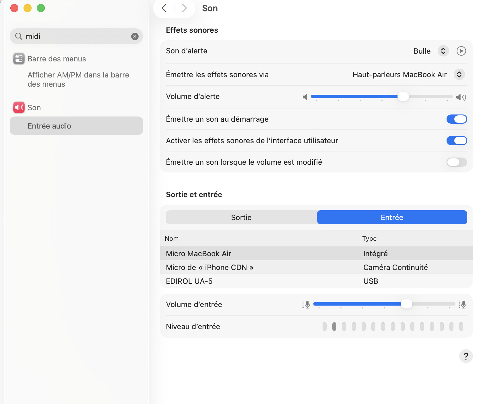

Hi Jussi,
Thanks but… where do you find this on a Mac running Tahoo ? All I get relative to the audio output (with Edirol which is old but same thing with IFI DSD) is that:
And I never use the USB output to DAC simultaneously on default output when I am using HQplayer.
Thanks again if you can help me find a solution.

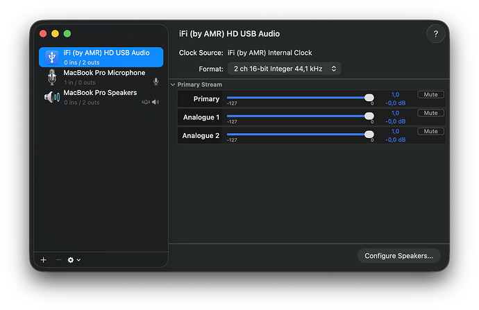

It is the “Audio MIDI Setup” application, part of macOS…

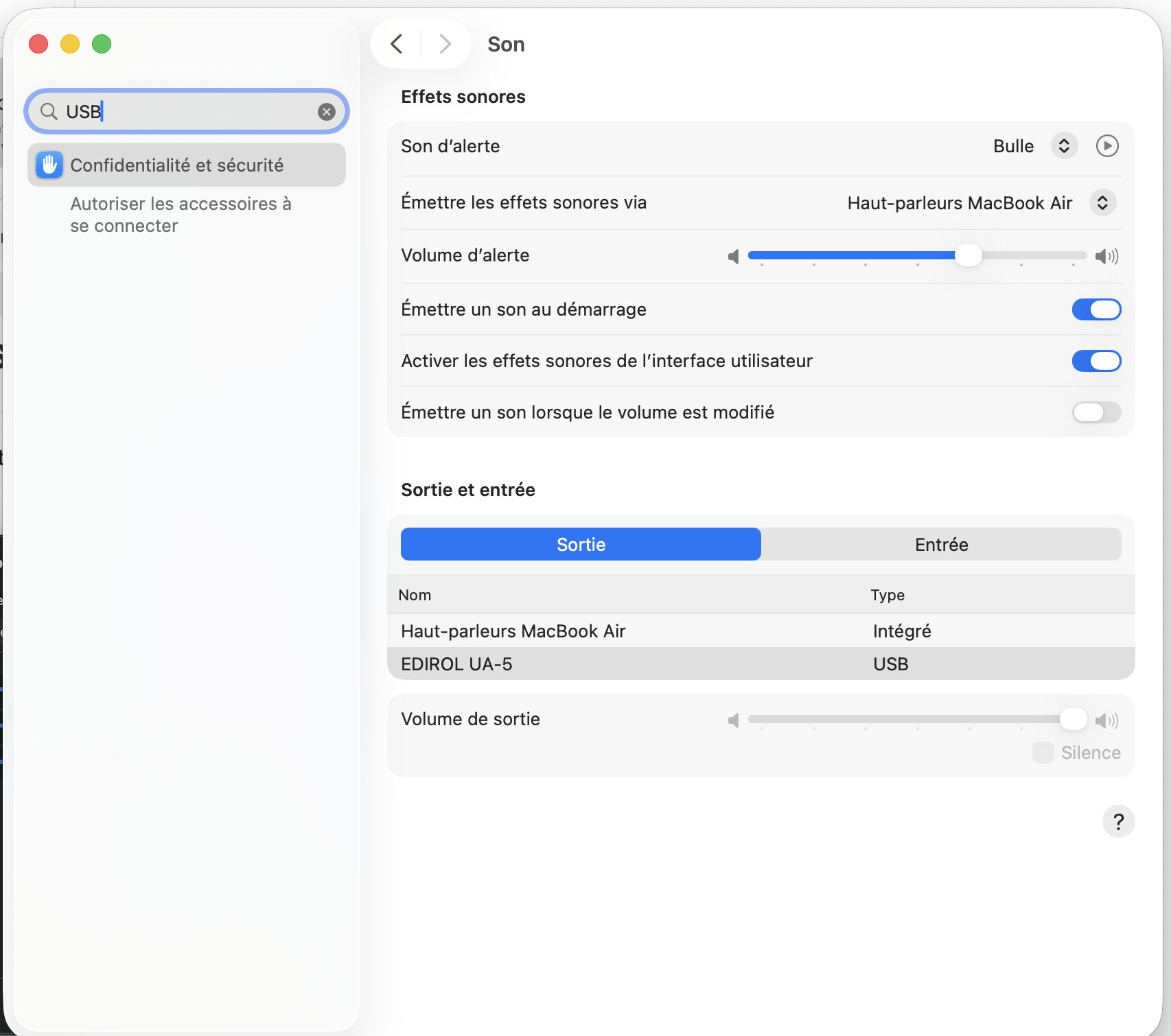

OK but with the EDIROL interface to SPDIF (The Hifi DSD interface is 600 km away for now) what I can see is only this. It looks quite different and with little possibilites to change anything :
Best regards,
Christian
Audio MIDI setup is a separate app in macOS. It is an Apple utility app that, if memory serves me correctly, is located in the/Applications/Utilities folder.
One can just click on the “Apps” icon in macOS launch bar, and type “audio” on the search field and it appears…
