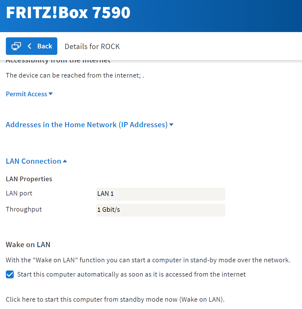

“Start this computer automatically as soon as it is accessed from the internet” is enabled
This is for starting the NUC from outside the LAN, while regular WOL is accessible only on the LAN. I think if this is checked, the Fritzbox sends a WOL signal on the LAN if there is a connection attempt to this device coming from the internet.
Maybe this is caused by a periodic access from the ARC app? Does the behavior stop if you uncheck this?

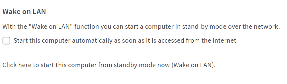

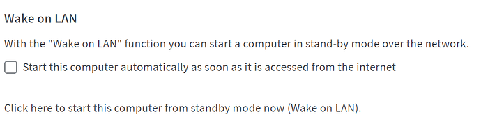

I have disabled it:
Will set what happens :slight_smile:
THX

It did fix the problem. My ROCK/NUC did not turn on by it self last night.
But now I can’t turn my ROCK/NUC when I am not at home :frowning:
Torben
