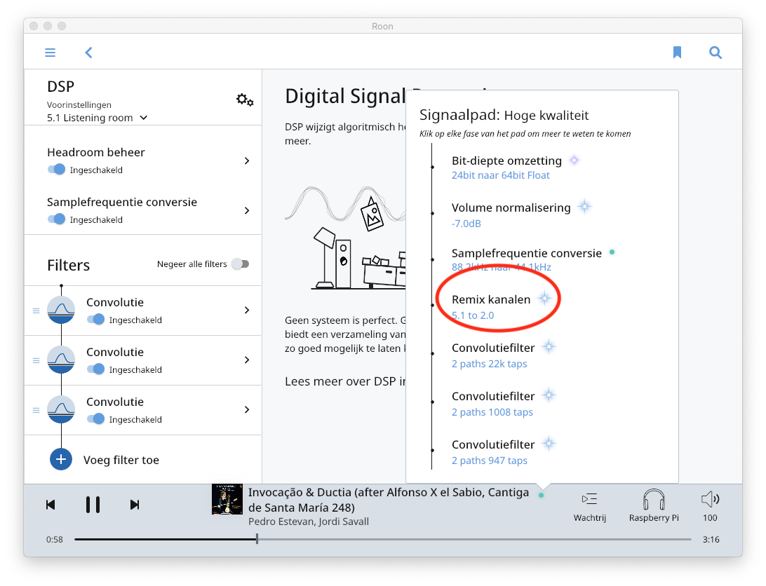

I’m experimenting with https://shanonpearce.github.io/ASH-IR-Dataset/ and wanted to use the filters he provides to downmix 5.1 files to 2.0 for headphone listening. However Roon already downmixes the file before it is fed to the convolution engine. Is there any way to prevent this?
Hi @DeLub,
Can you please share a screenshot of your Device Setup tab for this zone (showing both the general and the advanced section)? You can access Device Setup by going into Roon Settings -> Audio -> Cogwheel next to zone -> Device Setup
Ah… yes. You triggered me. In the advanced section it says (if I translate correctly) “Downmix when necessary” I’ve changed that to “channel mapping only”.
Thanks
