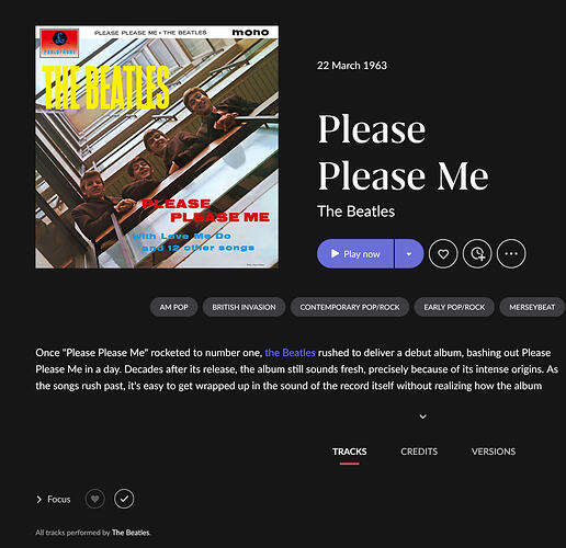

Here’s an example.

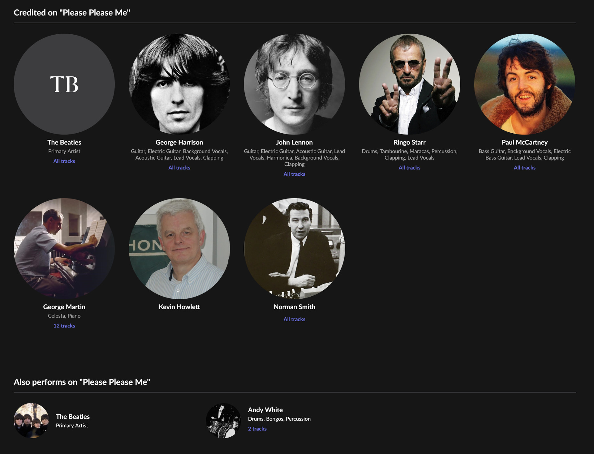

At some point a duplicate The Beatles artist has appeared (no idea where it has come from), and it has replaced the actual The Beatles as primary artist on all their releases.
I’m constantly having to fix this issue by editing credits and removing the incorrect artist, but the fact it’s now happening to one of the most popular artists in history is pretty ridiculous.
What does “replaced” mean? Is the correct artist used at first while the album is already in the library and then replaced later? Or is the wrong artist applied at the point when you add the album to the library?
Primarily when adding a new release I’ll see that the wrong/duplicate has been added.
But in the case of The Beatles this duplicate has been added to already imported releases - I listen to them a lot and it was definitely correct in the past (somebody else spotted it as well - Mixed up "the beatles")

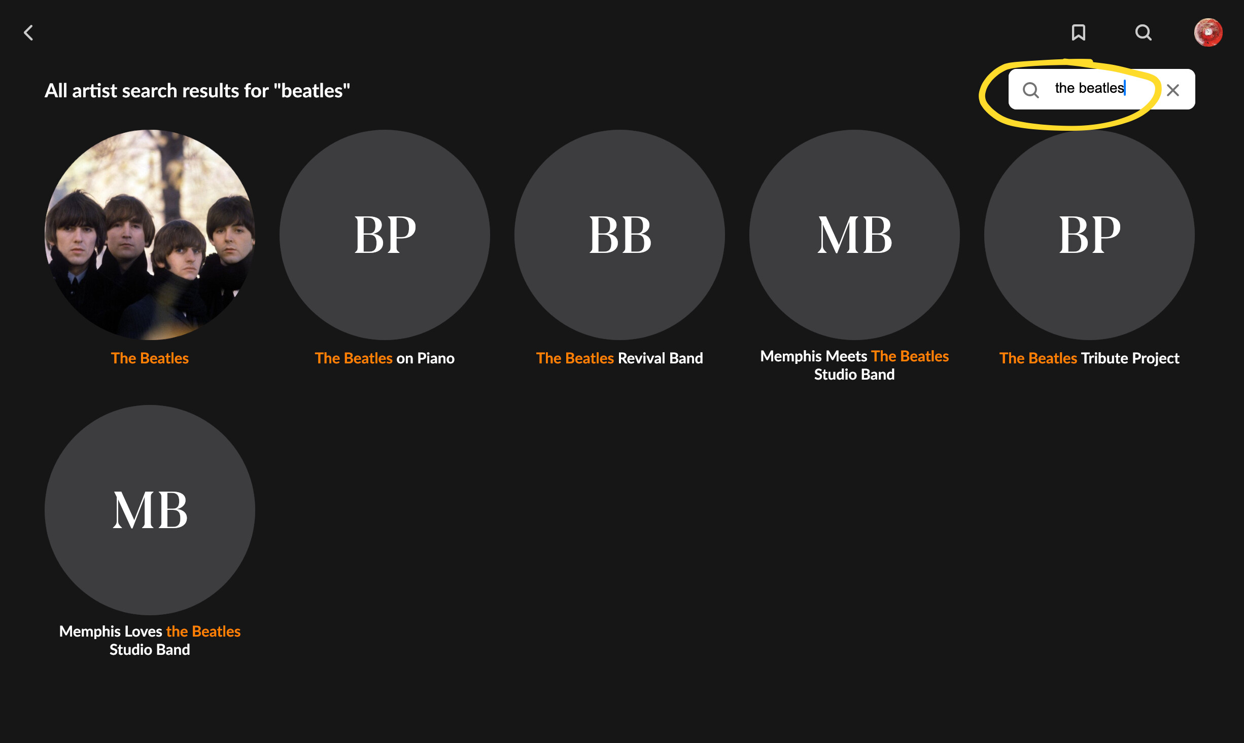

Hmm, I see. This is strange because if I search for Beatles and then filter the resulting artists for The Beatles, I only get one of them:
Perhaps this case from April was fixed. Anyway, I have a bunch of Beatles album and the correct artist was not replaced. Not sure what’s going on there for you, but the case from April has a band photo and formed/disbanded dates, but your example has no photo, so it might not be the same thing.
Obviously there is something wrong, anyway, if such an artist suddenly gets applied to in-library albums without any intervention. Something for support to investigate.
This might be a different issue, not sure. It is known to happen when adding an album to the library and the correct artist is not yet in the library (i.e., there is no album in the library where the correct artist is already added). This usually happens with local files. In this case, a duplicate artist is (sometimes?) created and used.
This duplicate never has any additional information (formed/disbanded dates, bio, image etc. Nothing at all but the name). So it cannot explain the Beatles “formed in Philadelphia” case from April but perhaps yours.
When I search for The Beatles, there is no duplicate found. Therefore, I suspect that this duplicate may have been created for you locally in the past when you performed such an import.

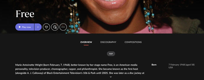

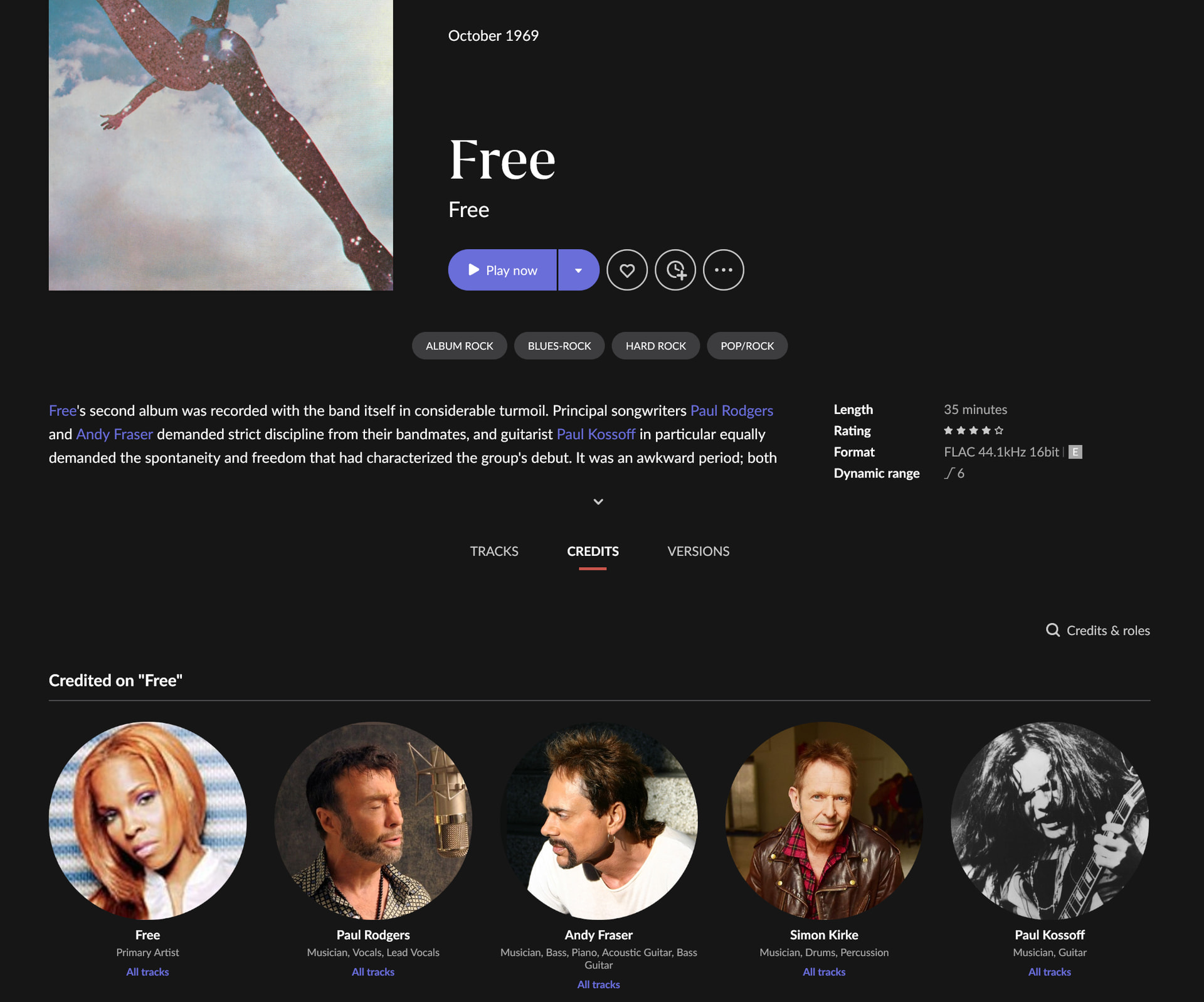

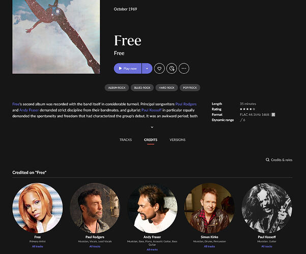

It happens with artists that already exist in the library. Today I added an album by the UK band Free (I already have other albums by them), and it has a different Free as the primary artist. It is an actual person/artist, not an empty duplicate

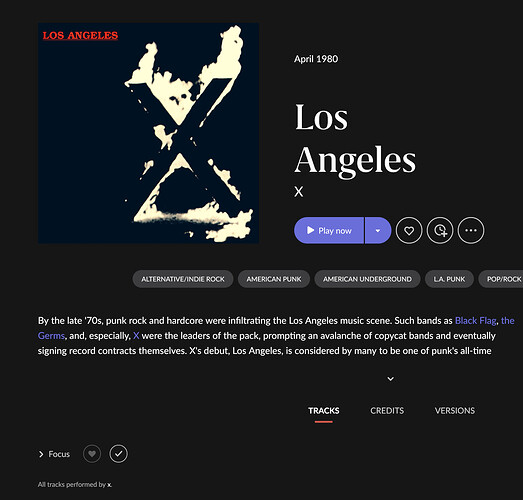

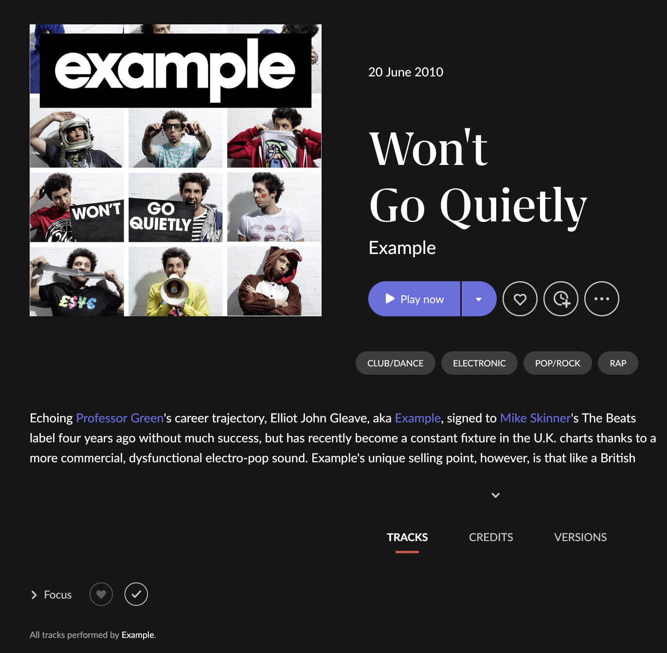

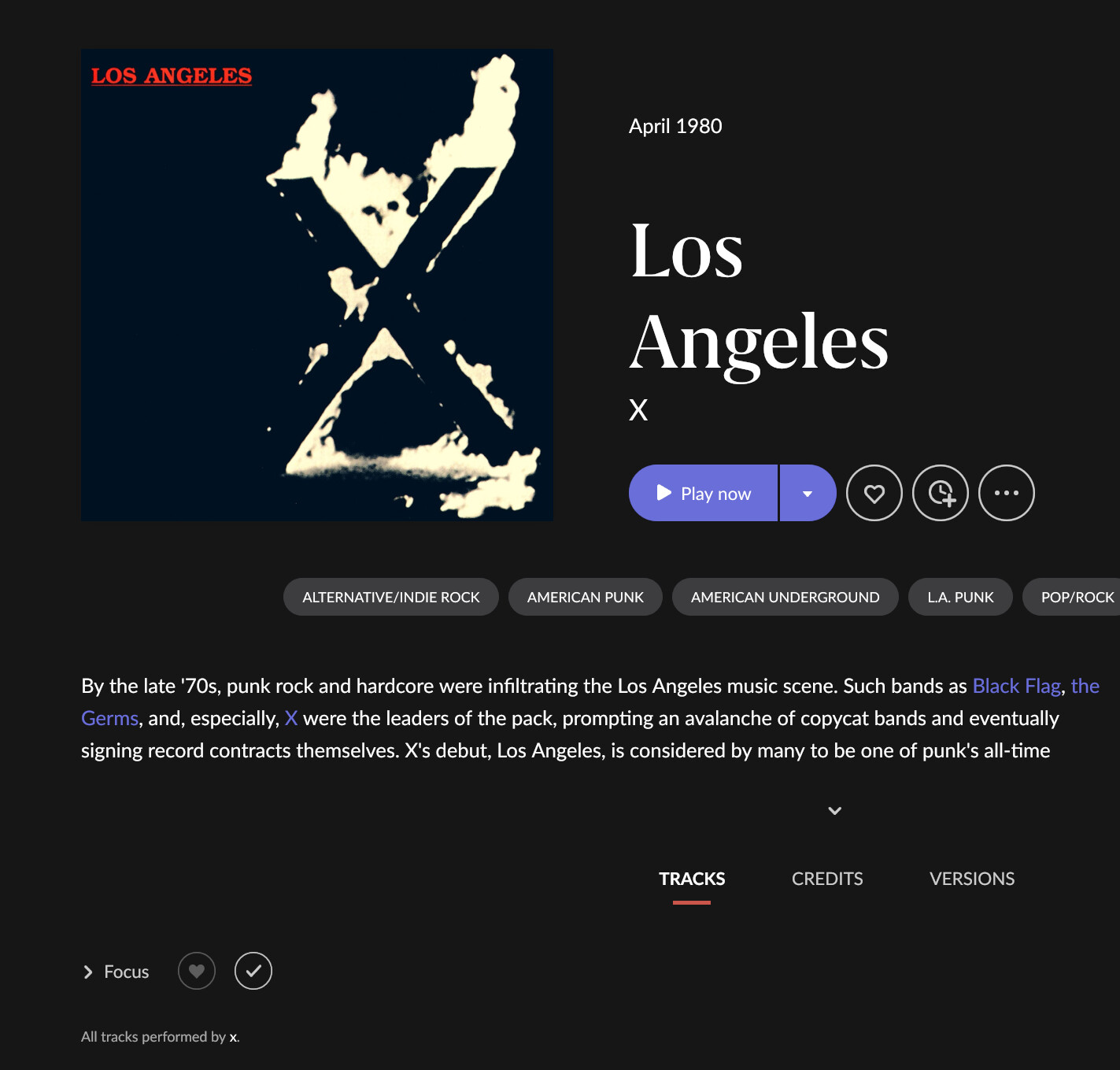

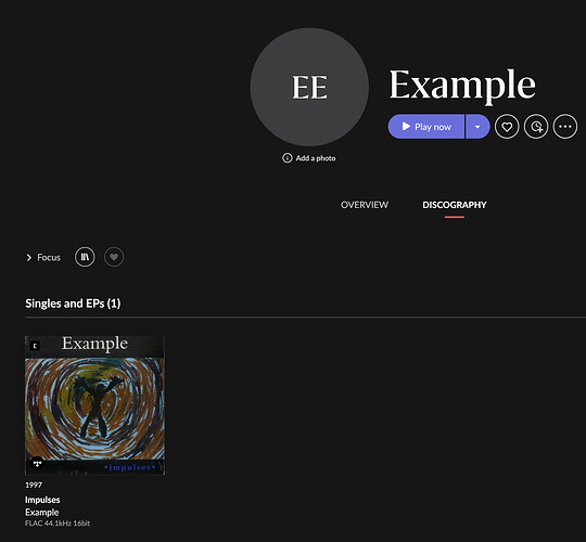

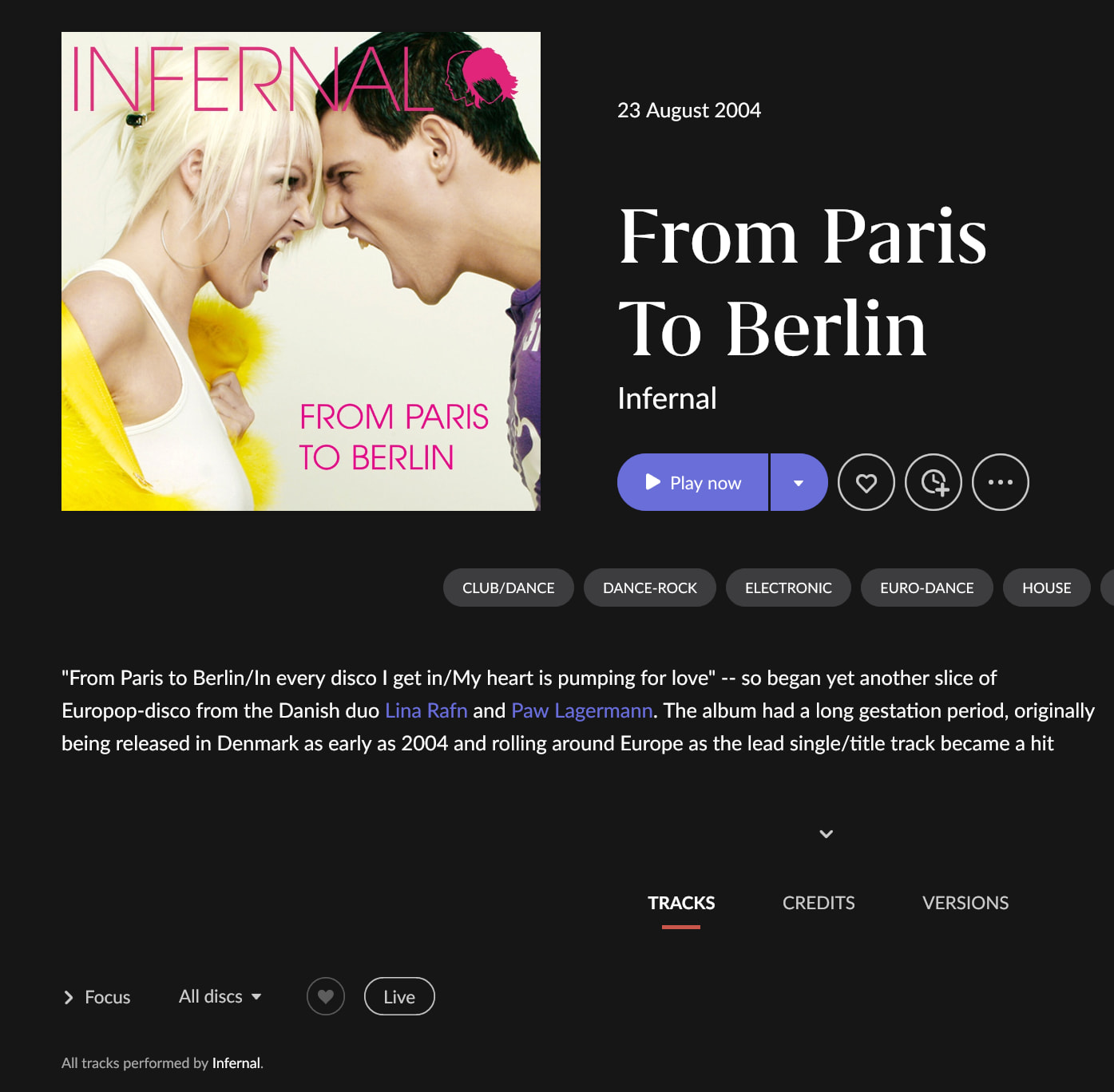

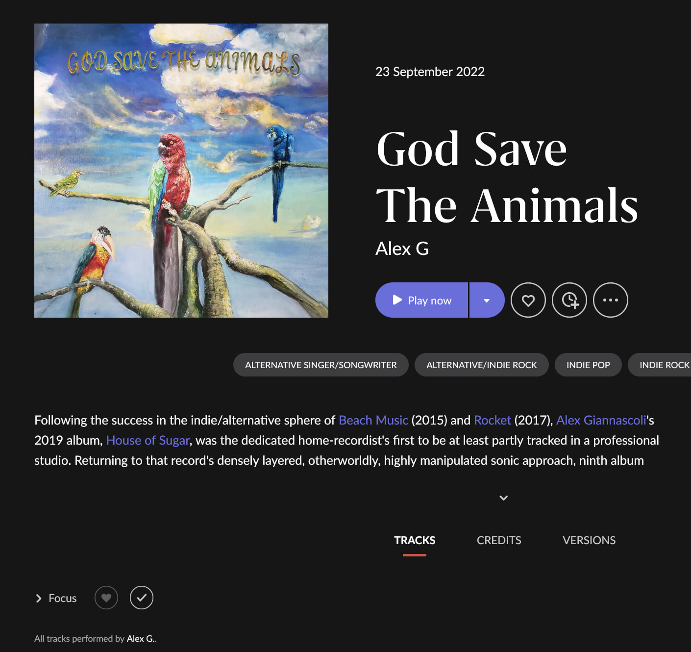

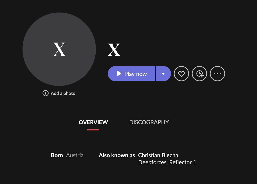

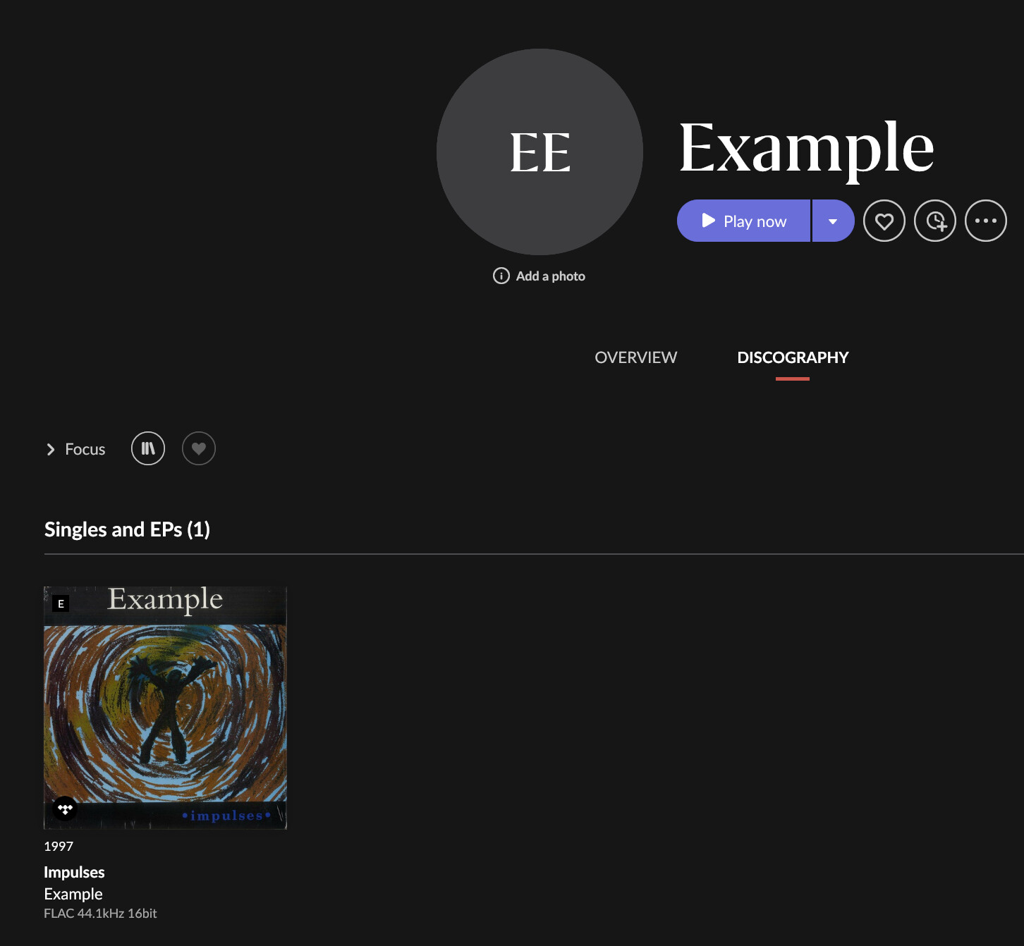

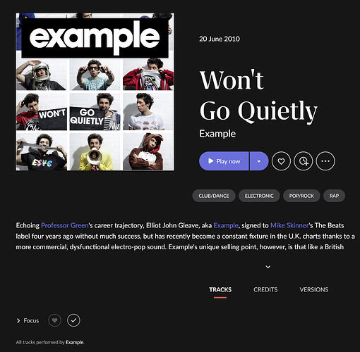

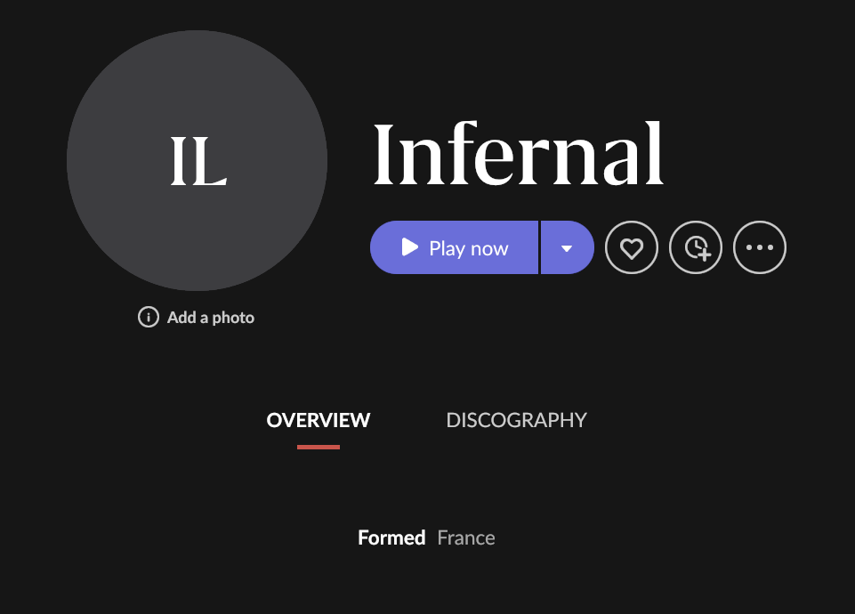

Some more examples of primary artist replacement, leading to the stupid “All tracks performed by”
The punk band X
The British singer Example

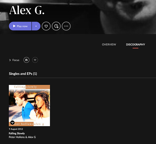

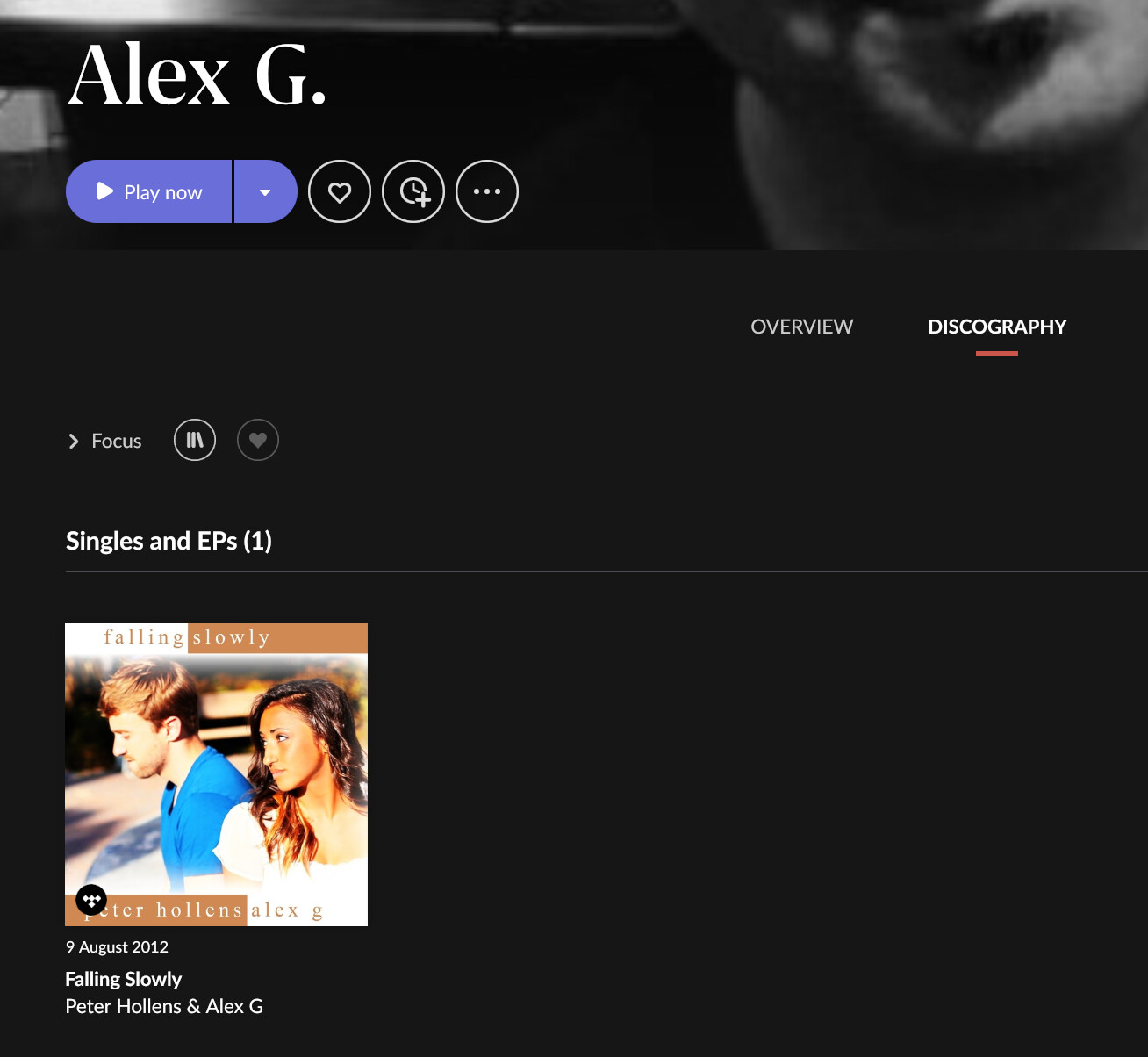

The American singer Alex G
The Danish dance act Infernal
Hello @Henry_Buckle
Thank you for the extra examples and screenshots. To find out why the wrong same-name artist is being applied, we need to look at your library database. Your examples (The Beatles, Free, X, Example, Alex G, and Infernal) will be our starting point, so there is nothing else you need to prepare.
