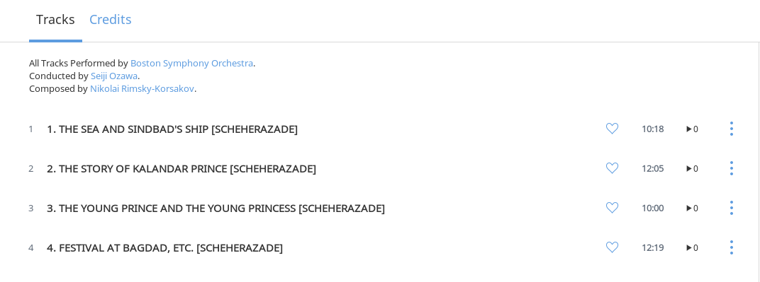

When an album is not identified, what’s the priority for determining a “work”.
Example:
This is how the tags look like
This transfers to Roon like that:
Why does Roon not consider the WORK tag in this case? It seems to look at the NAME tag first.
When I copy the content of the WORK tag to NAME and re-scan the album in Roon I get the following:
Why does that not work from the beginning?
