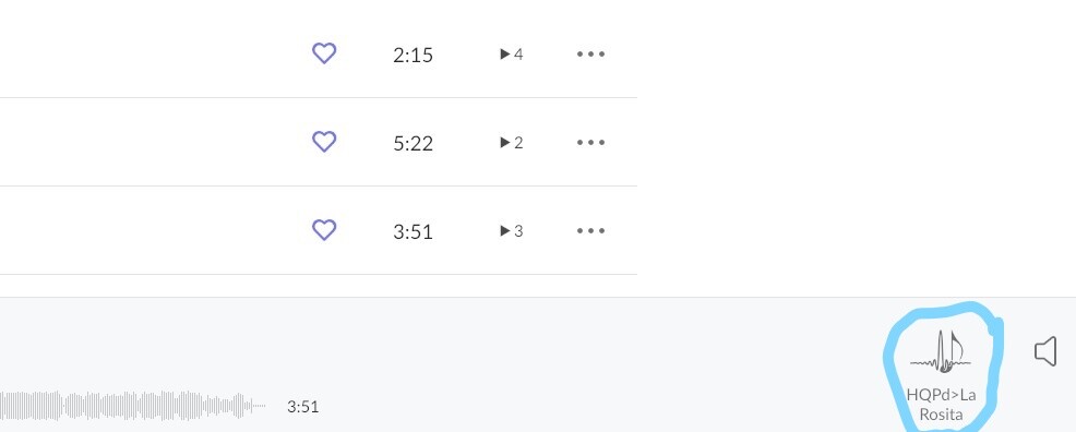

In Roon I see on my display Zone HQPlayer symbol but I named it also HQPd-La Rosita an addition by myself:
So if I will listen to the naa: Loxjie it will be the zone HQPd-La Rosita. Maybe I should change the naming of that zone. And when I want to know to what I’m listening at I have to look in the Config of HQPlayer what I did chose in the Network Audio Backend.
Correct, if you have only one HQPlayer “server” in your house, just leave the name of that zone in Roon as the original “HQPlayer” name. As I wrote about, you never need to change anything in Roon after that.
