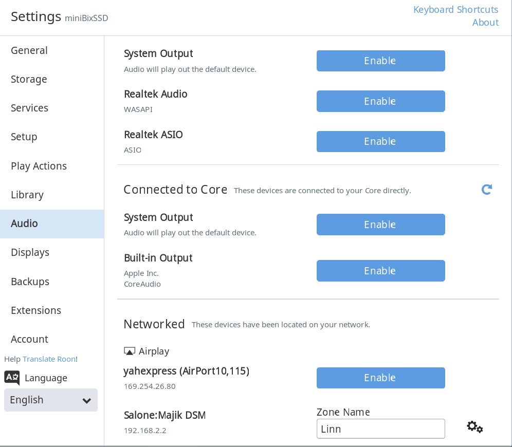

Hi @noris.
These are the requested screenshots: hope it may help to solve problem.
Audio Devices
Signal Path while streaming a flac files (hosted on a local QNAP device):
Signal Path while streaming a TIDAL MQA file:
In both situation you see a green spot. When it was working there was a bright purple light.
Furthermore, when a try to change the volume moving the slider from 0 to 100 nothing happens. The only way to change the volume is to use the Linn remote control. I think this is also a “strange” behaviour, isn’t it?
Thank you very much,
L.

Hi @Lorenzo_De_Santis,
Thank you for sharing those screenshots, I do notice now why the signal path is green. This is because you are using Airplay streaming and the maximum sample rate for Airplay on your device is 44.1kHz while you were previously using RAAT Streaming before.
There should be a field in the Networked section that says “Roon Ready”, but I am not seeing it in your screenshot. Is it perhaps located lower in the list (if you scroll down)? I would also try rebooting your Linn and making sure that you have the proper Linn Subnet selected in Roon Settings -> Setup:
– Noris
Hi @noris.
Now it works, but actually I do not understand very well this issue… Probably the Linn reboot was the right move.
In any case, I rebooted the roon server and the Linn Majik. After the reboot, in Roon Settings->Audio now I see another section
You can see in my previous post that the Linn was recognized only under the Airplay section.
Now the streaming of a Tidal MQA file works correctly and I can see a bright purple spot:
Now also the volume slider works perfectly…
Very strange, but anyhow thank you very much for your support.
L.
