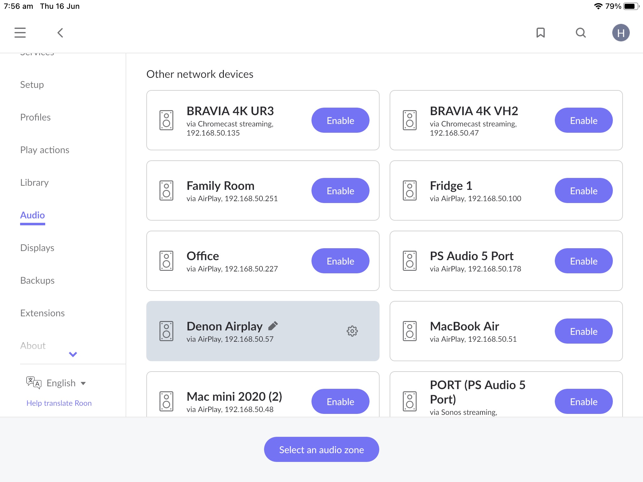

Will try to attach a capture.
![image|666x500]
(upload://kp8UVoG8fymEgGItFatPO5ti1vJ.jpeg)

Interesting we have another category of Fully Roon Tested. Thanks for the info though. It does explain my situation.
Shame that it was not in the literature as I would of know this when I bought it and maybe wouldn’t have been under false impressions. I’m not a mad fan of Airplay due to its limitations.

Hey @Hifi_Hobbyist,
Thank you for getting in touch, and welcome to Community! We’re happy to have you but sorry to see that it was an issue that prompted your first post. We’d be happy to help figure this out!
The Denon X3700H hasn’t cleared Roon Tested certification yet, that’s why you’re not seeing it in the Roon Tested section of your Audio devices page. You’ll need to connect to that device via Airplay for now. Thanks!
